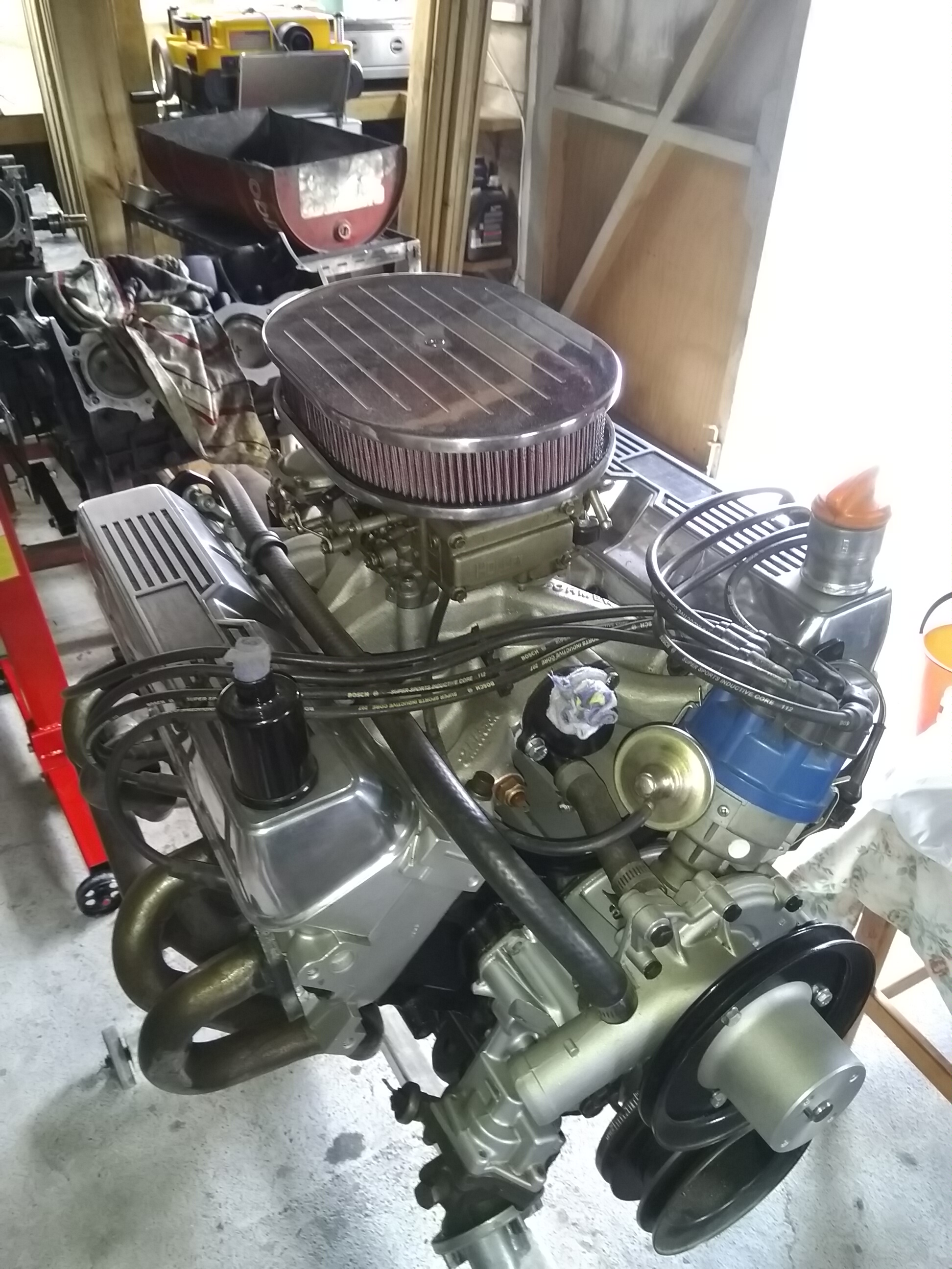

Yeah , I like power bulges . Location is a shame , I could have offered you a edelbrock performer manifold and holley 390 vac sec , I have had them on an engine for years and it has never been run so as brand new

That engine looks very neat, what sort of specifications etc?
Presume 3.5 and it looks like a P6 front end!

Its an early rope seal block, 3.5 , converted to lip seal , shot peined and polished rods, 10.5:1 comp (fly cut pistons )hyd fast road cam , vernier double row camchain/sprockets , efi valves ,bronze guides , head and main stud kits , rod bolts ( arp )tall rotor kit and mg spring in oil pump and the whole lot ( inc clutch and flywheel )ballanced. The fast road cam is a bit over the top with .510" lift, hence the bronze guides ,it just squeeks past the coil bind test but the lift is a bit pointless needs to be reduced a bit and I never did make up my mind how to do this , either a new cam or get this (billet) cam reground. Its been around since 1997 . I have since got an serp 3.9 and plan to sell this 3.5 motor but I dont want to pass on any issues re the cam so I gotta do something . I have an efi set up so I figured if I have the carb & manifold off might sell that and put the efi on to sell motor . There is a w57 toyota 5 speed and dellow bell housing too.
