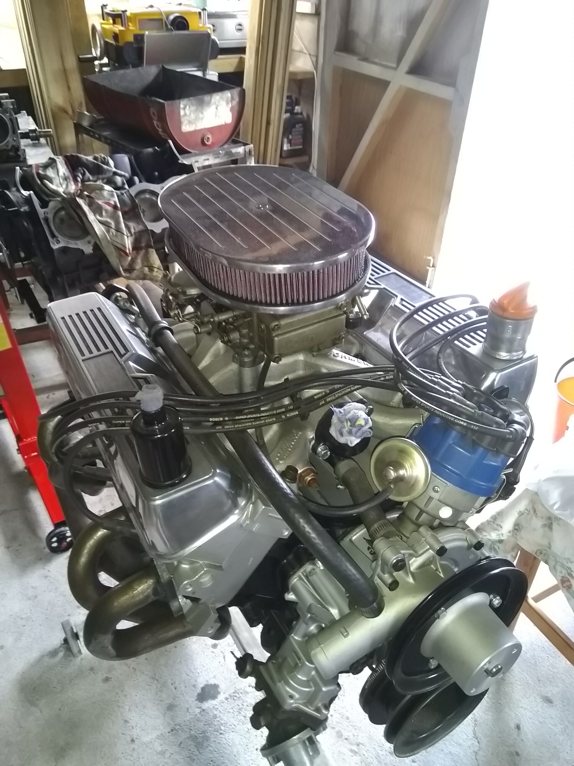

McTool
That engine looks very neat, what sort of specifications etc?
Presume 3.5 and it looks like a P6 front end!
Mc Tool
- Helpful or Confused
- Posts: 124
Re: 48 IDF
Its an early rope seal block, 3.5 , converted to lip seal , shot peined and polished rods, 10.5:1 comp (fly cut pistons )hyd fast road cam , vernier double row camchain/sprockets , efi valves ,bronze guides , head and main stud kits , rod bolts ( arp )tall rotor kit and mg spring in oil pump and the whole lot ( inc clutch and flywheel )ballanced. The fast road cam is a bit over the top with .510" lift, hence the bronze guides ,it just squeeks past the coil bind test but the lift is a bit pointless needs to be reduced a bit and I never did make up my mind how to do this , either a new cam or get this (billet) cam reground. Its been around since 1997 . I have since got an serp 3.9 and plan to sell this 3.5 motor but I dont want to pass on any issues re the cam so I gotta do something . I have an efi set up so I figured if I have the carb & manifold off might sell that and put the efi on to sell motor . There is a w57 toyota 5 speed and dellow bell housing too.
