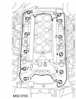

There is a 'sequenced, multi-stage' torquing process for the LR composite valley gasket. Give me a minute and I'll see if I can upload a picture from the manual.

Post by russell_ram »
1. Clean sealant from cylinder head and from notches in the cylinder block.
2. Clean mating faces of cylinder block, cylinder head and manifold.
3. Ensure bolt holes are clean and dry.
4. Apply sealant, Part No. STC 50550 to notches in cylinder block.
5. Fit new gasket end seals, ensuring the ends engage correctly in notches.
6. Apply sealant, Part No. STC 50550 to gasket seals above the notches in the cylinder block.
7. Fit new manifold gasket, dry.
8. Position gasket clamps, fit and lightly tighten bolts.
9. Position inlet manifold assembly to cylinder head.
10. Fit manifold bolts and, working in the sequence illustrated, tighten as follows:
- Initially, tighten bolts numbered 1, 4, 9 and 12 in numerical order to 5 Nm (4 lbf.ft).
- Inlet manifold bolts - initial tighten = 10 Nm (8 lbf.ft).
- Inlet manifold bolts - final tighten = 51 Nm (38 lbf.ft).
- Tighten inlet manifold gasket clamp bolts to 18 Nm (14 lbf.ft).
- Tighten inlet manifold bolts to 51 Nm (38 lbf.ft)
Russ
