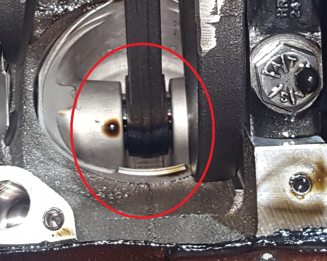

Is this normal on a 4.6 Rover v8?
All my rods have bluing at the little end. I assume this is either to allow the wrist (gudgeon) pin to be pressed in or my con rods are all toast?

I think most old Rovers were an interference fit pin ? So often the rod would be heated to allow pin fitment.
If they're all the same, that's a good sign. If some are very different from others..perhaps not so good.

stevieturbo wrote: Tue Jul 13, 2021 9:12 am I think most old Rovers were an interference fit pin ? So often the rod would be heated to allow pin fitment.
They all look the same. I'll go with it being an assembly thing!
Cheers.

Yes it is an assembly thing . The pins are indeed an interference fit . The small end of the rod is put in an induction heater untill dull red hot and the pin and piston is aligned and the pin quickly pushed in and the assembly is left to cool. They are fanarklinly tight , my 5 ton press wouldnt move them cold , usually wind up damaging pistons getting them off , cant really heat the small end with the pistons on so its brute force ......

They're not heated until a dull red, just until they go blue. Then you put them into place and push the gudgeon pin in. You do need to get it in the right place really quick as the conrod will 'grab' the pin within a couple of seconds.
