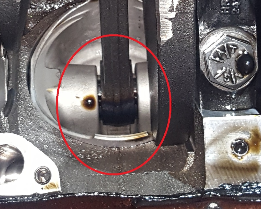

Post by rich112 »
Is this normal on a 4.6 Rover v8?
All my rods have bluing at the little end. I assume this is either to allow the wrist (gudgeon) pin to be pressed in or my con rods are all toast?

I think most old Rovers were an interference fit pin ? So often the rod would be heated to allow pin fitment.
If they're all the same, that's a good sign. If some are very different from others..perhaps not so good.

stevieturbo wrote: Tue Jul 13, 2021 10:12 am I think most old Rovers were an interference fit pin ? So often the rod would be heated to allow pin fitment.
They all look the same. I'll go with it being an assembly thing!

Yes it is an assembly thing . The pins are indeed an interference fit . The small end of the rod is put in an induction heater untill dull red hot and the pin and piston is aligned and the pin quickly pushed in and the assembly is left to cool. They are fanarklinly tight , my 5 ton press wouldnt move them cold , usually wind up damaging pistons getting them off , cant really heat the small end with the pistons on so its brute force ......

They're not heated until a dull red, just until they go blue. Then you put them into place and push the gudgeon pin in. You do need to get it in the right place really quick as the conrod will 'grab' the pin within a couple of seconds.

Sorry Garry, but I have to disagree. I have just fitted the pistons back onto the conrods on my 4.0L engine and the interference fit is the little end to the gudgeon pin. I made up a small rig to hold the piston and fitted the gudgeon pin with a little oil to check they slid in smoothly and turned in the piston.
As the pin needs to be able to float from side to side in the piston, I made up a 'stop' to ensure that pushing it in fully would leave in exactly the right place when the little end cooled. Then I pulled it out to leave a gap in the piston for the conrod, then heated the little end until it turned blue. Very quickly placed the conrod into the piston and pushed the pin fully home, then left it for a couple of seconds. Then applied a couple of drops of oil onto the pin and made sure the pin floated cleanly in the piston.
I also checked the distance of the pin from the outside of the piston when pulled to one side, and then compared it with the other side when pulled over there.

My 4.6 also has interference fit in the small end. The gudgeons are floating in the piston.

The Rover V8 pin is semi-floating like most OEM engines and is an interference fit with the connecting rod.
