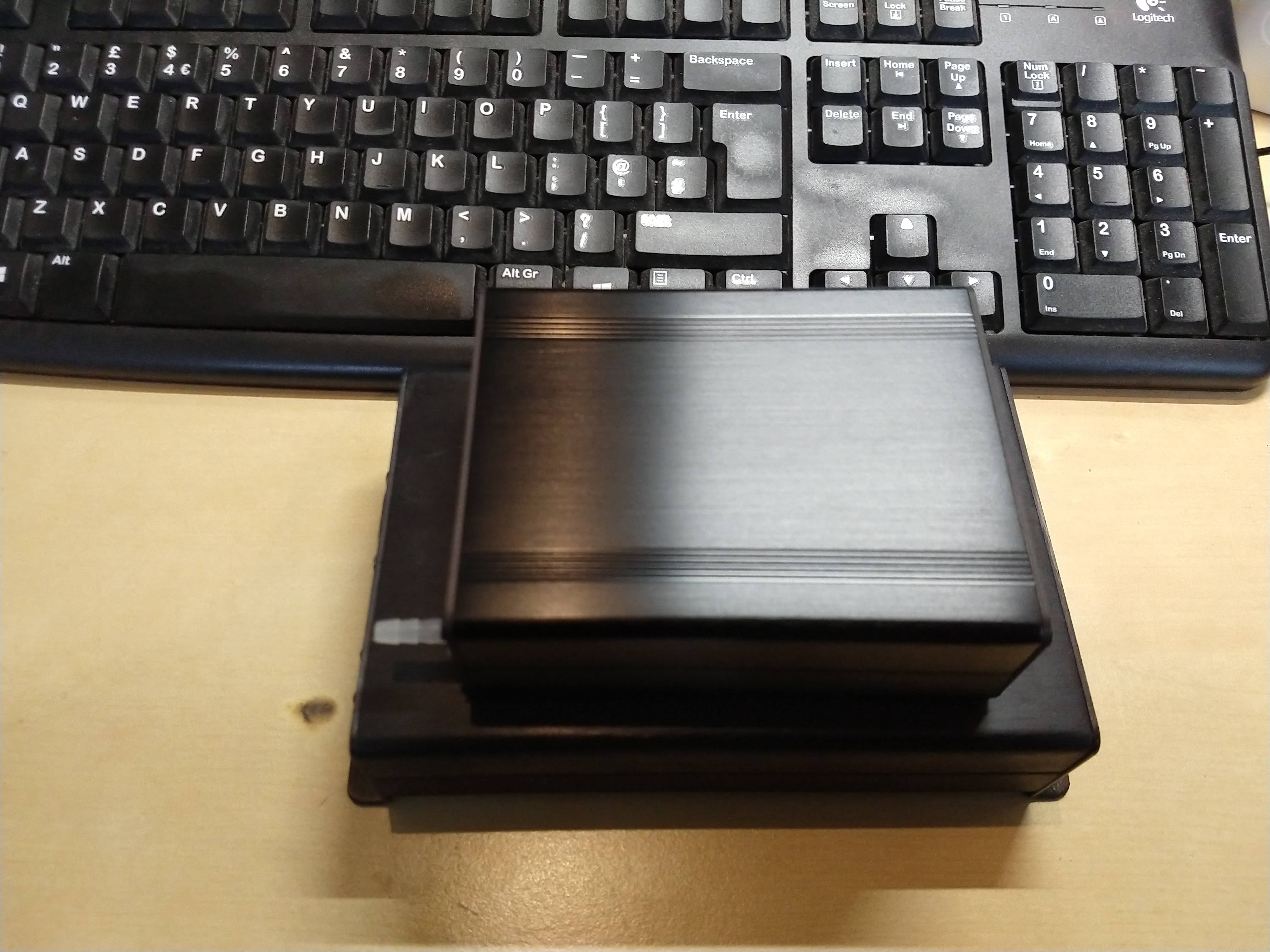

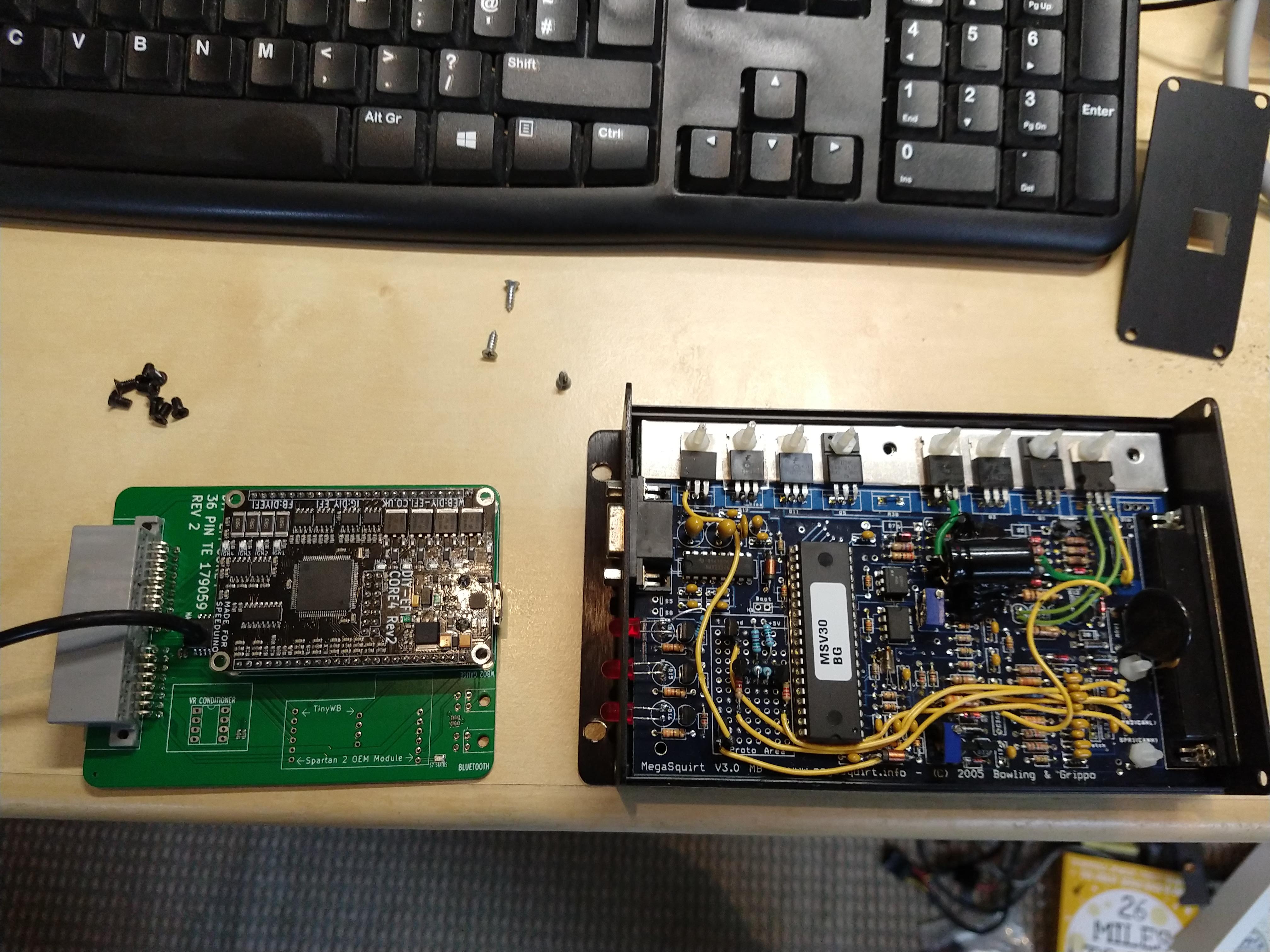

It's a lot neater

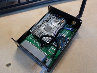

With WiFi added

Your MSI V3 board has a through hole PCB designed for home build, so of course it's bigger. But does mean it is easier to alter/add things to. If size is a problem there is the MicroSquirt.
BTW, you can add a VR input board to your Speeduino, rather than change the sensor to hall.

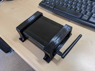

Tiny update, I printed some brackets to mount it with.

It turns out the ESP8266 for wifi was a bad idea as it caused spurious signals on the hall sensor line. Slowly working up towards getting the engine to fire.
