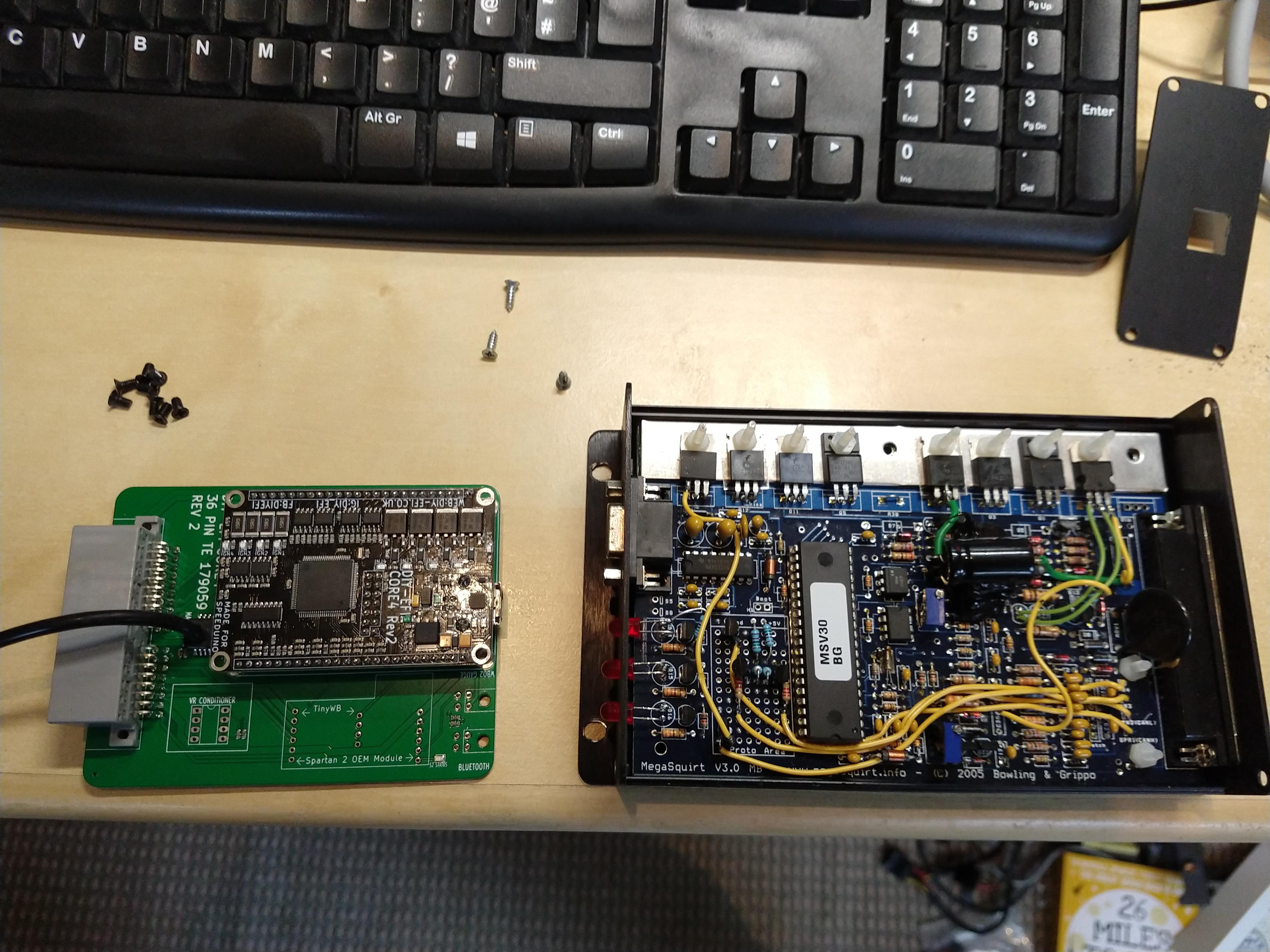

It's a lot neater
With WiFi added

scudderfish wrote: Mon Oct 26, 2020 6:40 pm It's a lot neater
With WiFi added
Your MSI V3 board has a through hole PCB designed for home build, so of course it's bigger. But does mean it is easier to alter/add things to. If size is a problem there is the MicroSquirt.
BTW, you can add a VR input board to your Speeduino, rather than change the sensor to hall.
I've got a Speeduino here. Be interesting to swap it for the MS2 on my SD1, but doubt I'll ever get round to it.

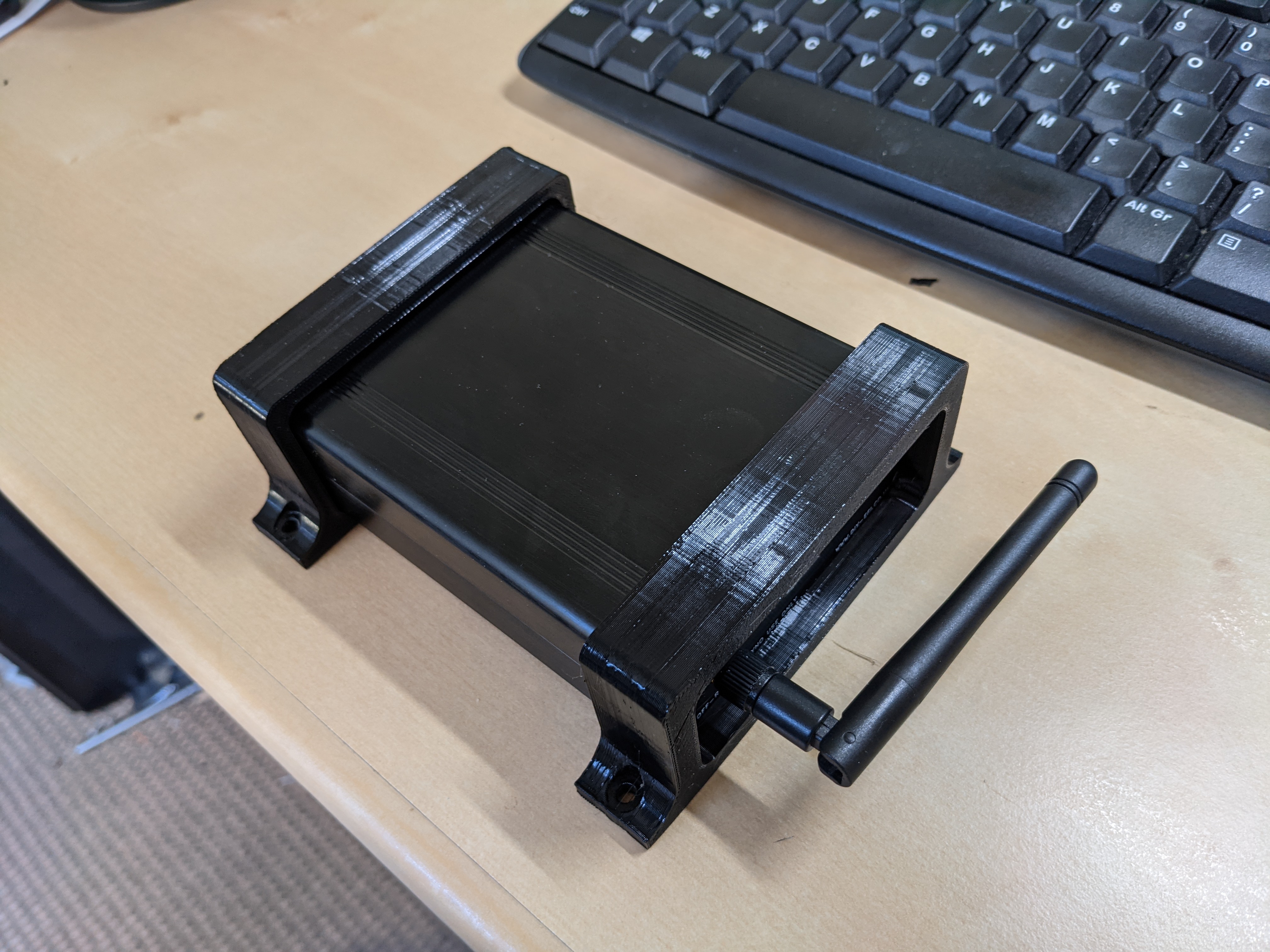

Tiny update, I printed some brackets to mount it with.
