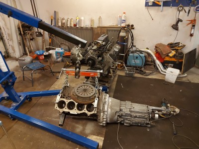

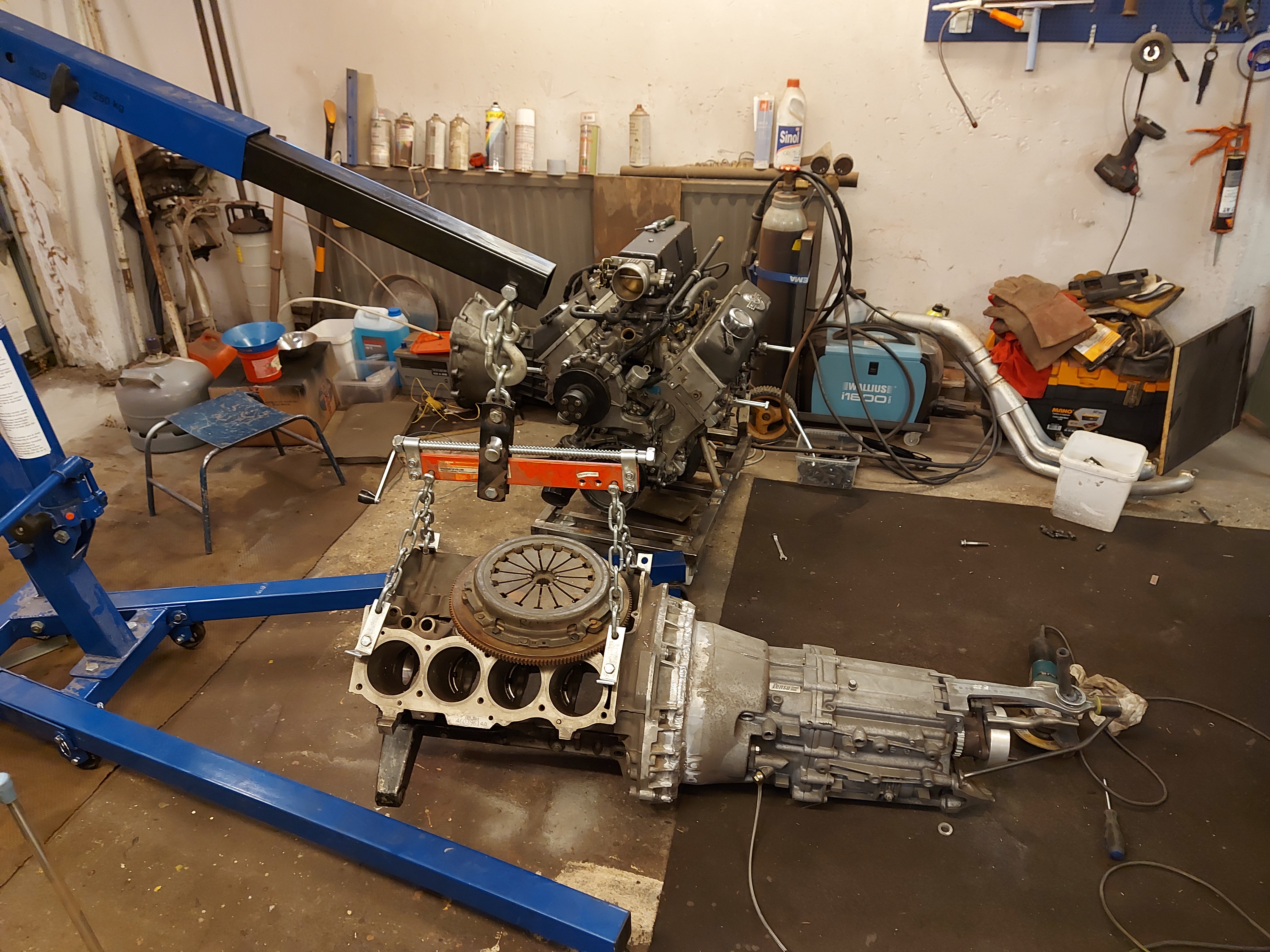

Finally some progress with the gearbox swap. Old engine and box was removed as a complete package. BMW box was fitted to a spare block and trial fitted to the car. The space was almost perfect. I shaped the tunnel around the LT77 when I did the conversion over 20 years ago and deliberately left some space around the box. The only real issue was in the front. There I had to raise the floor about 1/2" plus some clearance. Maybe 1" total.
So, currently the box fits the car, tunnel is almost welded back together. I ordered gearbox crossmember parts from Sweden (BMW to volvo 700 conversion). They were relatively cheap so making them myself was not cost-effective. Am I getting old and lazy ?

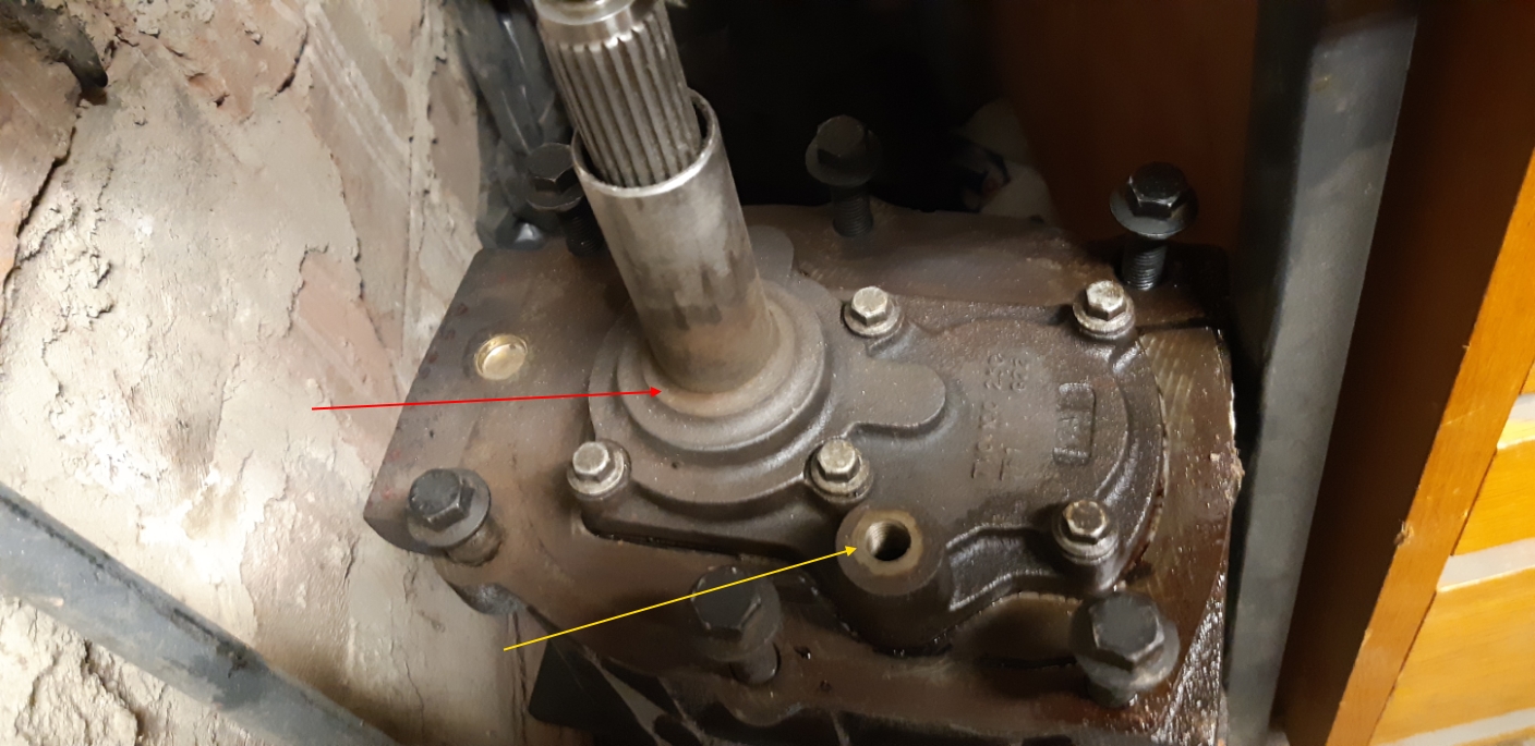

My R380 is different in the front cover area too. Maybe because it is a commercial box, maybe not.
Here is a photo of the R380 front cover plate. Two things: yellow arrow marks the release bearing arm pivot point. It´s roughly 1/2" taller than LT77. Red arrow shows the general shape of the cover plate. It is also more robust than LT77 one.
Normal SD1 V8 release bearing carrier did not fit between the diaphragm and cover plate (McLeod items). Also the pivot boss+pin height means that you can´t fit the slave cylinder. It won´t reach the bellhousing.
The easy fix is to machine the pivot pin boss down and shorten the release bearing carrier. But this means that it is not a direct swap.

minorv8 wrote: ↑Fri Dec 18, 2020 5:40 am My R380 is different in the front cover area too. Maybe because it is a commercial box, maybe not.
That's a good point, my front cover is also different to the LT77 (and to yours), mine is more of a rectangular block, no contour at all.
Reason I didn't mention this (aprart from the fact I forgot) is that this was not an issue to me as I changed to a concetric slave cylinder so didn't have to make any of the original parts fit or use the release arm pivot.
In fact the flat face at the front of the bearing cover plate was an advantage to me for this job.

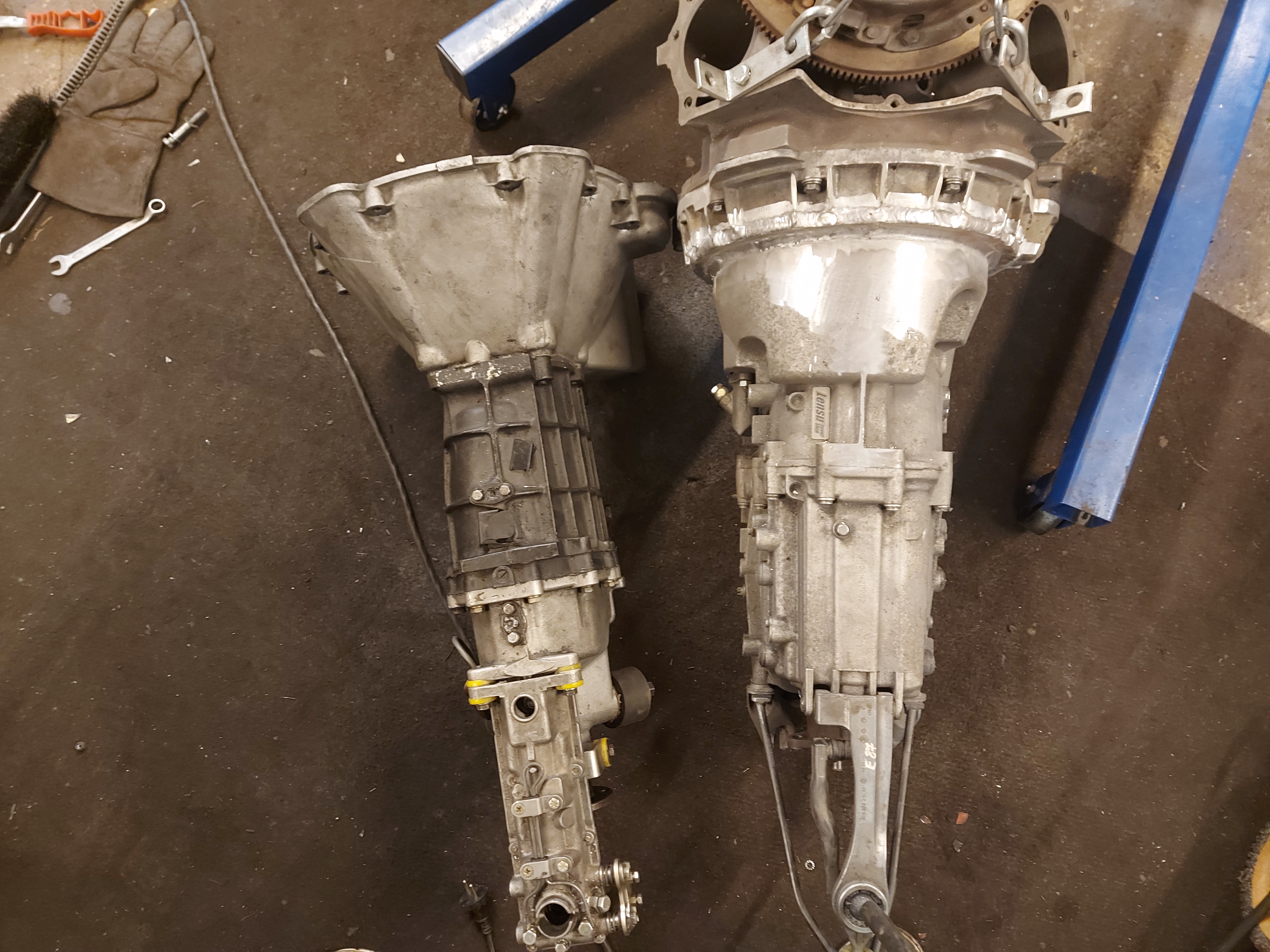

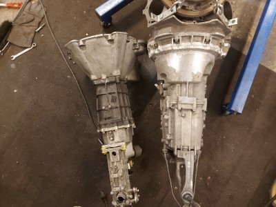

An update. Crossmember finalized and gearbox is now more or less in final position. There is enough room in the tunnel after bit of a hammertime. Here is a photo showing the LT77 and BMW box next to each other.
Re: Another gearbox option

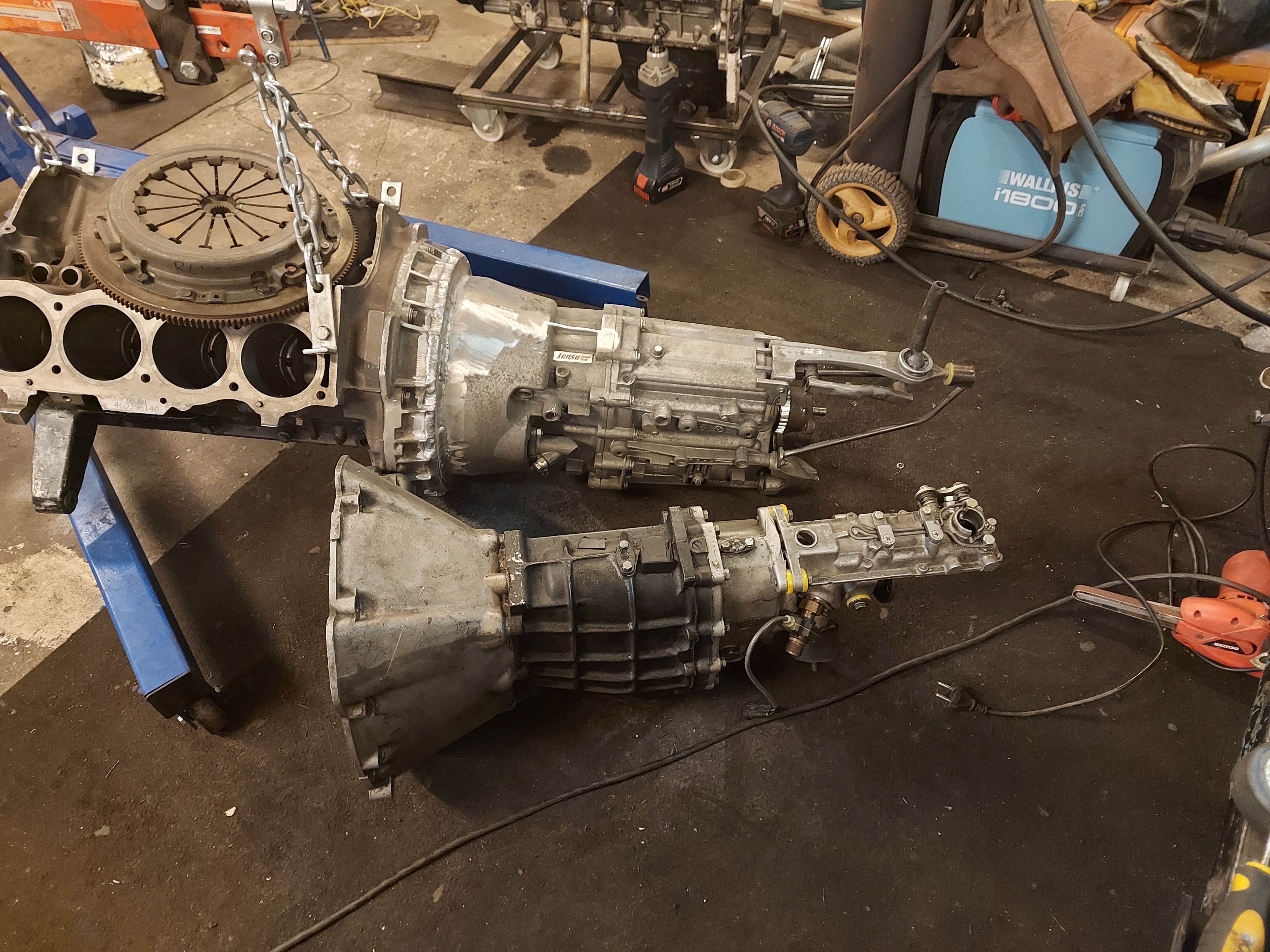

Here is another photo showing the boxes from above. ZF is way bulkier even if the length is just about the same. I bought a new 3500 SD1 propshaft from Rimmers. Even with the spacer replacing the BMW rubber donut the current propshaft was too short. The new propshaft needs to be shortened roughly 1,5 inches.

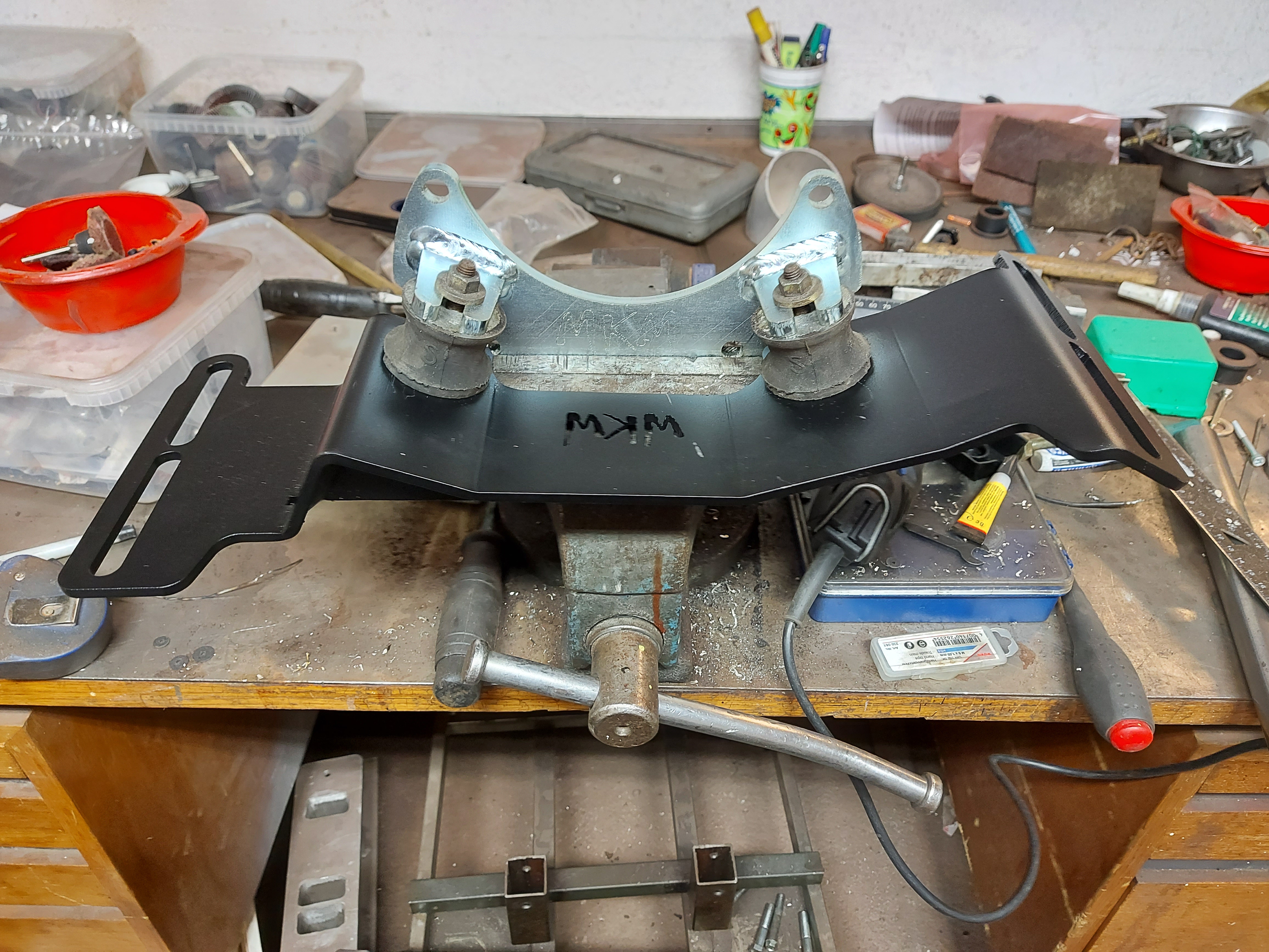

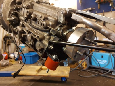

I got lazy with the gearbox crossmember. I used to tease my late father about him getting old when he no longer fabricated everything himself and bought something ready to fit instead. Seems that I have reach the same age. I bought a Volvo 760 + ZF box set of gearbx mounts and crossmember from Sweden since they were relatively cheap and speeded things up. Naturally the crossmember did not fit but it was a good starting point. The box mount was further modified by fitting a Hall sensor bracket for speedo signal. The 130K miles old rubber donuts are here for mocking purpose only and will be replace with poly donuts.
