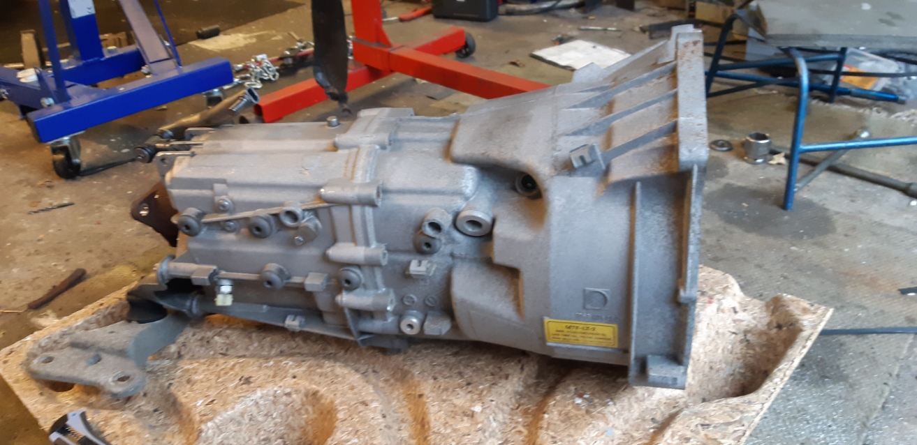

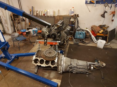

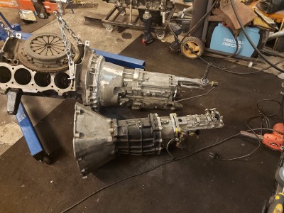

Here are some pics showing a BMW 6-speed box that got adapted to RV8. This will be fitted to my new engine (that is still being assembled…).

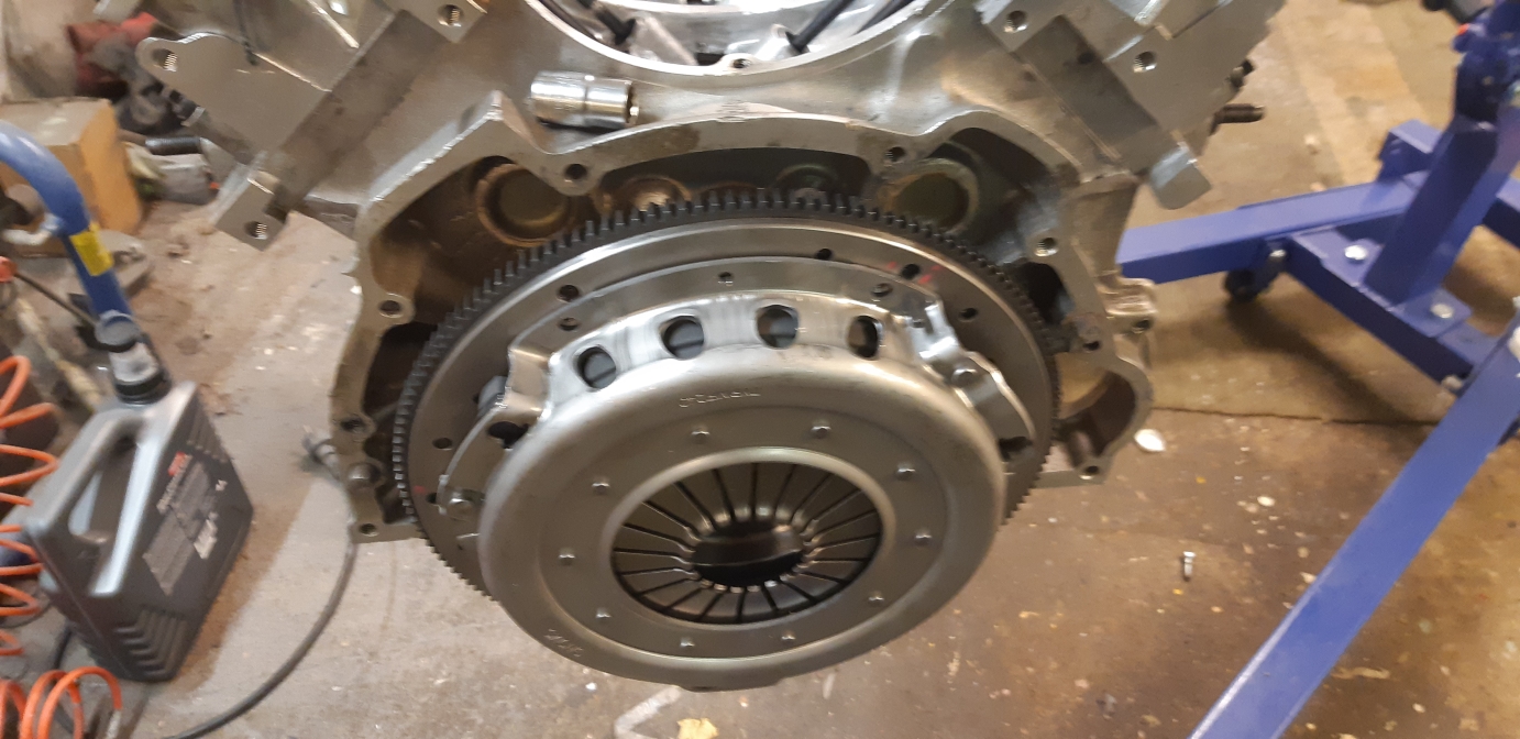

The main parts are Getrag GS6-37 box and P38 auto bellhousing. Clutch is a Sachs 240 mm 765 diaphragm and ACT 240 plate.

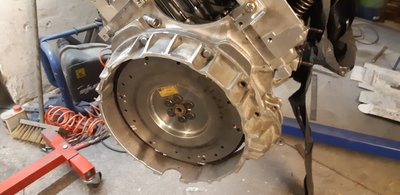

Anyway, a pic of clutch:

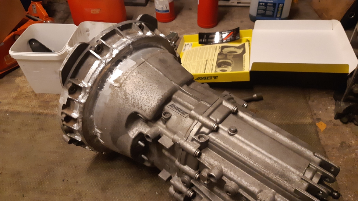

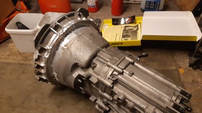

And the end result:

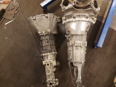

So why such a conversion ? Well, currently I have a TR7 derived LT77 that has survived behind a healthy 4.6. I do have a rebuilt R380 but both have the same ratios and I would prefer to have 1st gear around 2.90:1 number like T5. Now, T5 boxes and matching bellhousing are not exactly cheap.
Now, we have a local source that has converted BMW boxes to a lot of different engines. All you need to provide is a bellhousing (and a block if your engine is a new to him). He has a stock of boxes or you can supply your own. I bought mine from Germany (50 € + shipping 80 €), bellhousing from UK (£50 + shipping) and the actual labour (around 400 €). Being a diesel box the 1st gear is useless at 5.1:1 but others are what I needed. Clutch parts are all heavy duty BMW and there are plenty to choose from.
Total length flange to flange is about 1 1/4" less than LT77. Gear stick is very close to LT77 location with the matching BMW gear Shift assembly.

Interesting, what is the weight like vs the LT77?

Getrag weighs 45 kg with gearshift assy. I only had R380 to weigh and it was 49 kg without bellhousing and remote.

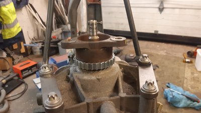

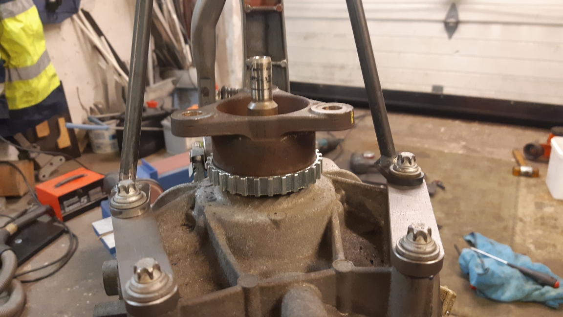

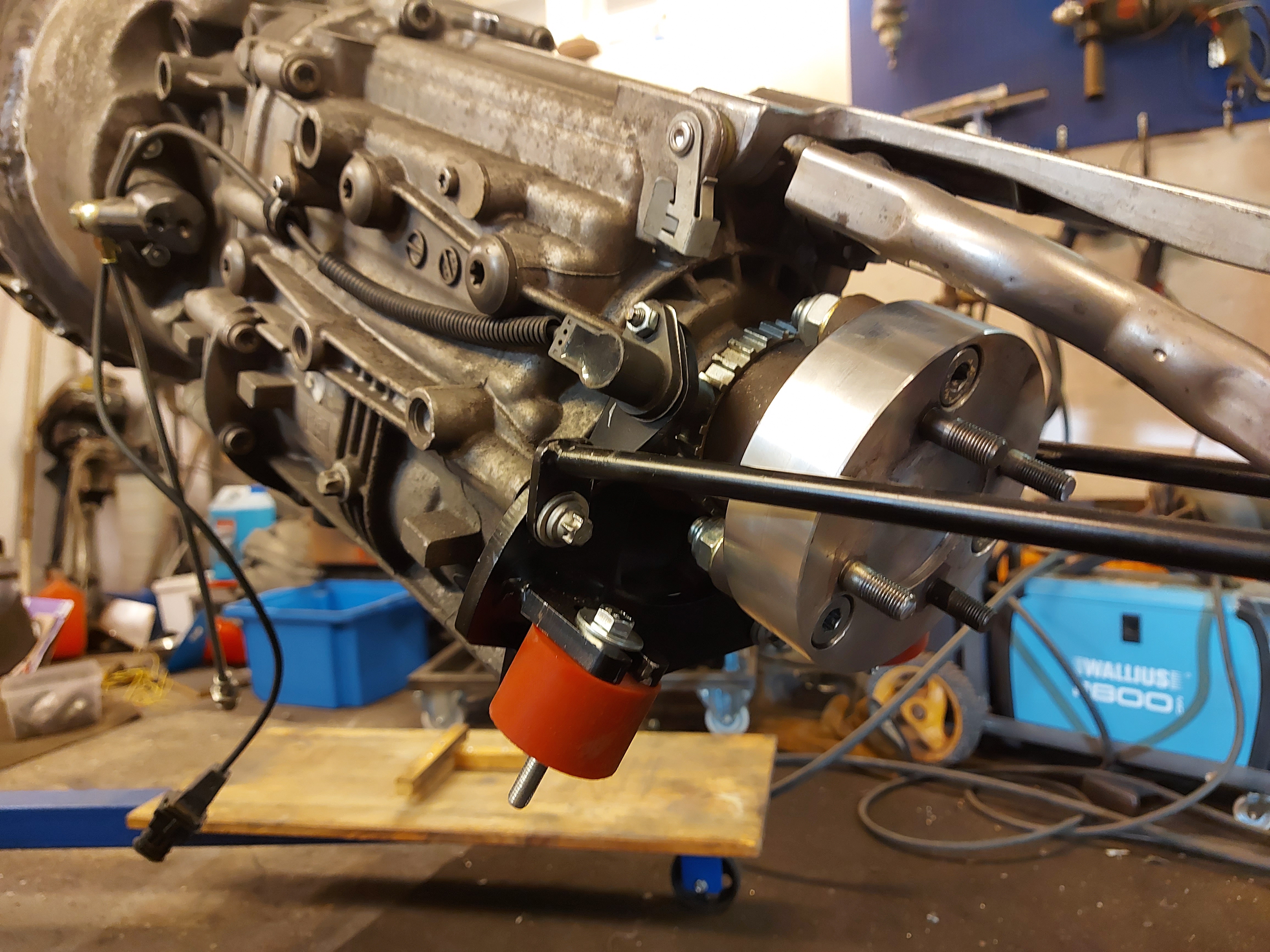

One thing that this box lacks is a drive or signal to a speedo. I solved this with a ABS trigger wheel. I machined the rear flange to a press fit and Loctite´d the ring gear on the flange. A Hall sensor will be fitted.
Compared to LT77 or R380, this flange is a very precise fit on gearbox output shaft and required a puller to get it removed.

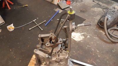

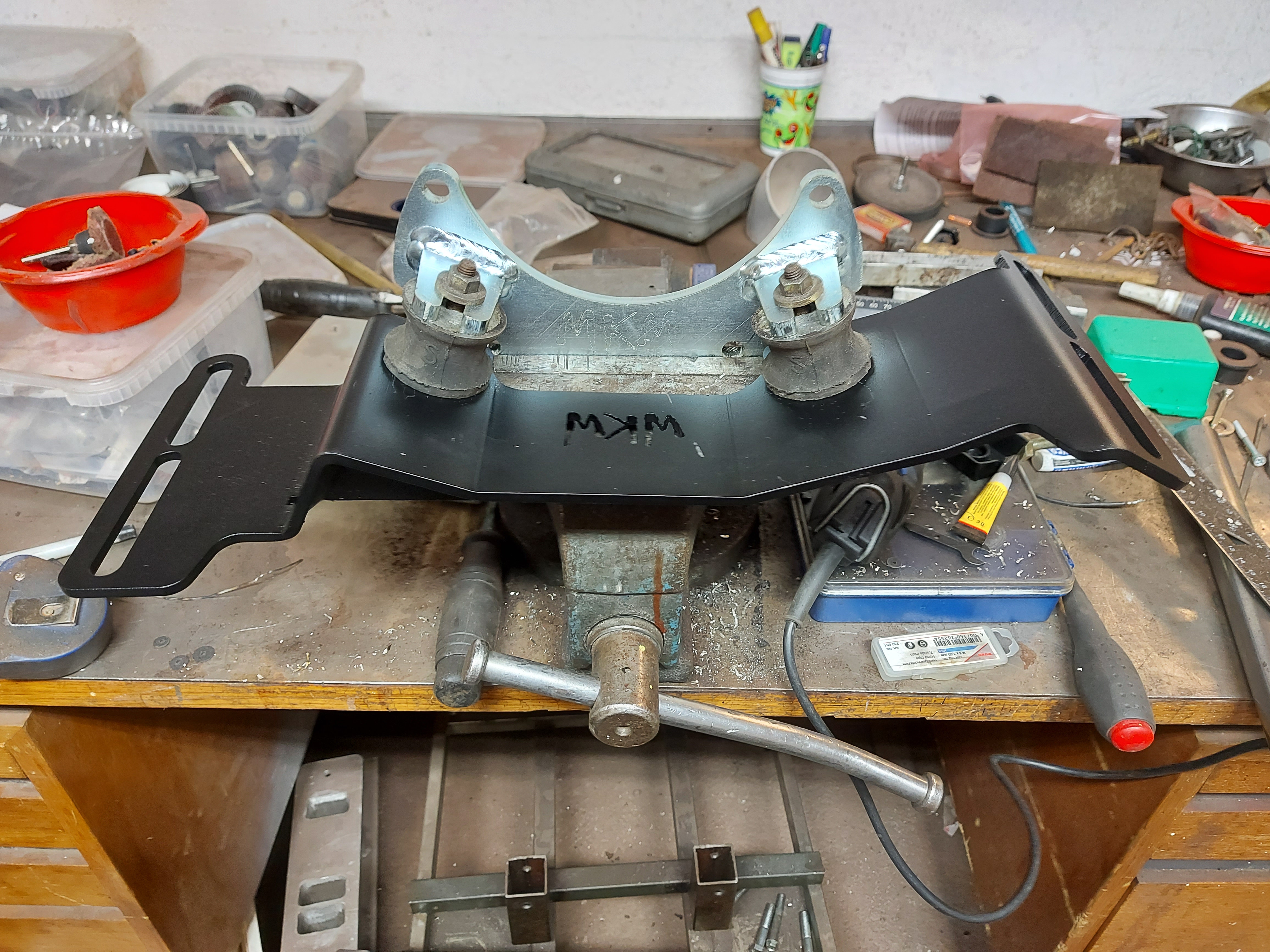

Another thing, I decided to use the BMW gear change assy for simplicity. I fitted urethane bushes. The rear mount is bolted to the body in Beemers but I did not want that so I made a simple support structure. It is bolted to the end of the box. The actual gearbox rear mount design is still open. I cut the Beemer gear lever and threaded it with a M12 die. The shift is precise and throws are very short.

minorv8 wrote: Thu Dec 12, 2019 10:47 am One thing that this box lacks is a drive or signal to a speedo. I solved this with a ABS trigger wheel. I machined the rear flange to a press fit and Loctite´d the ring gear on the flange. A Hall sensor will be fitted.
Neat way of doing the pulse drive. Mate used the bolt heads on the universal on a T5. But then you'll likely need a pulse converter for your speedo. A toothed wheel with the right number of teeth would get round that.
Posts: 4065
Re: Another gearbox option
With the output flange having 3 legs and 3 bolts...could easily have rigged up a sensor to read those.
minorv8
Posts: 571
Post by minorv8 »
Too easy !
