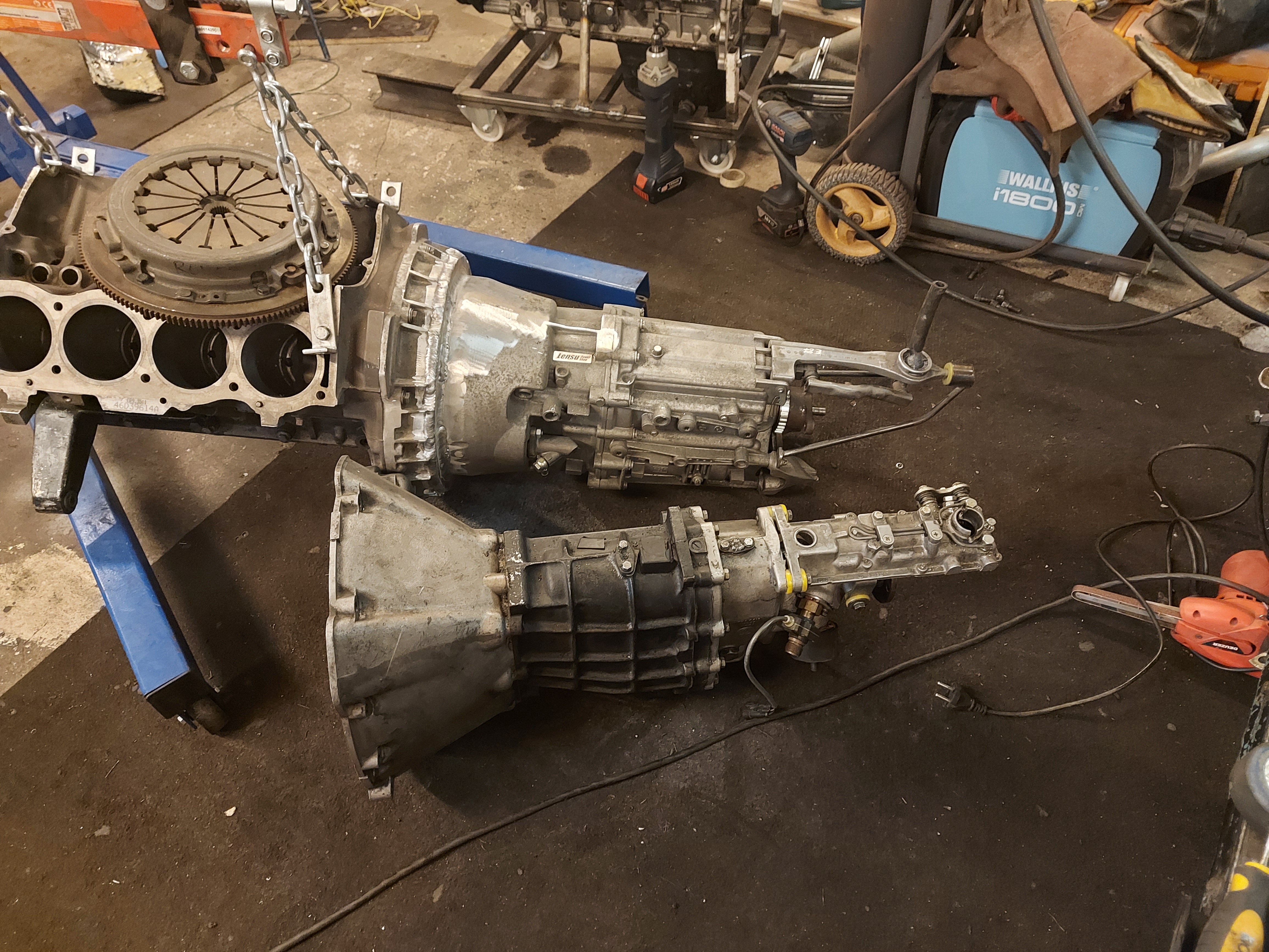

An update. Crossmember finalized and gearbox is now more or less in final position. There is enough room in the tunnel after bit of a hammertime. Here is a photo showing the LT77 and BMW box next to each other.

Here is another photo showing the boxes from above. ZF is way bulkier even if the length is just about the same. I bought a new 3500 SD1 propshaft from Rimmers. Even with the spacer replacing the BMW rubber donut the current propshaft was too short. The new propshaft needs to be shortened roughly 1,5 inches.
