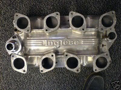

As per title
I have seen a Chev manifold with a set of 4 Webber IDF's that would be great for the GT40
Can that manifold fit a 3.9 RV8?
If not anyone got a Chevvy and want some Bling carbs?

manifold wont fit and the carbs might be a touch too big for your engine but I don't know what size IDF's they are. Apart from that you think you have problems just now with your efi wait till you try and tune quad carbs.

Posts: 2453
This is what I saw
http://cgi.ebay.com/ebaymotors/IDF-48-W ... dZViewItem
I accept there is a set up routine with these but certainly are a bit more period correct on a GT40 than EFi

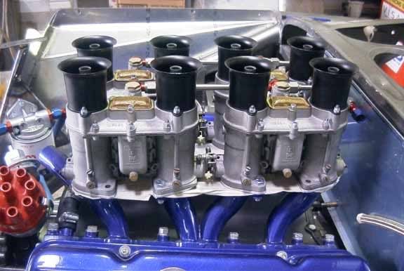

I have a set of 44IDF on a 4.6 engine.
They are working fine without the progression problems a lot of people encounter with the downdraughts.
The key is to have the right size carburettor (as always) with the right parts inside.
It took a bid of asking around and testing but as I said, mine are working.
I ended with: F7 emulsion tubes, 140 main, 180 air and 0.60 idle.
That will be different for any other engine.
The main point was the change to the F7 emulsion tubes that has given the better progression for my engine.
As a lot of people said to me, why not go EFI with throttle bodies?
It will take away all the mess with the jets and most of the set-up.
Posts: 2453
Pitsnow
That looks really good! and the correct effect for the GT40
So the 48 will be a bit big - oh well with the USD rate at the moment they looked like a bargain!
