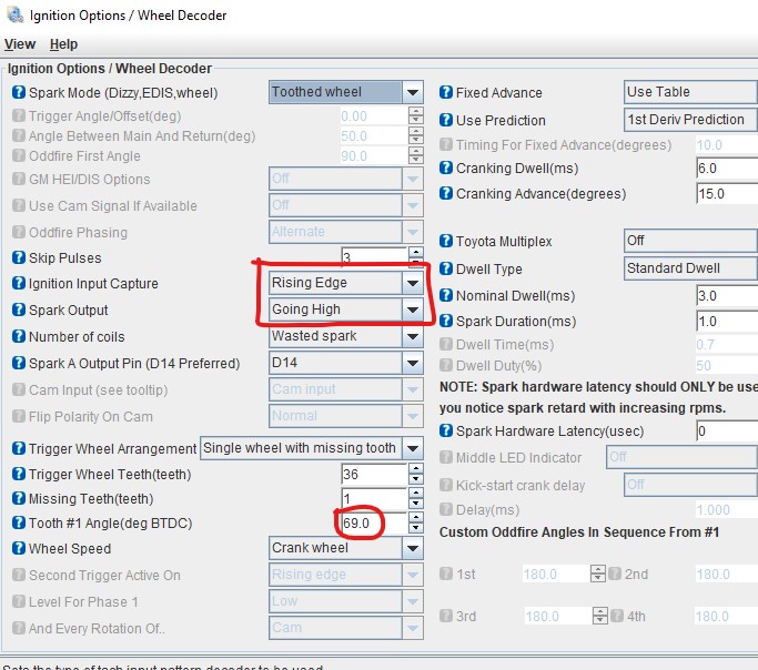

Where does the MS pick up its firing point? Presuming a toothed wheel with a tooth missing?
If so is the MS actually fire the spark? At the gap, at the next tooth or something like 15 degrees after the gap…….I seem to remember reading about 20 years ago it was the third option above.
So the MS could be firing exactly as it should but in effect the toothed wheel is out by the ??? 15 ish degrees?

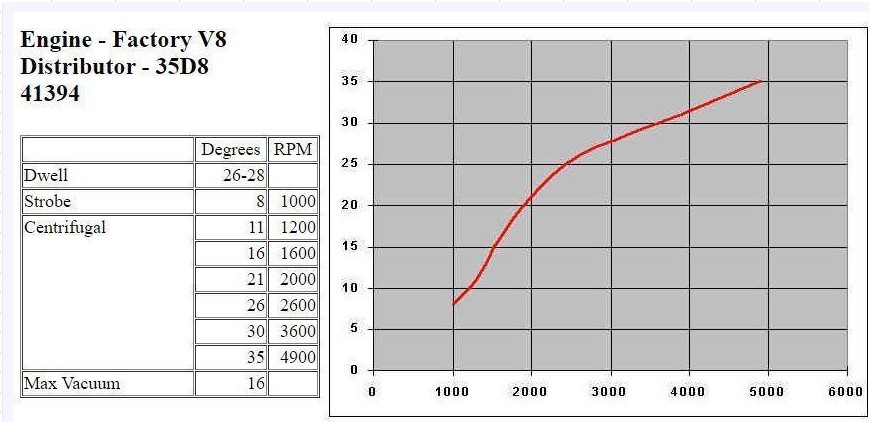

This is the information I used for the timing curve

Thanks for the feedback Ian.Ian Anderson wrote: ↑Tue Jul 22, 2025 11:41 am Where does the MS pick up its firing point? Presuming a toothed wheel with a tooth missing?
Just my thoughts
The MS picks up from a 36-1 toothed wheel as you suggest, the gap is placed circa 70° (actually 69) ahead of top dead centre. This is the value I have in the settings for Tooth #1 Angle BTDC as you can see in the graphic below.
The actual location of the missing tooth should not matter within reason as this value acts as an offset. I suppose it may need to be at least as far ahead of TDC as the maximum advance (plus a bit for processing time) which it is.
I think the other options you are describing are the "Ignition Input Capture" and possibly "Spark Output". I did believe this was related to whether it was triggering on the leading or trailing edge of the teeth but not absolutely sure. In any case I believe these settings are as per when the unit was delivered.
However this shouldn't really make any difference as I'm not simply measuring the physical location of the missing tooth with respect to TDC I have checked the point which the spark actually occurs with a strobe. This is initially done by setting "Fixed Advance" setting to "Fixed timing" which triggers at whatever setting is entered in "Timing For Fixed Advance". For setup I put this at 10° so that I could read it off against the timing mark I have on my crank pulley from using the distributor, this was reading spot on. When I re-enabled the table I could see that the timing was indeed triggering at 30°. I don't have a mark on the pulley for this but could see it was around 3x as far as the 10° mark and the teeth on the 36-1 also verified this (at least to a degree or two)
I'm thinking more along the lines of whether there is something specific about my engine configuration which actually requires, or "likes" this advanced timing.

The advance 'curve' at the 50kPa uses the same increments as the data I have for the distributor advance curve (I don't know how reliable this is and I don't even know where it came from!), again in the graphic above, but starting at the 35° value as established. In fact I've dialled it down a bit with higher RPM, the range for the distributor works out at 27° I've dialled it down to 21.
At atmospheric pressure, which would be encountered at WoT, the timing values are obviously lower. Again this curve follows the same increments but dialled down by 16°. the data between has a pro-rata decrease in timing to give a smooth transition between closed and wide open throttle.
So not on a dyno but hopefully a little better than 'best guess', let's say "best educated guess"!
The table should give very close to what the distributor would give (albeit I don't know the provenance of the data I've used) although dialled up by around 10° in general but tapering off at higher RPM by 5° - I hope that makes sense, I'll try and qualify it.
The distributor data shows 35° maximum as RPM increases, at WoT this would be the only advance in place, there would be little or no vacuum. In this condition the table I've created would be giving 40° - Not massively different.
At idle the distributor would be running at 24° - 8°initial plus 16° Vacuum - if we remove the ported "bodge", I'm running at 35°. Given that the 8° value seems a little conservative (I was using around 12° with the distributor) I don't think I'm massively different here either.
