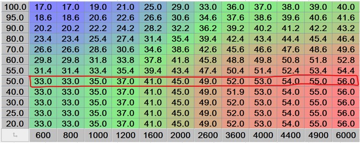

And this is the table I'm currently using.
The red highlight indicates the kPa row which is being accessed at idle.

OK, moving on to the table now.
The area I've highlighted in the graphic above at 50kPa is where I am at idle, this effectively light load, the only way I can see of getting a lower kPa is on overrun when I'm not really concerned about the timing as it won't even be firing at higher RPM due to fuel cut-off and at lower RPM it is unlikely to get thre, this is why I've left the advance the same as it is at 50kPa.
The advance 'curve' at the 50kPa uses the same increments as the data I have for the distributor advance curve (I don't know how reliable this is and I don't even know where it came from!), again in the graphic above, but starting at the 35° value as established. In fact I've dialled it down a bit with higher RPM, the range for the distributor works out at 27° I've dialled it down to 21.
At atmospheric pressure, which would be encountered at WoT, the timing values are obviously lower. Again this curve follows the same increments but dialled down by 16°. the data between has a pro-rata decrease in timing to give a smooth transition between closed and wide open throttle.
So not on a dyno but hopefully a little better than 'best guess', let's say "best educated guess"!
The table should give very close to what the distributor would give (albeit I don't know the provenance of the data I've used) although dialled up by around 10° in general but tapering off at higher RPM by 5° - I hope that makes sense, I'll try and qualify it.
The distributor data shows 35° maximum as RPM increases, at WoT this would be the only advance in place, there would be little or no vacuum. In this condition the table I've created would be giving 40° - Not massively different.
At idle the distributor would be running at 24° - 8°initial plus 16° Vacuum - if we remove the ported "bodge", I'm running at 35°. Given that the 8° value seems a little conservative (I was using around 12° with the distributor) I don't think I'm massively different here either.
