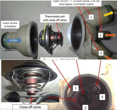

I've ordered the P38 version as this appears to be 85 degree stat...more importantly, now I've researched these things there is also one other crucial function that was missing from my last set up (and quite possibly the reason for my problems). Its regarding the thermostat bypass pluming. the internal thermostat on these also has a disc that, when open blocks the thermostat bypass.....eureaka (I hope), my previous set up did not have any such feature (sounds obvious now), which means that possibly a third of the water circulating bypassed the rad!.

Yes the internal cut off is an interesting one......I found this very useful diagram on google, that shows how it works.....but it makes sense.

My understanding that the P38 one only came in one temperature.
The Discovery II V8 ones came in at least two temperatures, but they are a totally different design!!

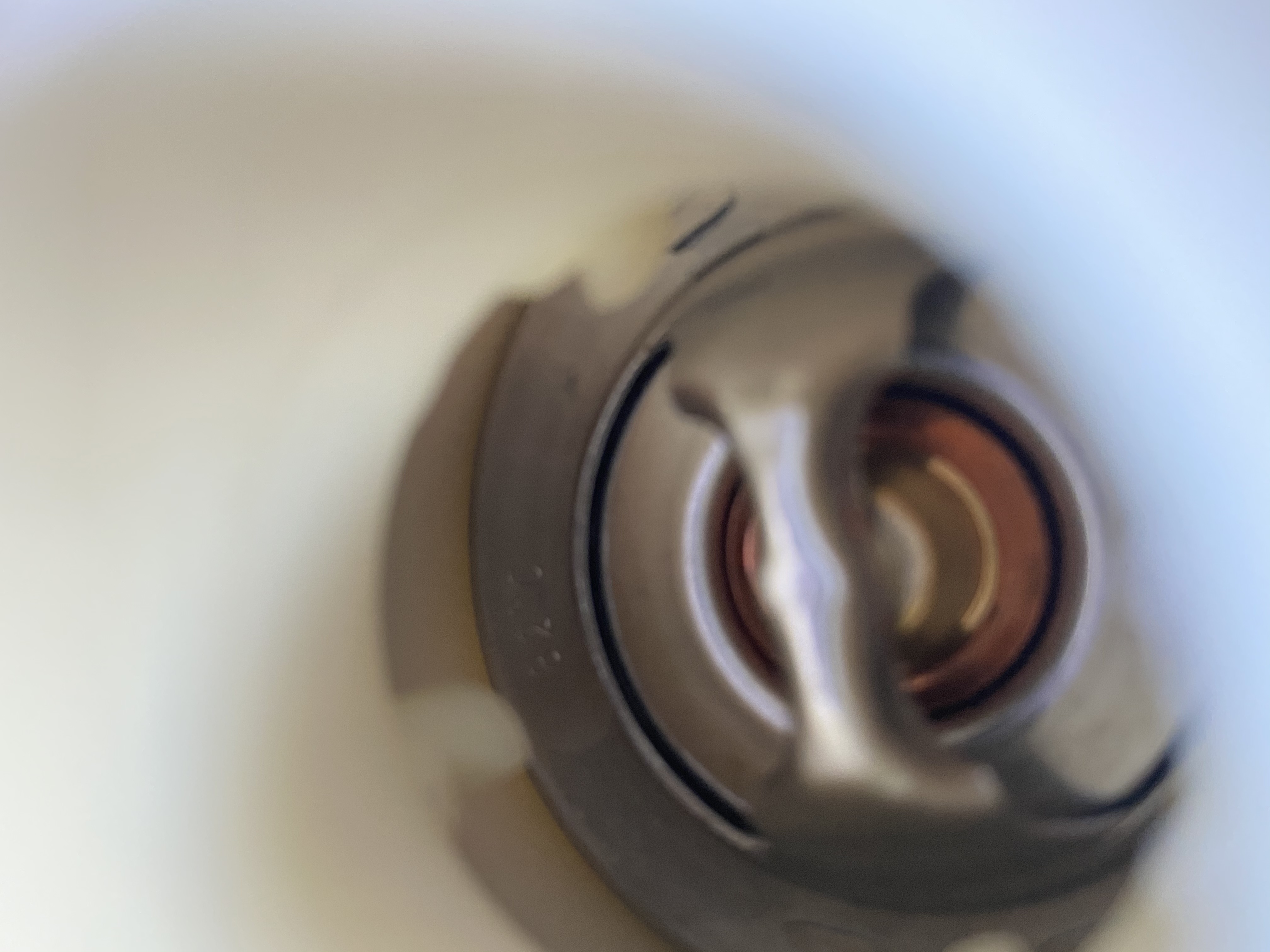

I received the thermostat today....it is indeed 82degrees...i wonder if they started doing some after market ones as my Haynes manual also suggest they run at 95...
And here it is installed...definitely an artificial heart!.
