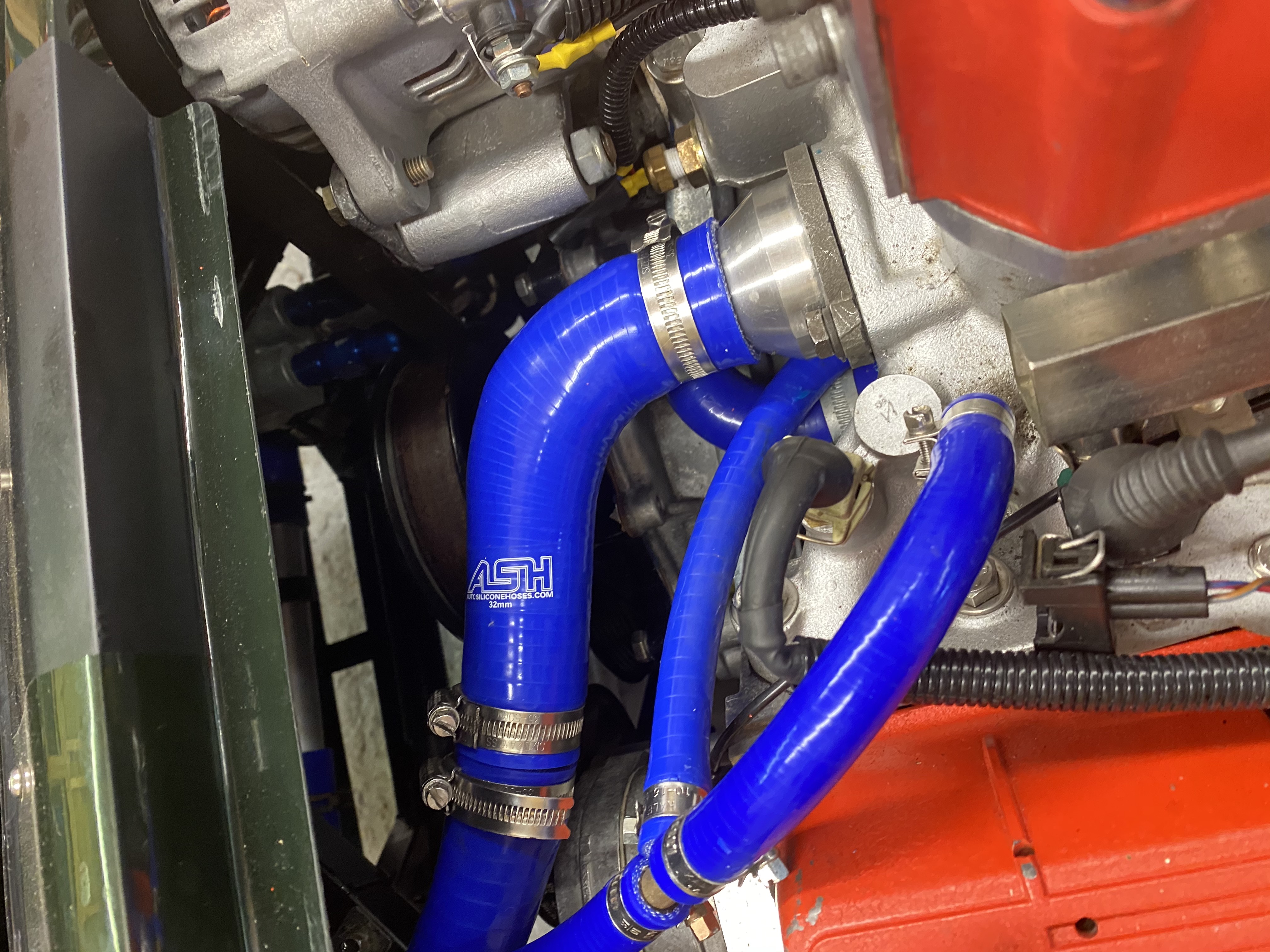

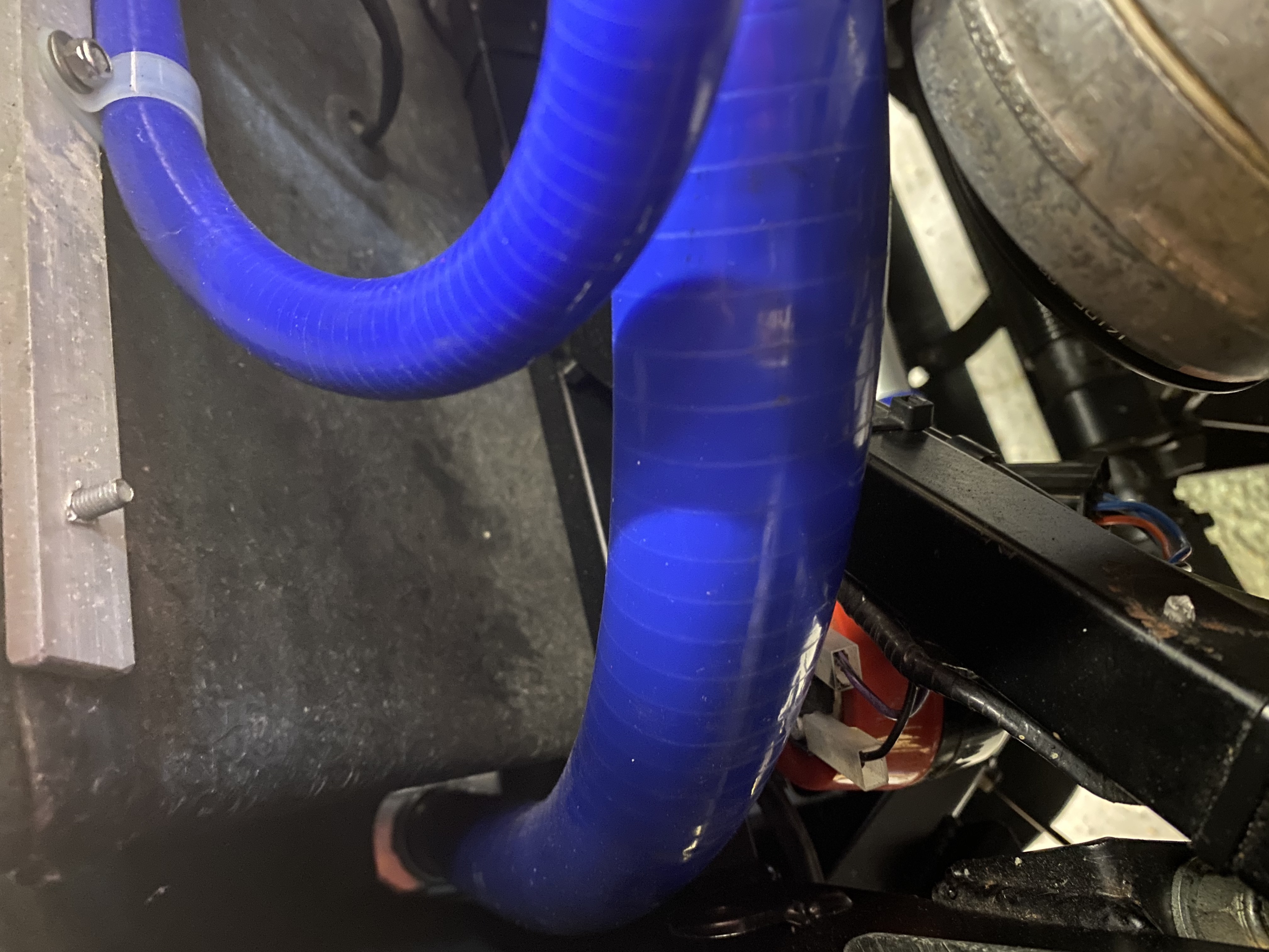

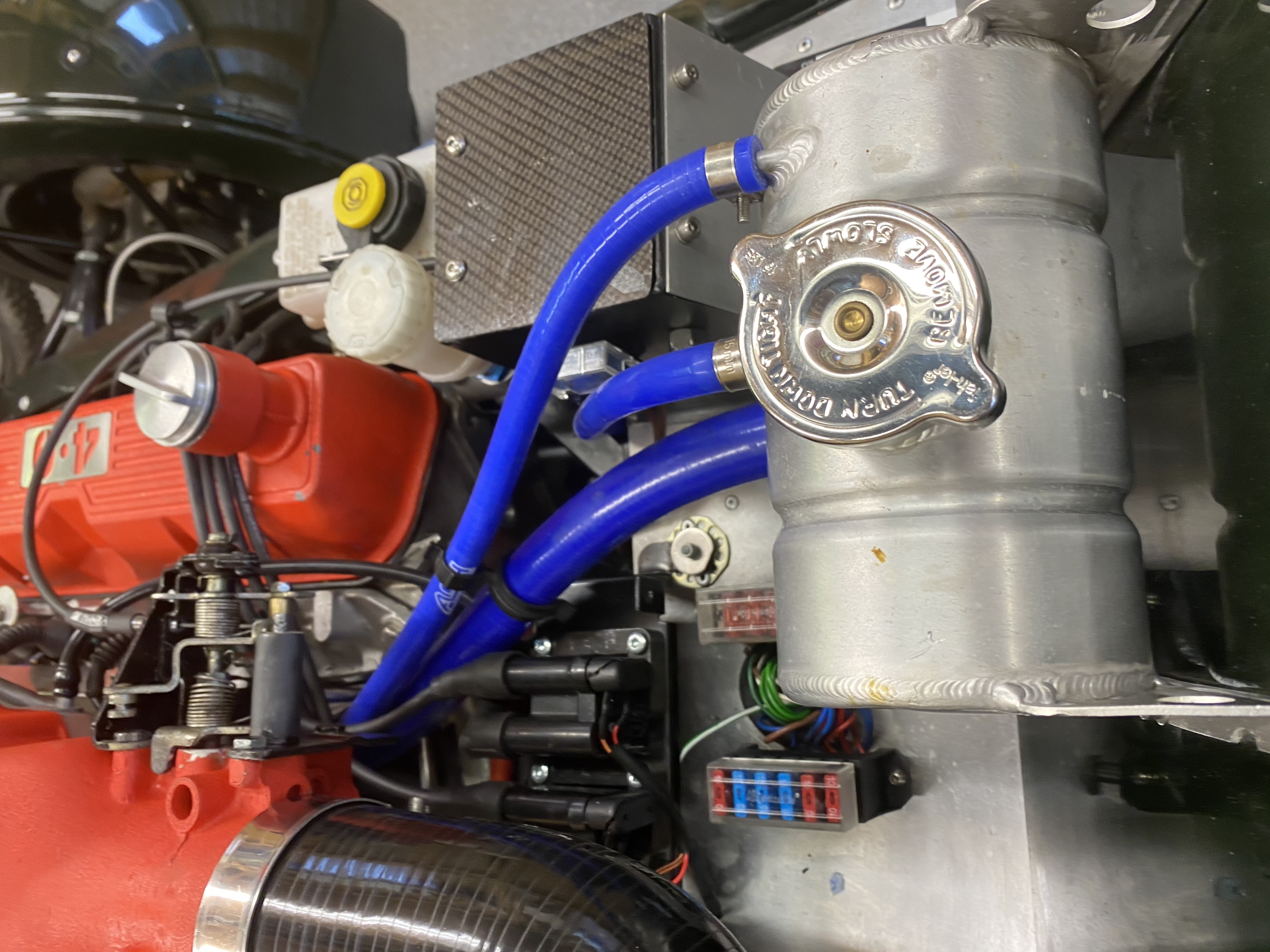

OK, here are some pics:
This one shows the header tank from bottom to top (looking at the pic), the larger hose is the one that goes to the inlet manifold, then the hose that goes to the 't' piece, then the overflow. This shows the thermostat housing and the T piece (for the t piece, it connects to the header tank, the inlet manifold and the top of the rad): The connection to the top of the Rad:

Apologies - I'm still a bit confused!
Is the thermostat at the top front of the inlet manifold?, i.e. where the top hose leaves the inlet manifold going to the radiator? Or is it in the bottom hose?
What inlet manifold is it?, it looks like an EFi one.
The big pipe from your header tank should go into the bottom hose - so water from it gets drawn into the engine. If you connect it to the front of the inlet manifold, the water will be pumped _into_ it!
If it's the EFi manifold, then there is a little vent pipe near the water temperature sensor. It's supposed to go to the hotspot in the throttle body, but if not, it should go back to the header tank. It's the highest point, and without it air will gather behind the thermostat.
This 'T' piece you have - it seems connect the header tank, the inlet manifold, and what else?
Maybe a list of pipes and where they go to/from would be helpful.
Re: Cooling issues.
Inlet manifold is the EFI version:
This one: The thermostat is indeed at the top front of the manifold. The big pipe from the header does to into the inlet manifold just under the thermostat.
The vent pipe you speak of....goes back to the header tank, and also into the top of the rad.
If the large pipe should go to the bottom hose, then what would the connection point on the inlet manifold be used for?.
The more I dig into this, the more it feels like everything is completely wrong.....
Thanks for the help.
Paul.
Paul.

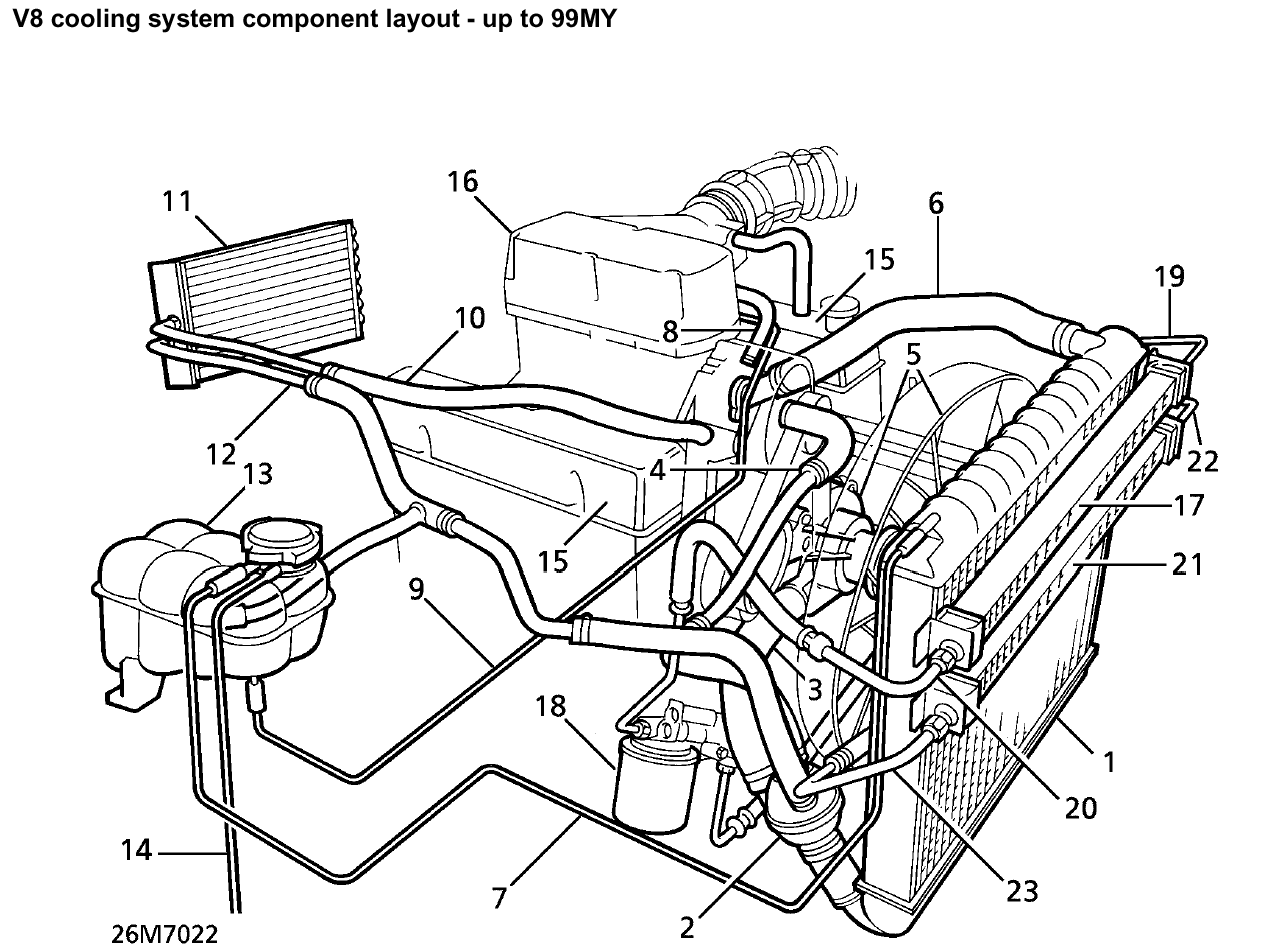

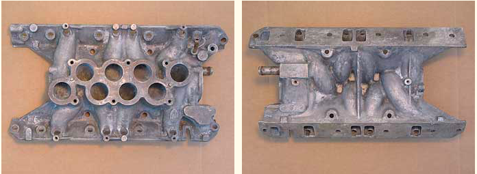

You've got a mixture of parts that were never together on a factory engine. It looks like you've got the Range Rover P38 style front cover (with the water pump that rotates off the back of belt, i.e. the opposite way to the crankshaft), and an earlier inlet manifold.
Not that there's any reason it can't be made to work.
The two outlets at the front of the inlet manifold are heater feed and thermostat bypass.
I think you have two options:
1. Keep the thermostat in the top hose. This means you need:
- Top hose from thermostat outlet to top of radiator.
- Bottom hose from bottom of radiator to water pump inlet.
- Blank off lower 19mm (ish) front outlet from inlet manifold.
- Top 19mm outlet goes straight down to 'T' into bottom hose. This is the thermostat bypass circuit.
- Header tank big pipe at the bottom goes down to 'T' into bottom hose as well.
- Radiator vent goes to top of header tank.
- Small outlet that is supposed to go to throttle body hotspot instead goes to middle of header tank.

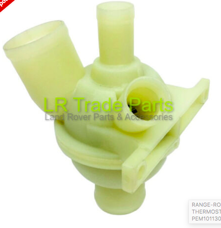

2. Move thermostat to bottom hose.
This is the same arrangement as above, but the thermostat will have all of the ports you need instead of a bunch of 'T' pieces.
You should find it looks very similar to the picture below.
You will find it a bit of a bugger to fill with coolant though - I always take off the top hose and fill in both directions (i.e. engine and radiator!)
With the P38 thermostat, they only come in one temperature, which is about 95 !! I believe the Discovery 2 thermostat is cooler, but I don't know if it's got enough ports on.

Sorry!, just looked again. My bad. Try this:
- Lower 19mm (ish) front outlet from inlet manifold goes straight down to 'T' into bottom hose. This is the thermostat bypass circuit.
Also, your header tank does need to be at the highest point. Worth being clear about that.
For the record, on the earlier timing covers, the water pumps had extra inlets on them which moved to the thermostat on vehicles with the timing cover you have. This is why you need to add extra T's to the bottom hose as you have neither thermostat housing in the bottom hose nor water pump with the extra inlets.

Ok..sounds good..only one that won’t work, is the connection to the middle of the header tank. This one is the overflow, so only works if the pressure in the header tank goes too high. I guess ‘T’ ing it to the rad vent......

Another thought - Regarding the outlet to the 'throttle body hot spot' on the top of the manifold....I've looked at the diagram and I can see no reason why this is even needs to be connected. The larger 16mm connector should do a perfectly adequate job of by passing the thermostat. What do you think?
