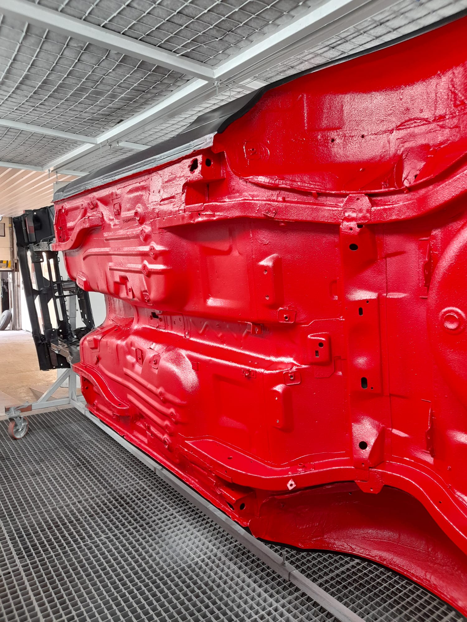

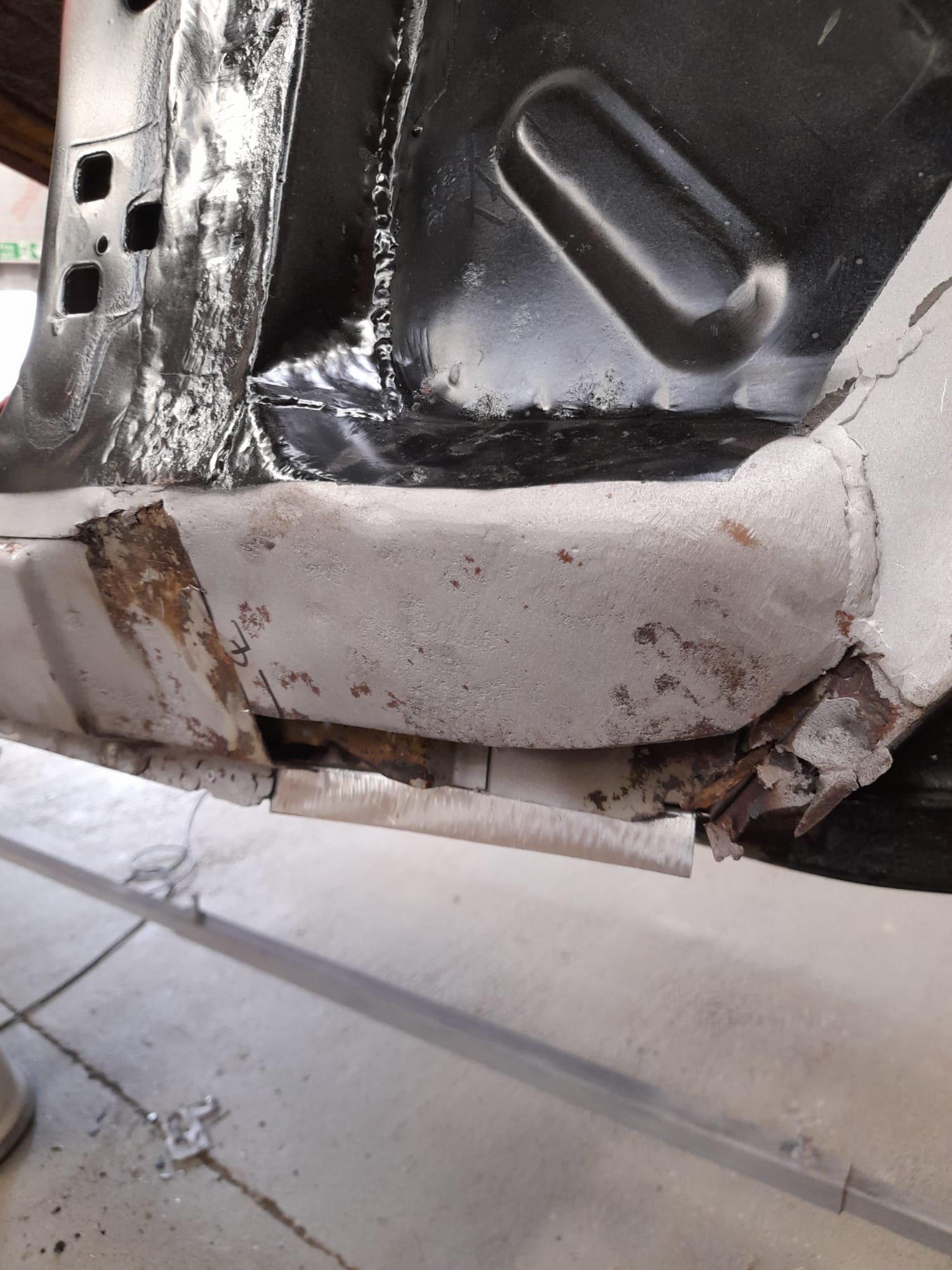

well we bit the bullet this year (late 50th bday present) and had the shell sent away for restoration, scary whats found under seemingly good paintwork etc,

Current state with the car as of yesterday after 5 months of panel work :(

Not cheap to do by any means, but needs must. Rust just gets everywhere ! Hopefully that'll be it sorted for many years to come.
Ideal time to sort arches etc for additional tyre clearance where necessary.
I did a lot of repairs to mine during the lockdowns, seemed ideal time as nowhere to race etc. But trying to cut out old rust and replace is just a nightmare, even more so when some was around the caged areas.
I didn't go as far as a full strip down though.
That's major work there !

I think a lot relies on ensuring all work is done in a clean, warm, dry environment. And also treat any rust with a suitable rust killer...that isn't always so easy though.
I injected stuff into the sills, and gaps etc I could find. Hopefully it will help, but time will tell. I know there are some areas under paint I should have done better, and already just over a year on a few bubbles are re-appearing. Not structural, but very annoying. But my garage is not heated, and over winter whilst dry inside, the atmosphere can be damp. All this was before painting, although I did have a lot of it done with epoxy primer.
Under some rusty bits under the scuttle/wing are where there were multiple layers of metal, some actually were full on bare steel. Just trapped from new, and they were still like new. Outer layers were bad though

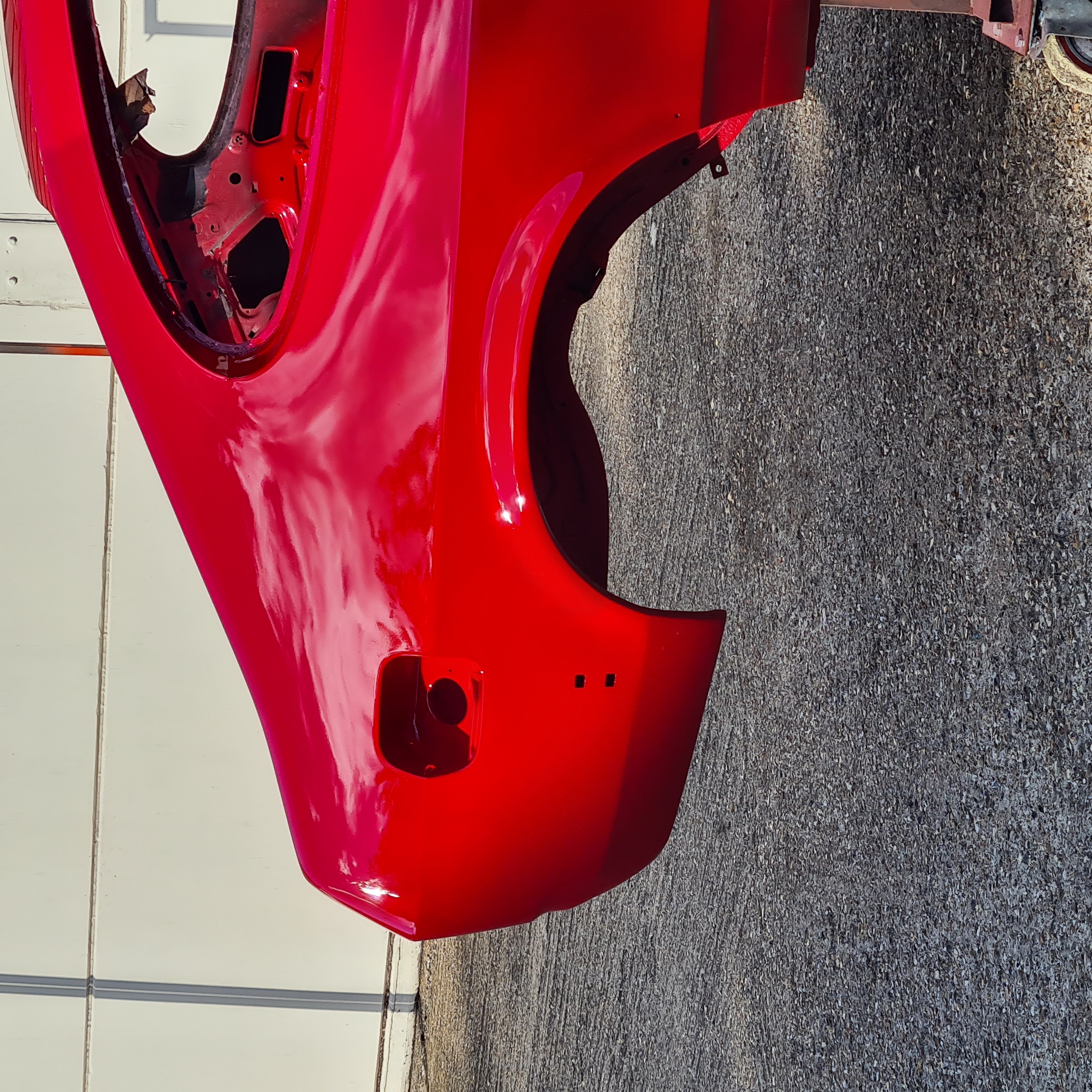

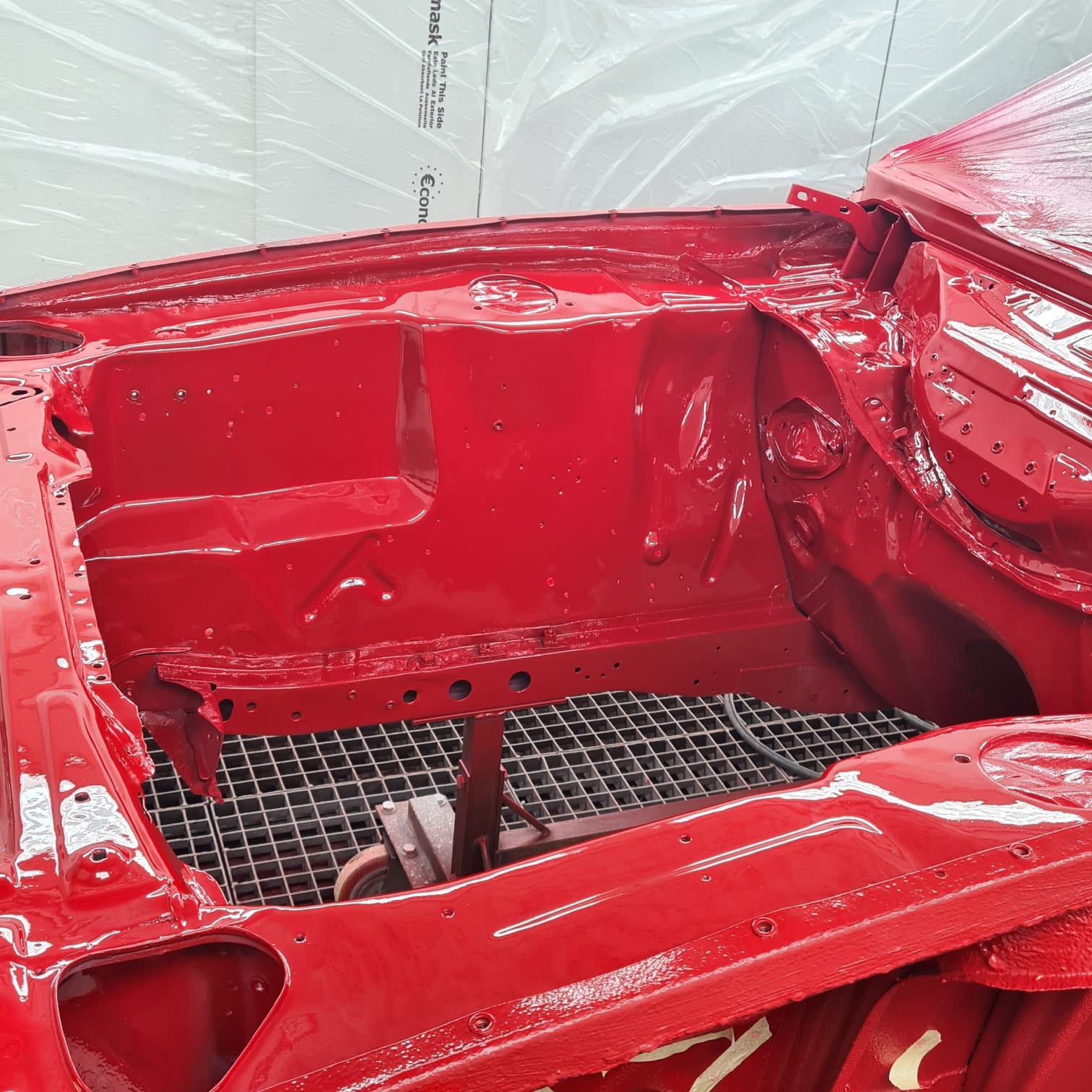

A little update, after nearly 6 months of panel work and rust removal top coat has finally gone on
car will be coming home soon for me to start refit work while they concentrate on the panels left to prep and paint,
once im done the car will then go off to have the new exhaust and manifolds made, the car will then go back to Browns for final panel fit up and then flat and polish,

Long road ahead still. Lots of patience needed.
I opted for fibreglass wings. Mainly as at least they won't rust again !! lol
But they were an absolute ton of work to get to fit half decent. No idea why, but they were just a bit wrong everywhere.

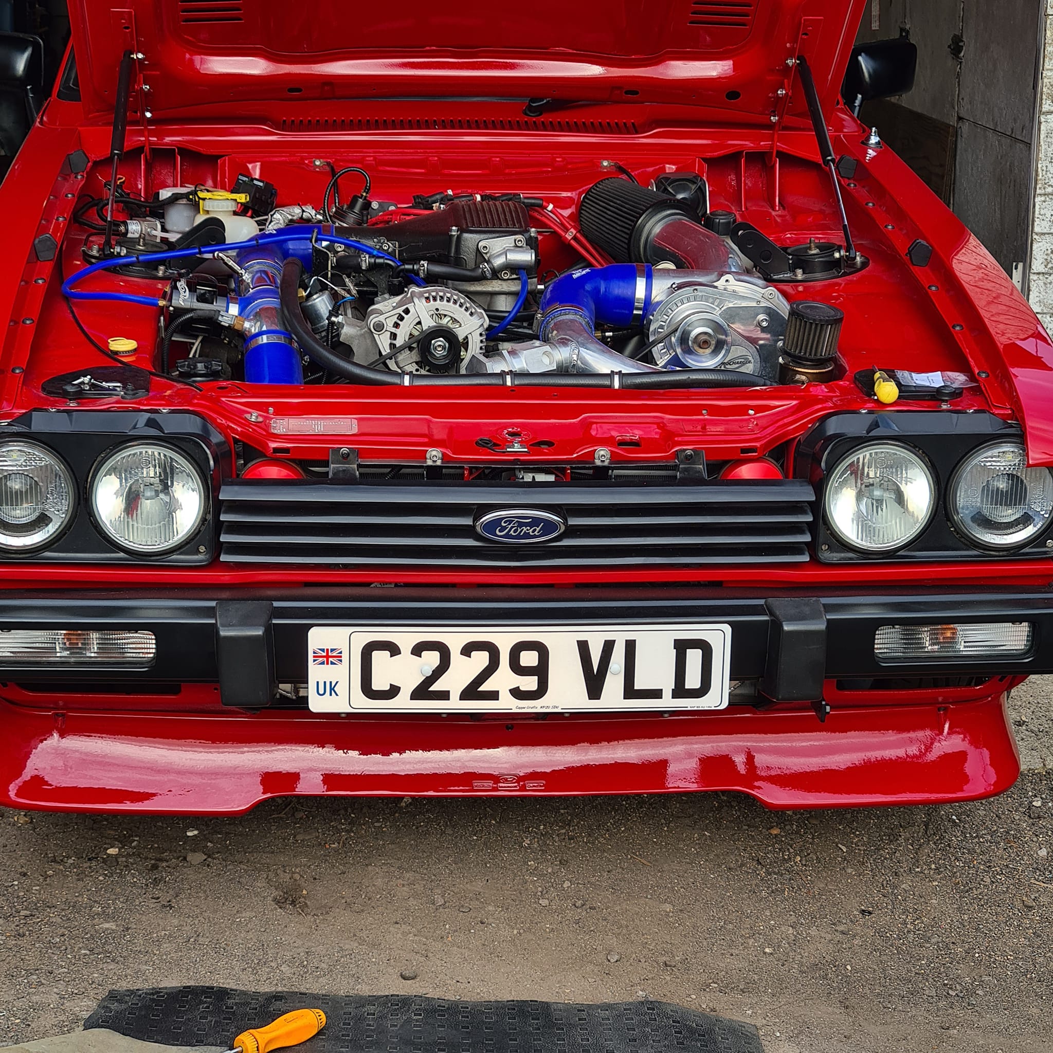

Car finally came back on the road in October 2023 after 2yrs away being restored,
Custom stainless manifolds and system built on the car in September 2023 by Rich's Fabrication Nr Grove Oxon,
My Sons ST Fiesta, My Daughters Swift and my Capri at a local breakfast meet in October,

Must feel good to have it back on the road. All shiny shiny
