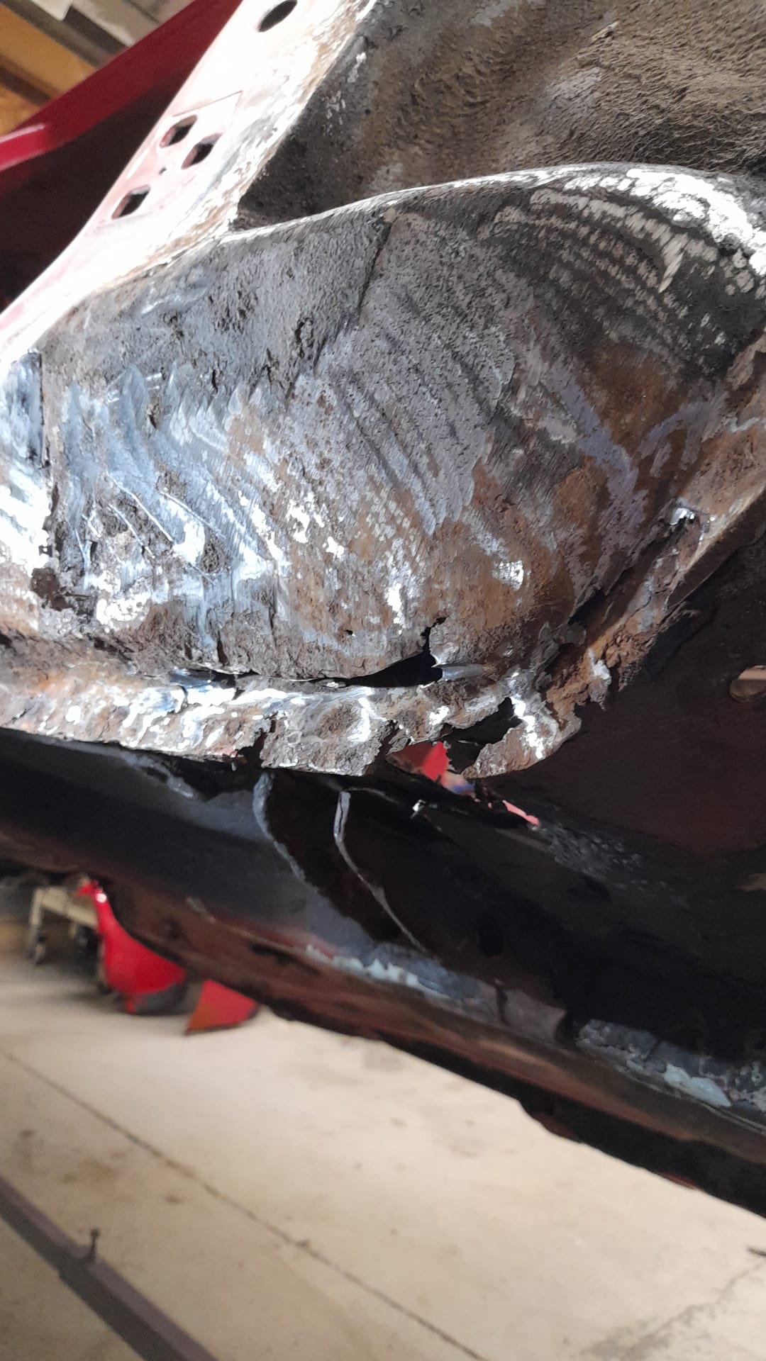

well we bit the bullet this year (late 50th bday present) and had the shell sent away for restoration, scary whats found under seemingly good paintwork etc,

Current state with the car as of yesterday after 5 months of panel work :(

Not cheap to do by any means, but needs must. Rust just gets everywhere ! Hopefully that'll be it sorted for many years to come.
Ideal time to sort arches etc for additional tyre clearance where necessary.
I did a lot of repairs to mine during the lockdowns, seemed ideal time as nowhere to race etc. But trying to cut out old rust and replace is just a nightmare, even more so when some was around the caged areas.
I didn't go as far as a full strip down though.
That's major work there !
It always worries me that even the most skillful repairs will not last as long as when Ford built it in the first place. Getting the right paint, getting it to stick, getting it to seal against moisture, etc. etc.
Dunno what the answer is though (apart from have a Land Rover where it can all be replaced!).

I think a lot relies on ensuring all work is done in a clean, warm, dry environment. And also treat any rust with a suitable rust killer...that isn't always so easy though.
I injected stuff into the sills, and gaps etc I could find. Hopefully it will help, but time will tell. I know there are some areas under paint I should have done better, and already just over a year on a few bubbles are re-appearing. Not structural, but very annoying. But my garage is not heated, and over winter whilst dry inside, the atmosphere can be damp. All this was before painting, although I did have a lot of it done with epoxy primer.
Under some rusty bits under the scuttle/wing are where there were multiple layers of metal, some actually were full on bare steel. Just trapped from new, and they were still like new. Outer layers were bad though

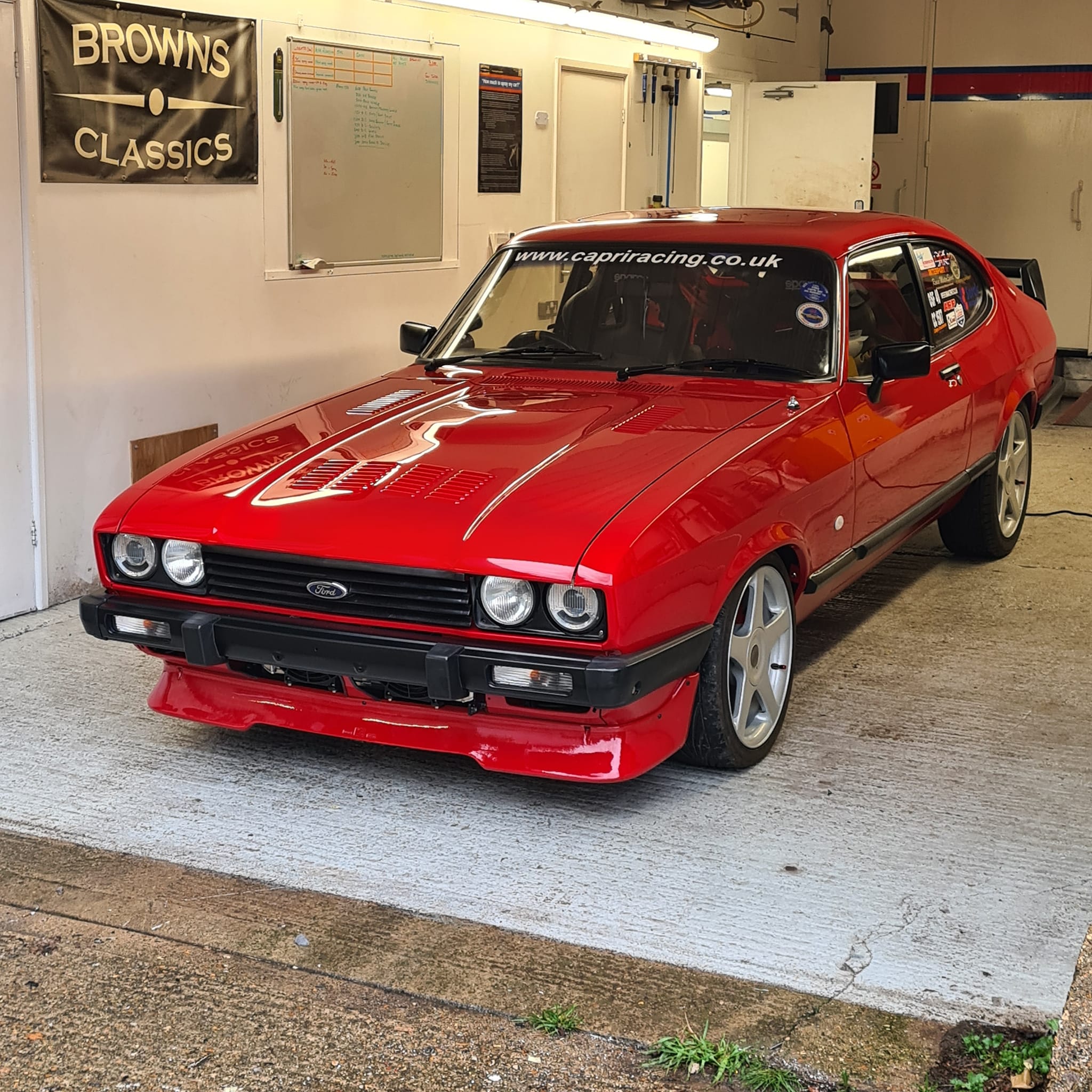

Car finally came back on the road in October 2023 after 2yrs away being restored,
Custom stainless manifolds and system built on the car in September 2023 by Rich's Fabrication Nr Grove Oxon,
My Sons ST Fiesta, My Daughters Swift and my Capri at a local breakfast meet in October,
Posts: 4078
Must feel good to have it back on the road. All shiny shiny
