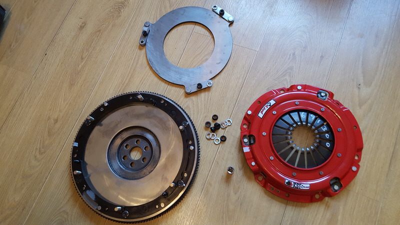

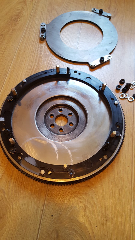

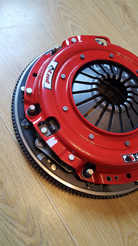

Flywheel has now been machined and had the RST adaptor fitted, balanced and returned back to me,
[attachment=0]c4.jpg[/attachment

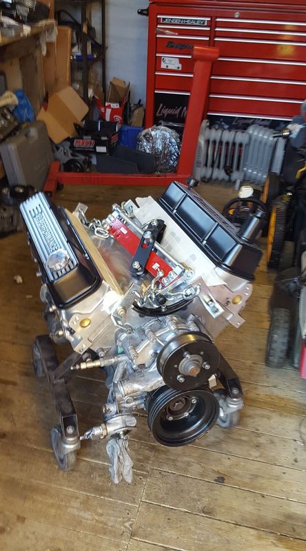

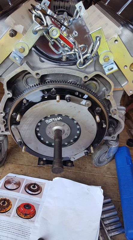

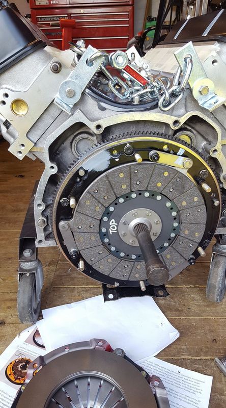

Rossco wrote:
Well after 2yrs its time for the engine to divorce the engine stand
First plate and adaptor fitted to flywheel

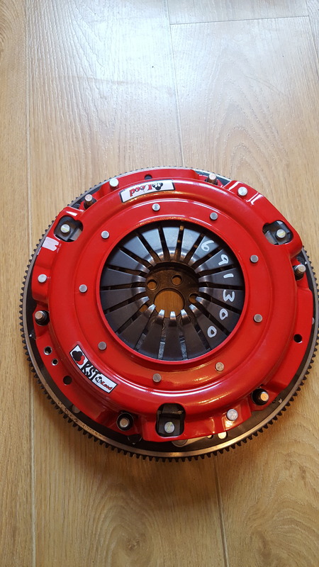

Second plate fitted and lined up,

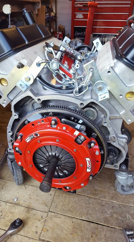

And all finished,
And all finished,
sure is mate
- Posts: 4111
makes moving the engine about so easy lol,stevieturbo wrote:Of all the things....I'm kinda liking that little floor trolley the most ! lol
Like a go-jack for an engine
can move it from the shed to the car in the garage down the garden no worries at all lol.

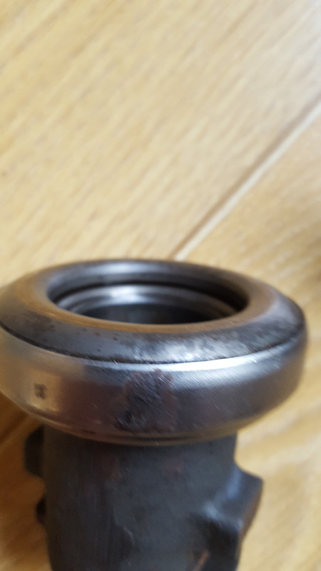

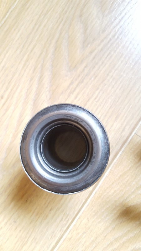

Right guys need some help as I'm getting myself so confused now,
am I correct in thinking I need the flat faced self centering bearing to go with this RST cover plate and not the domed type bearing face one I have sat here from my old clutch???
- Posts: 4111
My current one:
you recon that will work ok then stevie?
- Posts: 4111
Again, place it on top of the fingers and see how it looks.
The bearing will only travel say 10mm so there isnt a huge range of movement. If the fingers are fairly close to the centre of the bearing then I wouldnt have any concerns.
The bearing they ( not McLeod ) sent me for my clutch has me more worried...but it's working lol
If the flat part of your raised fingers where either too close to the inside or outside of the bearing, then I probably wouldnt be happy with it
