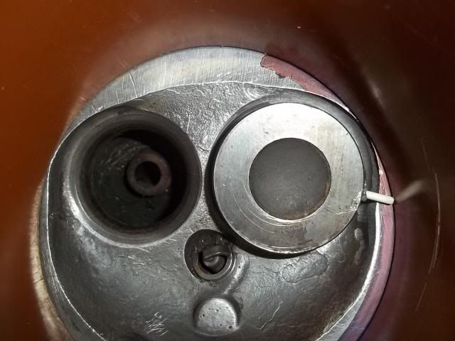

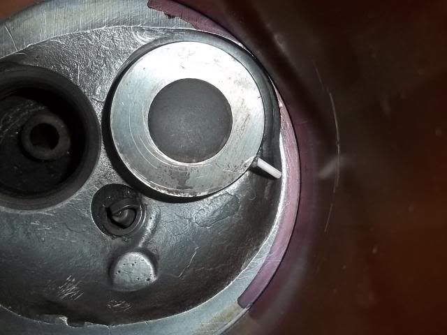

First off lest get the necessary tools together
Something to test - at a reasonable size - it's a later head but not with waisted stems and one of the odd ones with the exhaust gas port things I wish I had a band saw.
A couple of bits of scrap to work with.
Look at the amount of carbon in here
The one we will start with first
And a choice of valves
The standard valve and that silly ridge
An open flow test with nothing in the port just to get a datum
The first parts in the port that need to be removed - no changes to the seat internal diameter at this stage
Thats got it started - see if i can get it progressed during the this week
A I have a base run with the standard head and valve
B run with the waisted valve with a cut back
C run with the waisted valve and a basic port blend std seat id at 34.7mm
D run with the waisted valve and the insert taken to 36mm and blended
Just need to combine the graphs.
But here are the flows at 450" - @ 28"
Open - 141.5
A= 134.5 cfm
B= 137.0 cfm
C= 138.9 cfm
D= 137.1 cfm
None of the porting work at present extends further than 3/4" into the port
