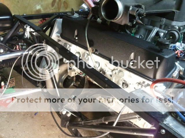

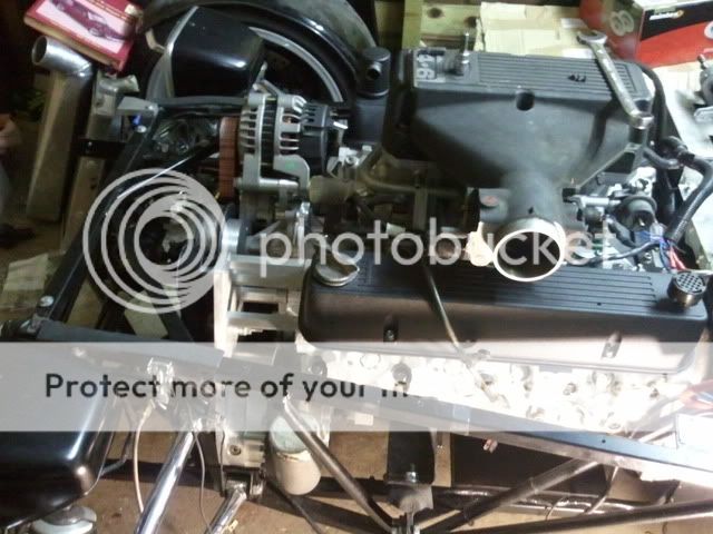

If you have space at the side below the exhausts you can mount a standard rotation SC back a little so can still be done with one belt.
Posts: 4079
Good job !
