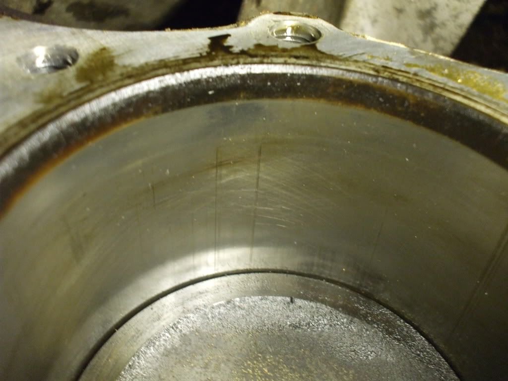

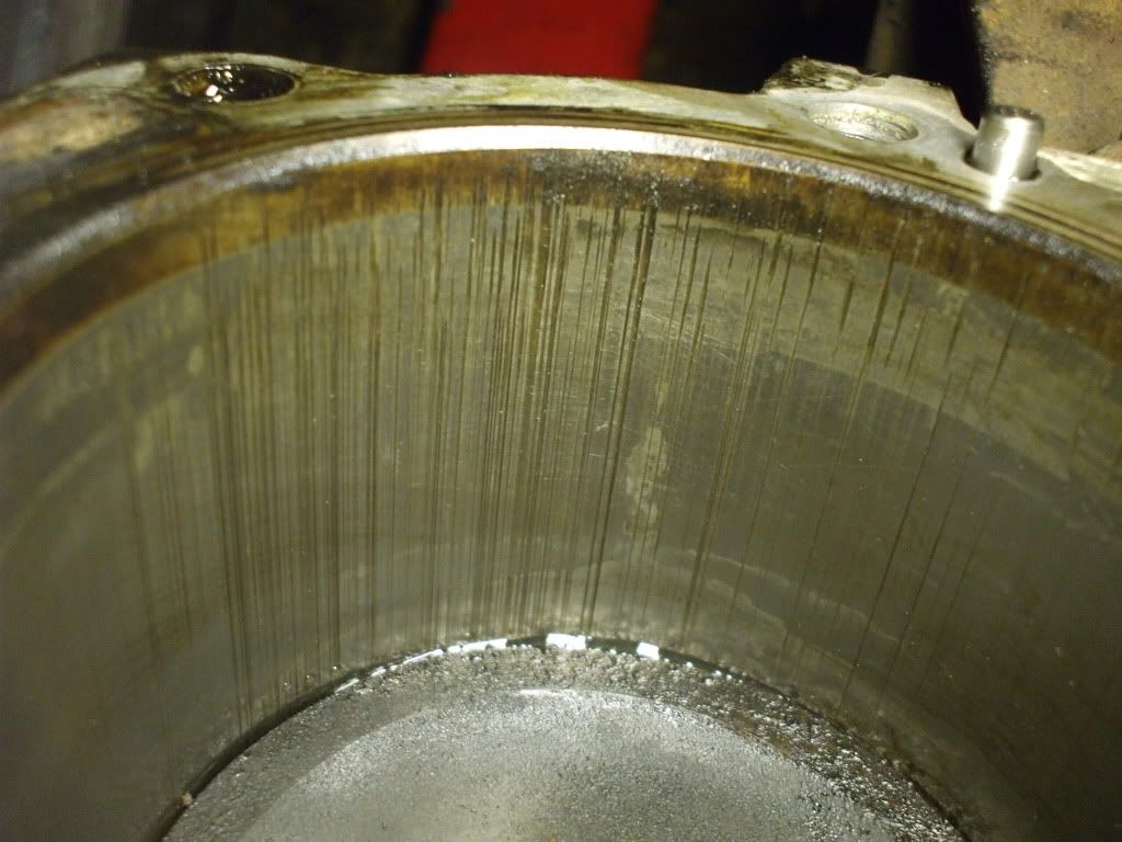

Hi All
It looks like bad news to me. just poped the heads of the 3.9 that i will say now was running up the scrappy and sounded sweet and was burning no oil!
and found the folowing doom and gloom what the hell has caused this? number 1 has the score and its deep may just come out with a 20tho rebore number 2 looks like its had sand in it? and 4 looks like its started to score but would hone
Whats happend here? any ideas? rebore time i recon.. :( :cry: :cry:
Any body recomend a good engine rebore place in kent? close to maidstonewould be good.
Thanks again
Derek :cry:
Rust rust and more rust
Certainly in the secong Photo it looks like the top ring has broken up, from the pitting in the piston crown I would suspect detonation. having said that a rebore will sort it, and it is a good opertunity to get the deck faces squared. As for who to do it, turner engineering are good, Owslebury crankshafts in Winchester are still going after more than 50 years and I think atleast 1 person on here has used them, I am sure there is someone near you who does V8 work to a high standard though.

kiwicar wrote:Hi
Thanks Mike
I have just made a few calls and found what used to be rovercraft now called Evandan Engineering and there only 6 miles away from me
Quoted £148 +vat for a rebore and the hone with a dip clean.
they will also inspect the crank pluss refit the new pistons on the old rods for me.
I will strip it right out tonight and see what has happend to the pistons.
Thanks again
Derek
Hi Derek
£148 +VAT sounds like a good price to me! Its nice they are so close too.
