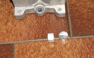

Right, liberated it from the not-entirely-useful Ali welders.
Here's the plan:
1. Take a Thor manifold and drill some holes
2. Make up some plugs
3. Weld the plugs into place.......
As you can see, it's the welding part that is proving elusive.
I realise it's going to be tricky, and I fully expect to dress it with a die grinder afterwards, but I really need those plugs welded in so I can tap them out for my LPG injectors.

Chris, why not simply fit the lpg injectors into the lower part of the manifold, next to the body of the petrol injectors, at 90 degrees to the manifold? Simple, straight-forward and no issue as you are firing a gas into a gas, not a liquid that can wet-out on the manifold walls. You won't achieve any difference in running quality or bhp by going down the route you're taking here.

you can't get the torch down there.
Assuming the holes are true and round (they look like it) make some oversize bungs with a top-hat on them. Press them in, cover with ally filler (devcon) and then dress with a die grinder from underneath.
I've seen a telly program where they fitted gas to one of those manifolds by simply drilling and tapping (about 6mm size) - is that the same as what you are trying to do?
what does it look like underneath? - you may be able to get a tack weld in there.

Badger - there isn't room to go adjacent to the normal injectors, I did look at that, and it's completely inaccessible under there. The fuel rail and injectors completely fill the void under the inlet pipes. You are also supposed to get the pipe between injector nozzle and injector valve body as short as poss......
Ta for the heads up on the relationship between LPG injector & petrol injector - I was aware and I think I've sussed it out. The instructions are quite pedantic on that point!
Underneath is even less accessible. Isn't there an ali-welder technique that has a mig-type torch?, if the material was steel I could mig-weld it no problem at all. There must be some 'craft' type ali welding processes.
What about brazing or soldering?, is there anything like that?
Thanks,
