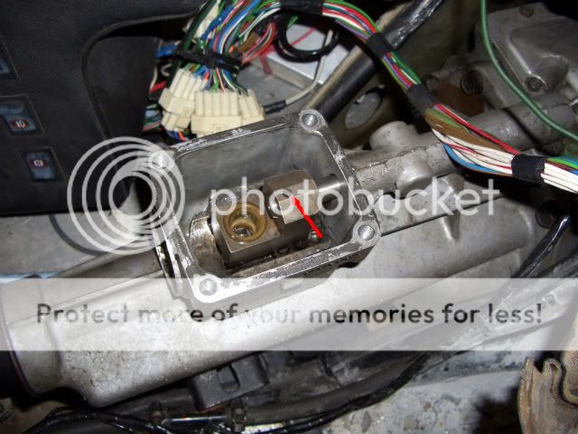

This shows the gearbox tail housing in the car.
The red arrow points to the dowl pin hole in the offset lever.
I did manage to drift the pin down but that is now the problem. I think it is catching underneath on the indents. The manual says to drift the roll pin down, (which i've done) then remove the offset lever WITH the tail housing. :oops:
Unless I can get the dowl pin out, by some how pulling it up or driling is I think I will have to take the engine/ box out, to remove the tail housing from the gearbox along with the offset lever to then re-build and re-fit the dowl pin!
Might teach me RTFM first!

looking at that, I would guess the tal housing needs releasing from the box, pulling back, that will probably give you the underside clearance you require
THE SMOKING GNU
Yes, I think the tail housing AND the offset leaver need to come off and go on together.

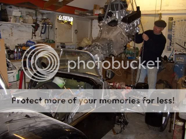

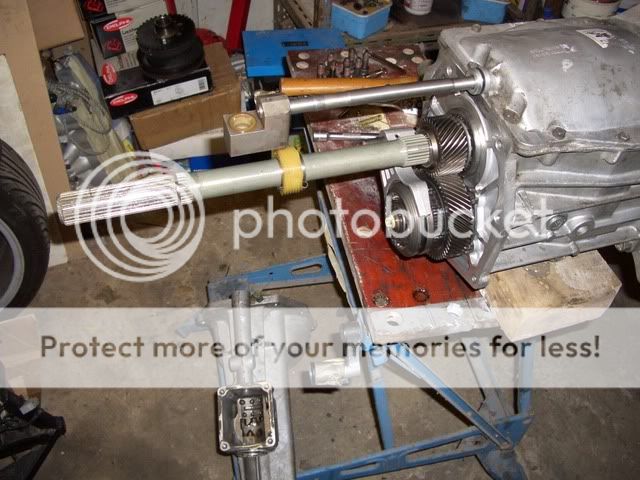

Well engine's out, Quite daunting at this height!
This shows the reasom the offset lever can't slide off the selector rod.
Note to self:
Don't drift a roll pin without being 100% as to where its going!!!!
Atleast i'll be able to neatly weld an extension on.
