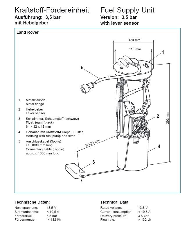

That bosch number is a universal in tank pump that fits many applications and should work fine, the ESR3926 sender unit can be found in both Discovery 06/94> and defenders 09/90> so should be easy enough to get hold of. PRC9409 may be the same or similar, here is slide of the VDO made part that may be of use to you. (VDO pn X10-736-002-016)
