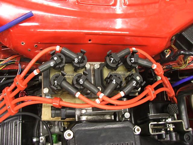

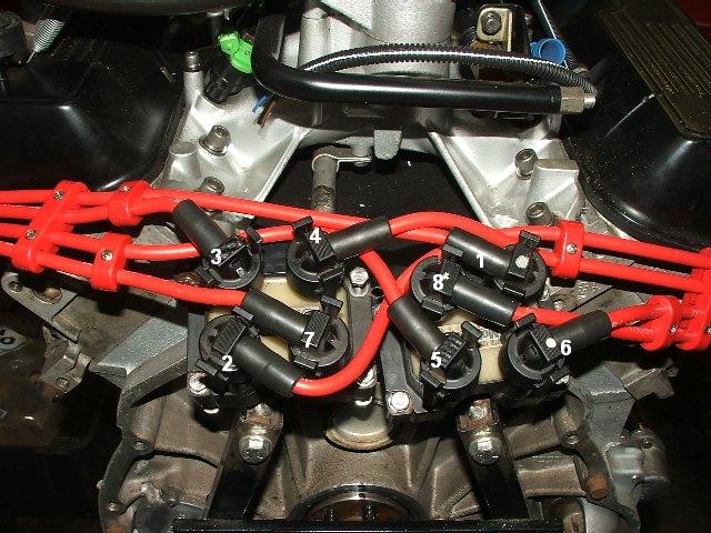

been playing around with the lead layout to try and make them look tidier,
originally it was like this:
firing order 18436572
so on wasted spark cylinders
1-6 fire when opposite each other on the coilpack
8-5 fire when opposite each other on the coilpack
4-7 fire when opposite each other on the coilpack
3-2 fire when opposite each other on the coilpack
which when on coil packs look like this yes?
which looks untidy i thought,
so i have done this
i swapped 8-5 over and 3-2 to make the leads more tidy, the firing order is still the same as still on the same coil banks
this be ok will it not?
as the leads end up sitting nice as below,

looking at that thread Ian im spot on 8)

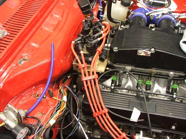

Tony,
Very tidy, even saved a pic so I can copy the layout when I eventually get round to setting up mine.
Kevin.

Lookin good to me as I spent quite a while trying to work out a cleaner way to run the leads and you have the best way. I did post a solution on here but it's all down to how many leads you want to cross over.

thev8kid wrote:hi guys,
Maybe DNB or Eliot can help with this one.
7-2 fire when opposite each other on the coilpack
dont forget cylinder 3 :P

If you rotate your coil packs 90' you will get a left/right arrangement as noted on the other thread we had about this.
