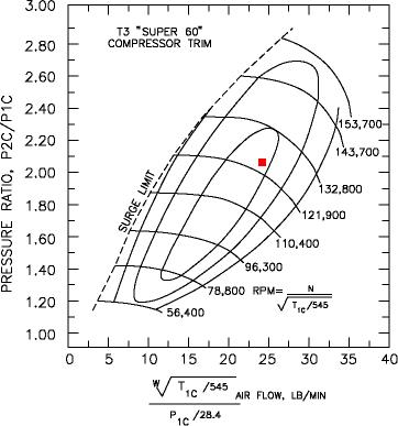

theres the map , you can roughly go 1 lb/min for each 10 bhp ,so its about 300 bhp at 15 psi worth of air for each turbo , ,then a bit more at higher boosts.they seem to max out at around 310 bhp on the cossies ,thats with the .48 housing .
shame the for sale bit was wiped off ,as this was all on there .

You can use this turbo calculator to work out the size for twins, you just need to half the number of cylinders - this is for a 4.6 at 6psi:
http://www.not2fast.com/turbo/glossary/ ... tyCycle=85
About half way down, you will see the option to plot the compressor map - select super-t60 - you will see that you are "on the island" at 5500RPM
Basicly plot it at low and high rpm, low boost and potential future boost and make sure you stay on the island and to the right of the surge line.
For the sake of history - i've saved the images:
So heres a 6psi low boost (stock engine) example:
3000rpm start of boost:
5500 max rpm: (~300-350BHP)
And the forged internals lower compression example:
3000RPM (you wouldn't see 15 psi at 3k rpm anyway)
and max rpm: (~400-500 BHP?)
So this compressor suits a 4.6 from low to mid boost setup - stick your other engine details in and see what you get.

eliot ,these t3's are 60 trim not super 60 ,in case theres any confusion.
