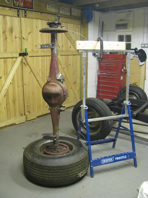

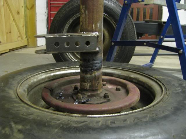

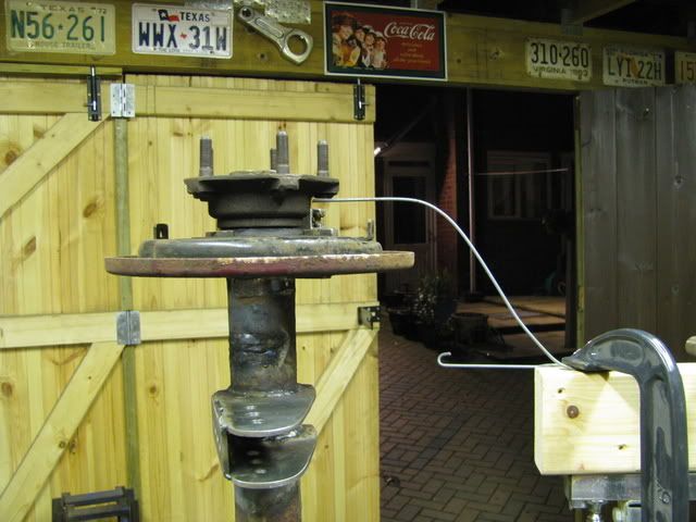

The Westy axle is a 3/4 floating design, which means the wheels rotate on bearings in the END of the axle, rather than just the axles run through the bearings. You can take the half shafts out, in a few minutes, put the wheels back on, and still roll the car about. Here is how I straightened my axle.
I bolted a wheel to the bearing flange, and stood it on end, then mounted a pointer. Rotating the axle now shows where the bend is, and a little heat applied at the bottom will pull the axle over. I did try a couple of runs of weld, but it didn't pull enough, so I got out the gas axe and heated a small area, about 2" x 1".
Back in the car, after some cleaning up, grinding, and a splash of paint:
