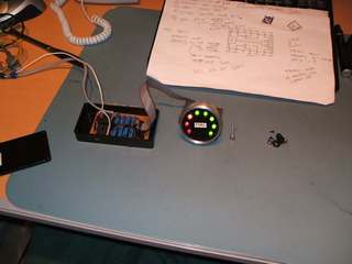

The petrol tank on my car isn't linear - in fact its triangular shaped, which means the smiths fuel gauge is meaningless. So I made a simple digital fuel gauge that is calibrated to the exact amount of fuel in the tank.
Easy and cheap to make - handy if you just want to know more accurately what's in your tank.
Write up:
http://www.mez.co.uk/ms13.html#fuelgauge

It's all a lot friendlier now. You have reminded me that I project I need to resurrect is a universal sender that can easily be fitted to tanks.

Im using a VDO tube style sender in my tank. Works pretty good with the Ford guage in my car ( I specified resistances at the time ). Although for some reason when installed, wont read properly abouve half a tank. If I remove it, it reads correctly throughout its travel...weird.
