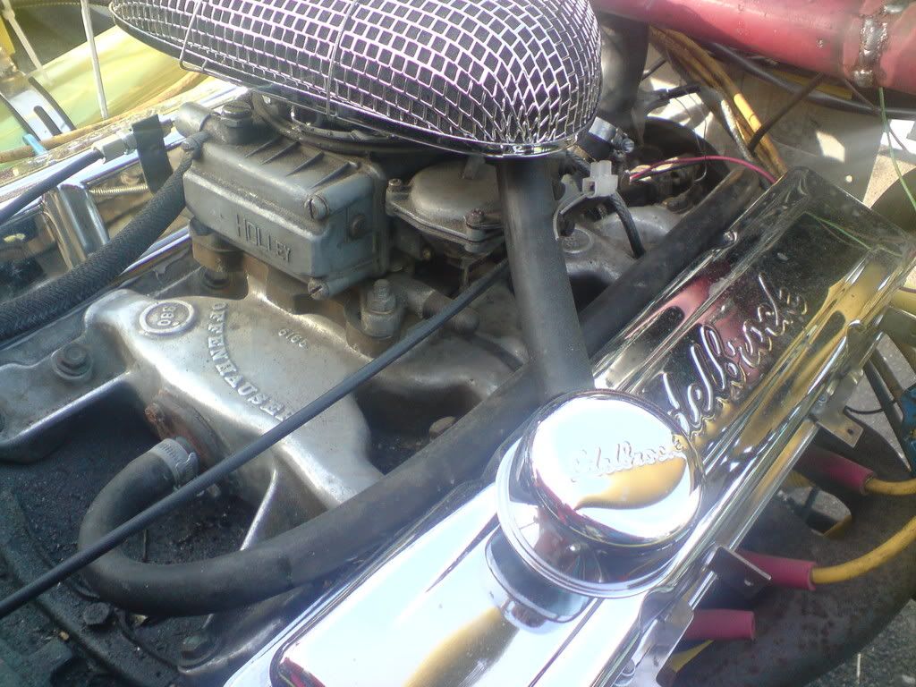

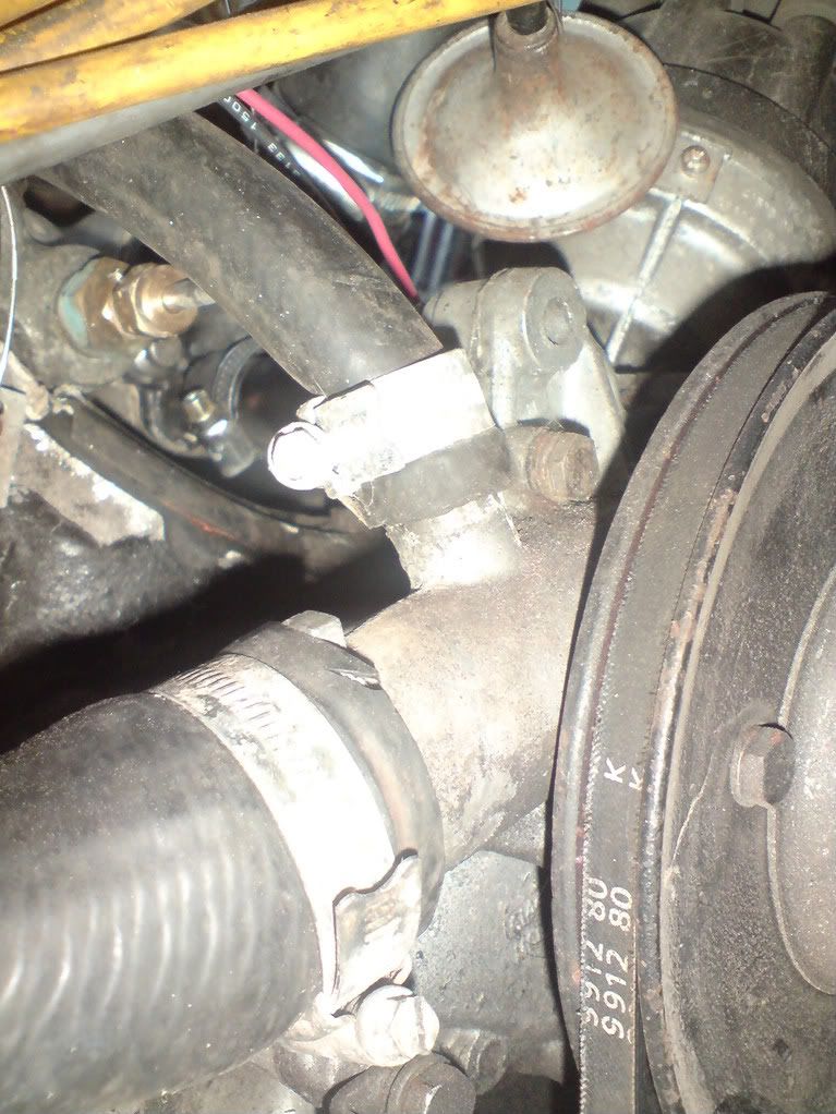

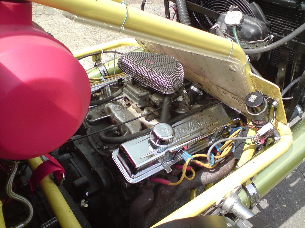

hope this helps, the perspex shield has been removed, cheers markImage
[/img]

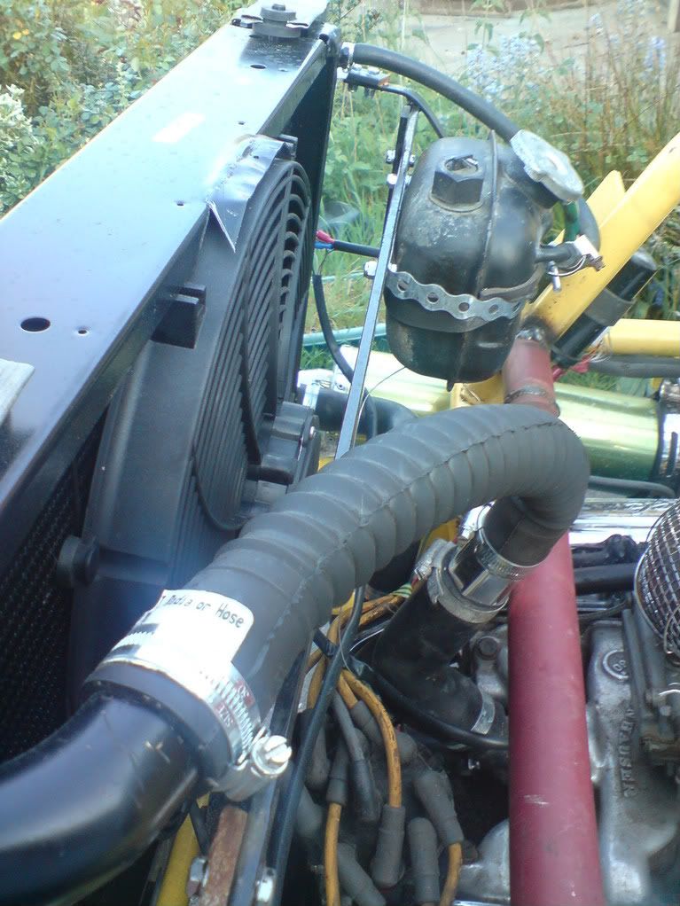

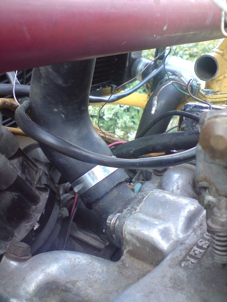

more pictures of manifold waterpump rad hoses I am going to replace the ribbed hose Image
[/img]

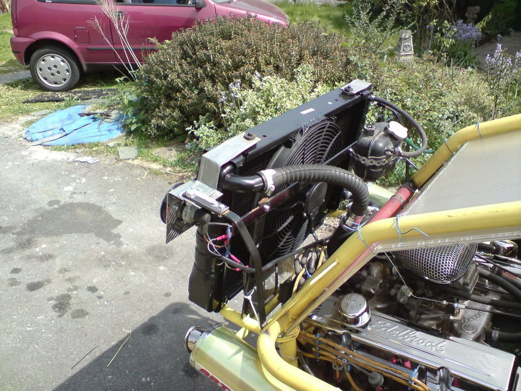

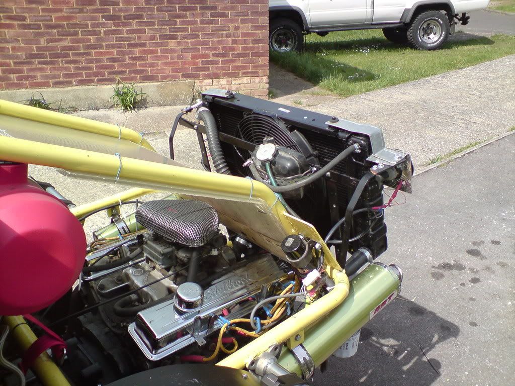

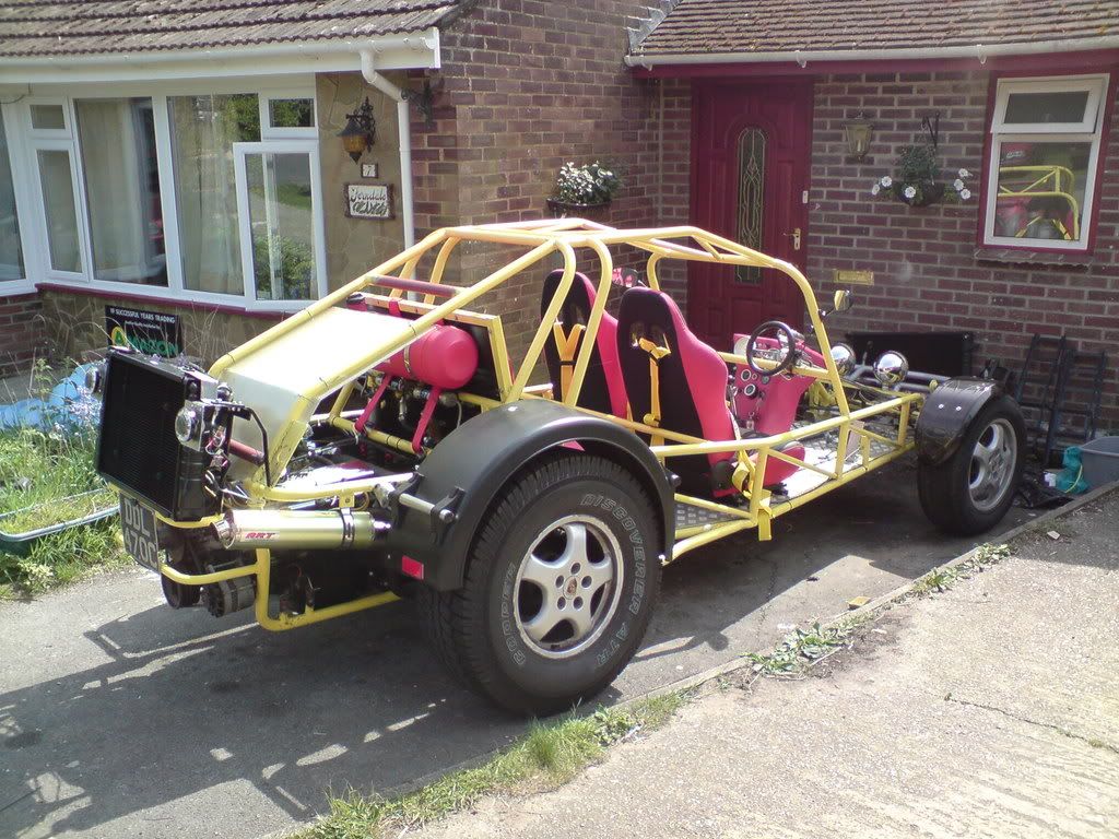

From what I can see it looks to be connected ok but I just cant see enough air getting through the radiator. Looks like you have fuel tanks and seat backs in front of it that will either stall the air in a vortex over the engine or just plain block any air. I dont think a fan on its own is capable of getting rid of all the heat from an engine under power. This might explain why it recovers stopped on idle which is what the fan is meant to do. I cant really spot any easy way for you to duct air to the rad and it doesn't look like an easy job to mount the the rad up front. Maybe look into some of the desert racers. I think they have their rads mounted in the back but horizontal. Maybe they can get some suction up through the radiator or something?

In Pic number 2 (big picture) you have a small pipe coming back in next to the pump
Where does that go? It looks about the size of the heater matrix pipe and this should be restricted to next to mothing (or blocked if you are brave but you could get trapped air) or the flow is from pump and bacl to pump without going through the rad
Think about it in the winter you would be running the heater full inside the car removing the heat from the system so no problem but in the heat woth no restriction you are just moving the hot water atound until enough manages to get through the rad to cool it.

Not in this application Ian. That pipe goes into the stat housing and is meant to and has to be like that or you get problems. Its a different system to the injection and aids coolant to circulate while the stat is closed saving hotspots in the engine. Coolant flows all the way through these manifolds and not just the front like injection manifolds.

thanks for the help, large picture 1&4 shows small pipe from thermostat housing connecting onto back of water pump, large picture 2 shows return from rear of manifold connecting onto water pump return, would it be worth while fitting an adjustable valve to restrict the flow on the return pipe

it already is restricted to a point its just a smallish hole under the housing.

the pictures help,
i would try removing the bottom part of your plastic cover ,the rad is not in a direct air flow,you may also have to build a cover/shroud to direct the air into the radiator.
Andy
3.9 V8 Mini Van....THE BEAST
If you moved the radiator up and forward so the bottom of it sat on the cross bar and angled it forward to about 45 deg and made a duct around it to enclose the whole thing. using the existing pannel as the bottom of the duct. With the opening at the front verticle you should get good flow thwough the rad from air comming in over the drivers head. It will get in the way of the view from behind but i suspect you won't care much about what is behind you, after all you will have just passed them and they are going slower than you. If you flair the front out a bit then this will help too.
