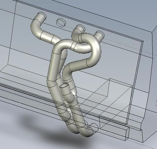

I was starting to think about headers, particulally merged collector and the bits to do an 8 to 2 to 1 to 2 with crossover primaries (but I will start with the collectors. I started making it up in 16G mild steel but I have been thinking it would be better to do it properly in Stainless. If it had been a case of TIG welding only and it is like soldering wet pasta then I would have stuck to Mild steel and coat it but if I can do a decent job with MIG and an extra bottle of argon (and some Jigs) then I will buy some stainless and have a go.

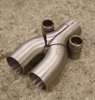

i started miging up a SS exhaust, but that stoped as im using a different type of engine now (v8).
as ssaid i had 0.8mm ss wire and CO2, as its cheap, its not that pretty but it does not rust and it just same as mild, the only real difference is stainless steel suffers alot more with heat distortion, i will put a p[ic up of a collector i made tiomorrow if i remember.
Ralph
Hi Ralph,
pictures would be great.

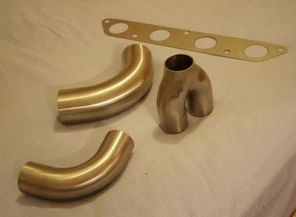

i will be making another soon onec V8 is in and working, anyway heres where i got to before.
Ralph
Posts: 4081
Ralphh85 wrote:
Ralph
Very nice work !!!!!!!
