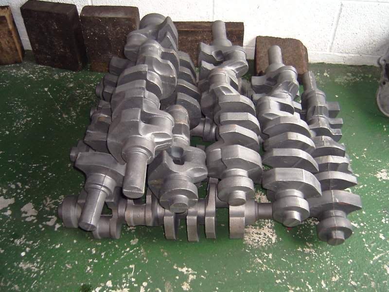

The v8 tuner kit is ok and it's cheap but you say you want to build better. How much better?
I have a custom crank casting from my own patterns. It strokes from 86 to 94mm, takes stock chevrolet rods and they're cheap
Buy your own pistons, resleeve to 96mm and you can have a 5.5 rover. The crank will fit an early or late engines and comes with a long nose. It's also fully counterbalanced likesome tvrs. The v8t crank is just a 4.6 item offset ground.
The downside with my cranks is they take ages to get machined but I may have found a solution.

What more can I say. The rod journals are slightly wider so they accept a chevy rod, 2" or 2.1" depending on how much you grind off and the offset. The mains are 2.5" but can be ground down to 2.3". It has counterweights opposite all the rods. It has a long nose which I can shorten. I get them cast in SG nodular iron and they can be heat treated etc as well.
I'll try to upload a picture of the raw castings.
Boosted.
