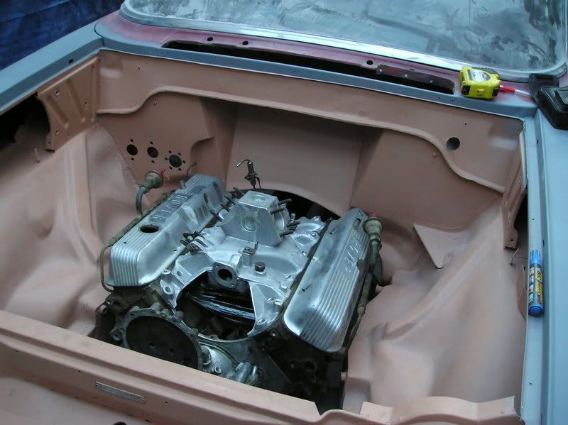

Currently rebuilding a Mk 1 (1963) Humber Sceptre and installing a Rover V8 - long way to go yet!

Time for some more pics:-
Wheels chosen and wing vents fabricated
Transmission tunnel under construction

ChrisJC wrote:Like it!. Looks like plenty of room under the bonnet.
Space is actually very tight either side of the engine - I'm not looking forward to making the manifolds and finding room for the steering column....

My mate has a Mk1 sceptre as his everyday car (has been 4 the last 15 yrs) he looked at a rover in it but the chassis rails sit up high and close in and and u sed make manifolds very hard and the draglink that runs across the bulkhead an issue, will be intersting to c how this turns out. :D

As for the steering - the old box will be ditched in favour of a rack which will free up some space and solve the drag link problem...

The gear lever will be replaced with a shortened remote - working on that at the mo...

Mini update - Bonnet vents now fitted (courtesy of dead Vauxhall Astra GTE)
