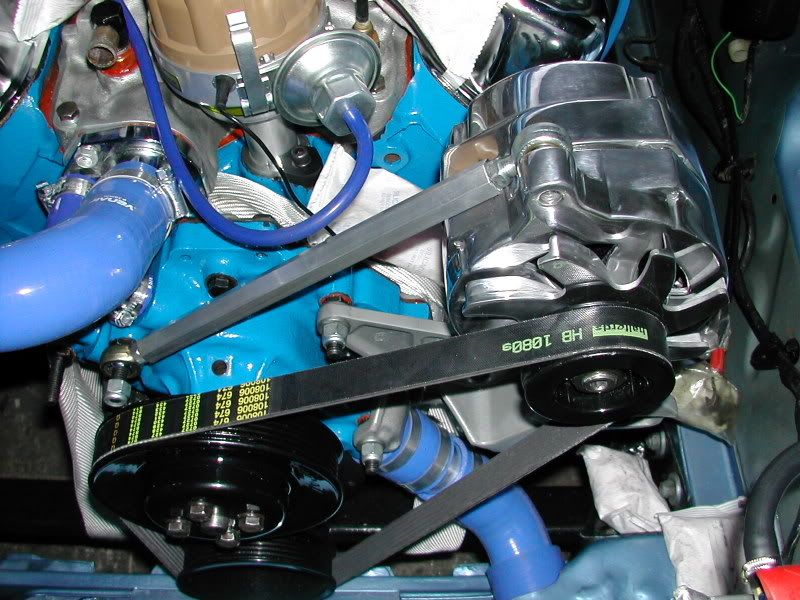

And here's my new Billet, High output Alternator that i've got for the capri too:

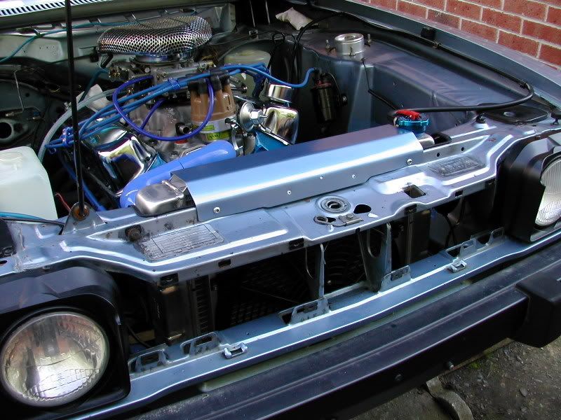

Well guys, after promising myself i'd do a photo update for a few weeks, here you go :lol: , the rad and fan are now fixed in place and so is the homemade rad cover too:
Next up, the oil cooler.

Hi guys, just got abit more done, fitted the Electric Fan Controller and partially wired it up, also fitted the new alternator too:

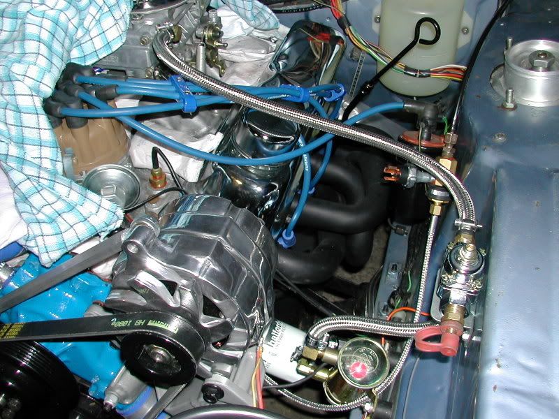

Got 90% of the fuel line put in place this morning:
Brake servo in place:
Middle section of exhaust:
And spent the last hour of todays daylight fitting the fuel pump, filter and every fuel line other than the Nitrous one.
