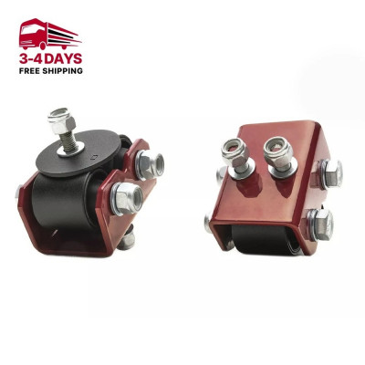

Or you want something more rigid, this style of mount with 2 rubbers is common for Jap vehicles. Whether nylon, or using 2 rubbers. Some look like leaf spring mount rubbers, that sort of thing

Posts: 4101
Re: Rover engine mount rubbers
pic here

Thanks for that, those sort of things look ideal and even better, they’re something I can make instead of buying.

Doubling up like that should allow you to make them very stable.
Up to you whether you opt for a nylon or rubber solution.
As said, some leaf spring bushes look like they might be usable, or something like this ( depending on dimensions )
