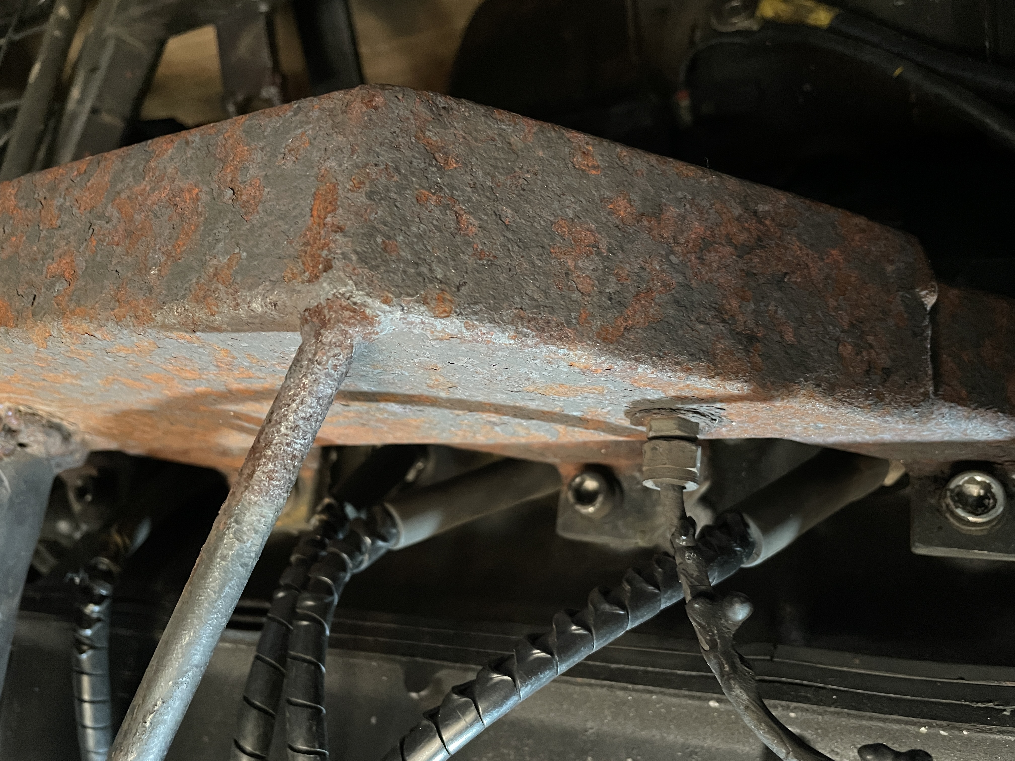

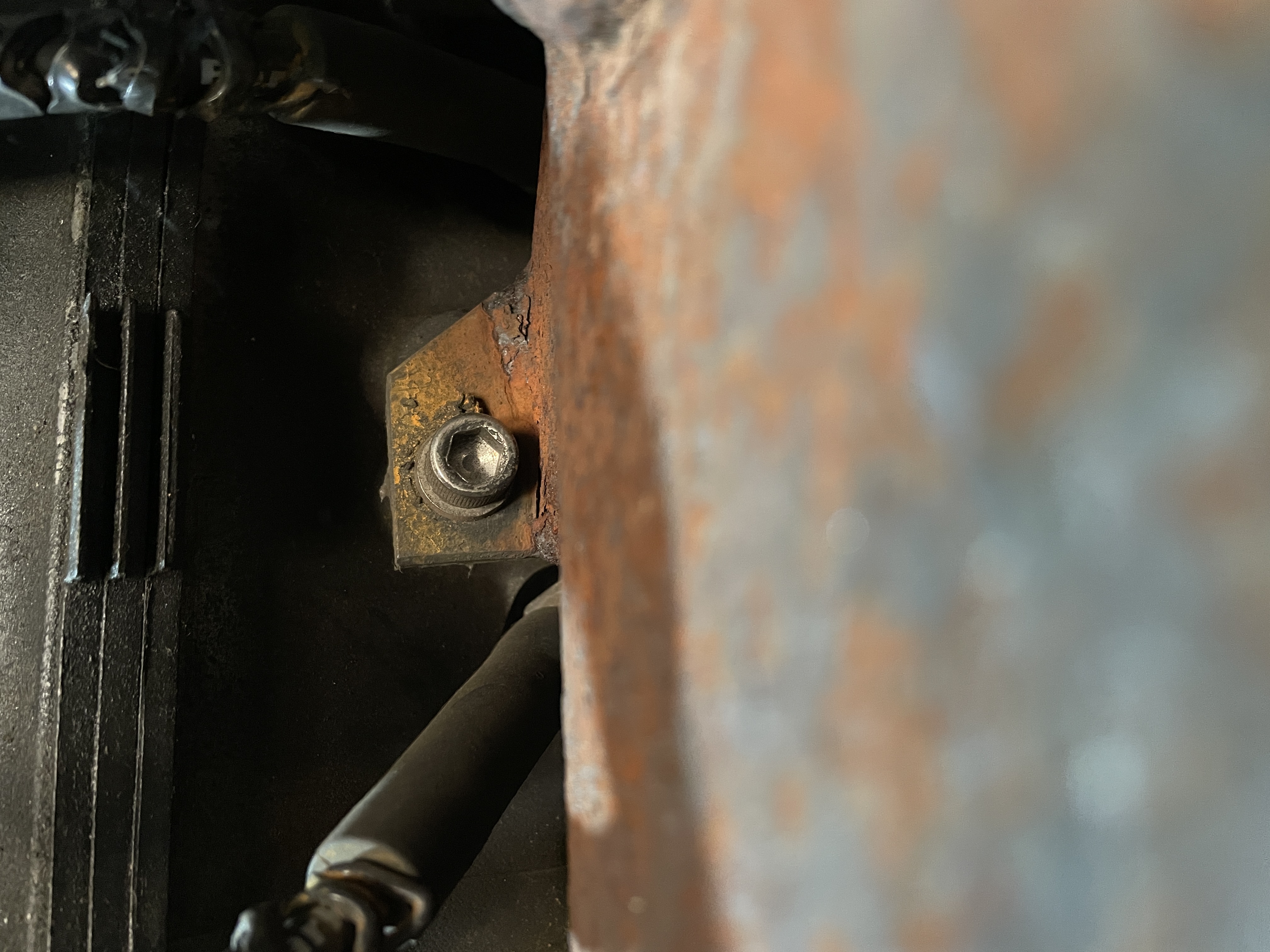

This is one of the reasons I went to studs instead of bolts
Re: Rover exhaust thread repair
Yes, studs are definitely preferable but there isn’t room to turn nuts or bolt heads on my exhausts hence I’m using cap head bolts.
However I have a cunning plan to make 16 off 3/8” UNC internally threaded tubes the same O/D as the cap heads and screw a cap head into one end so I can do them up on studs.
I haven’t checked yet but I’ve been told there’s a high temperature loctite that works on exhausts, this would keep the studs in the heads and the cap heads in the threaded tubes.
Edit - I don’t know what I’ve done wrong here, the first pic is upside down and the second is sideways???
