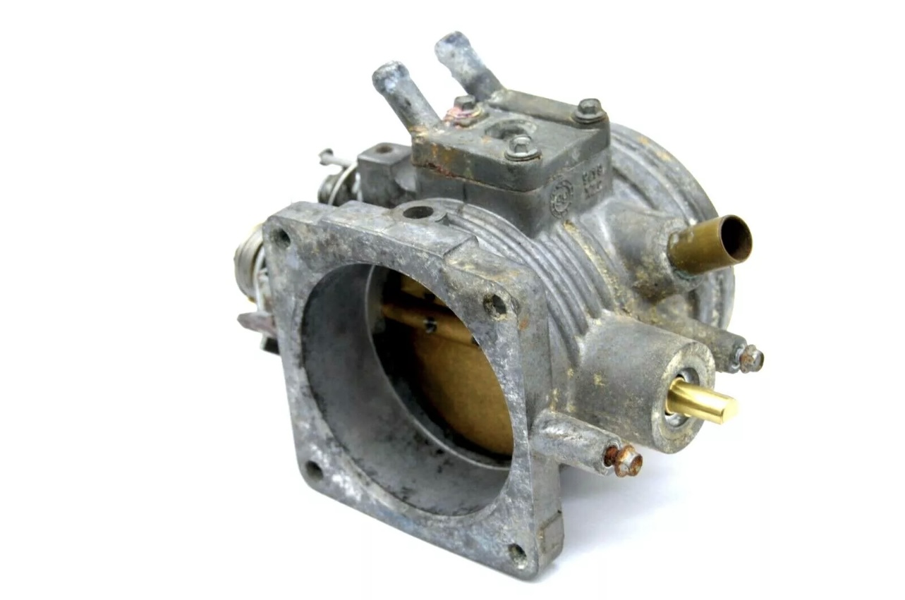

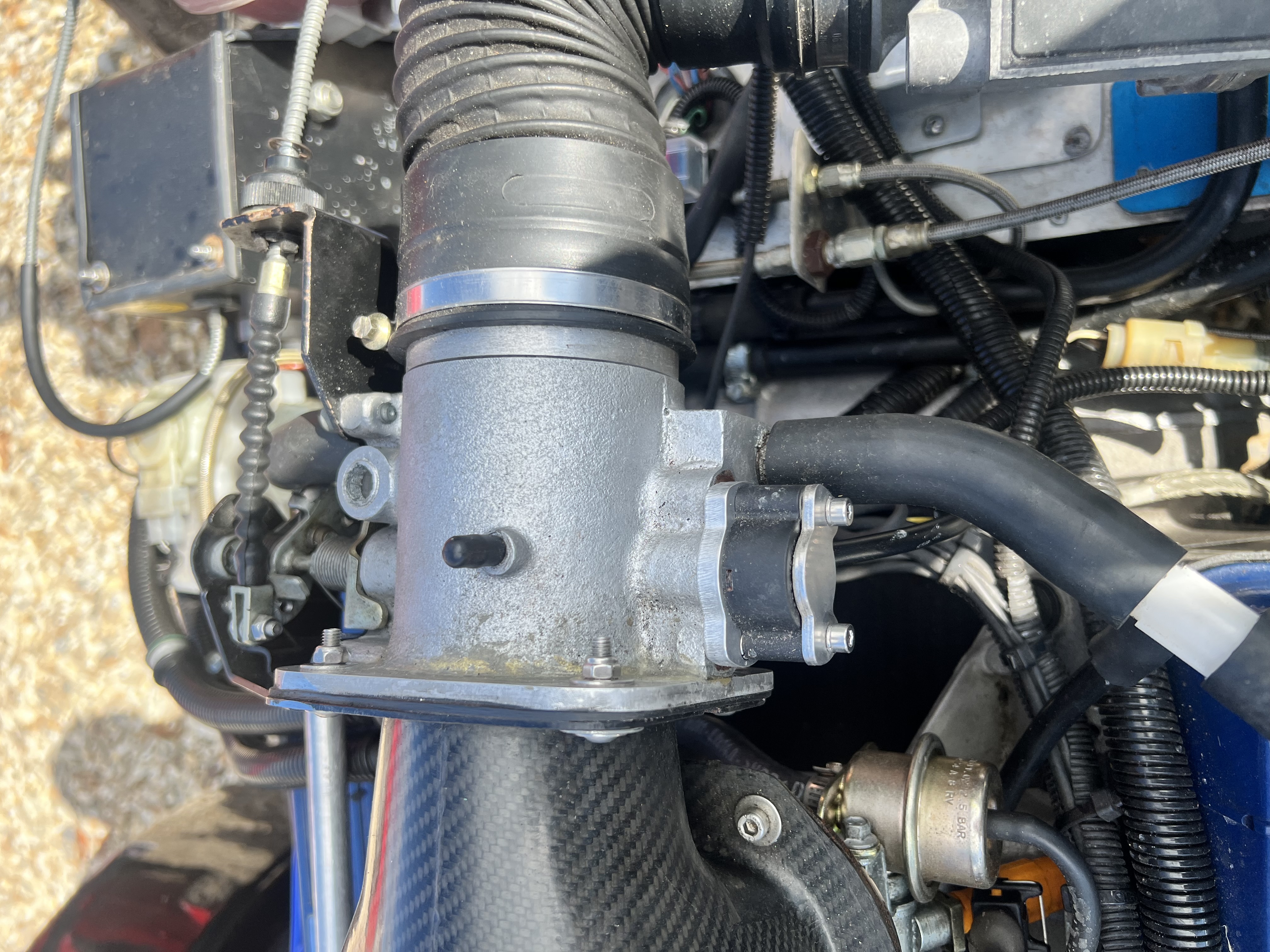

I’d like to swap the “bespoke” throttle body (bodged 3.9 TB, cut from 3.9 plenum) on my Rover V8 single plenum setup to something off the shelf.
I’m looking at a Thor TB but it uses a different TPS, does anyone know if I can get the Thor TPS to work with my 14CUX ECU?
