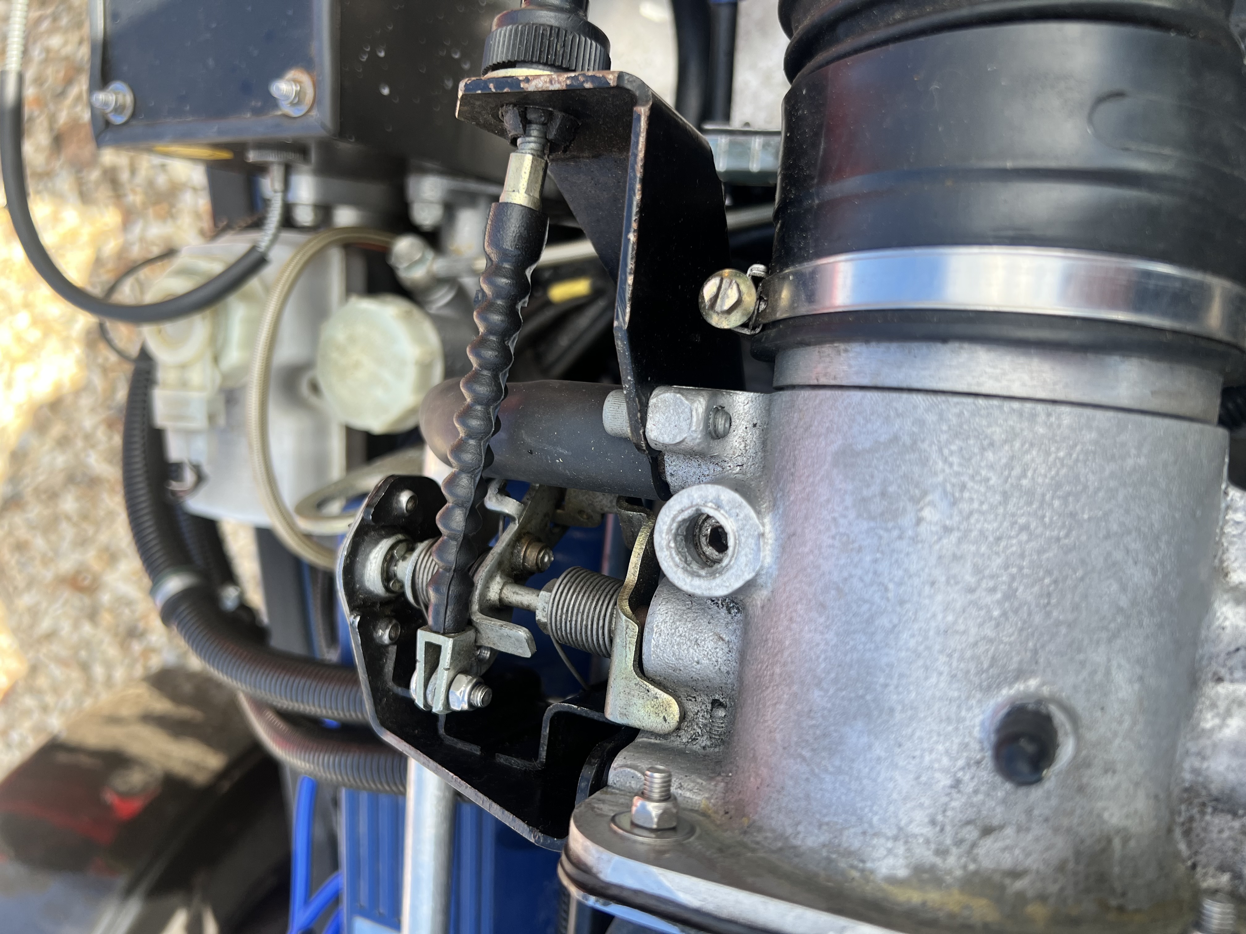

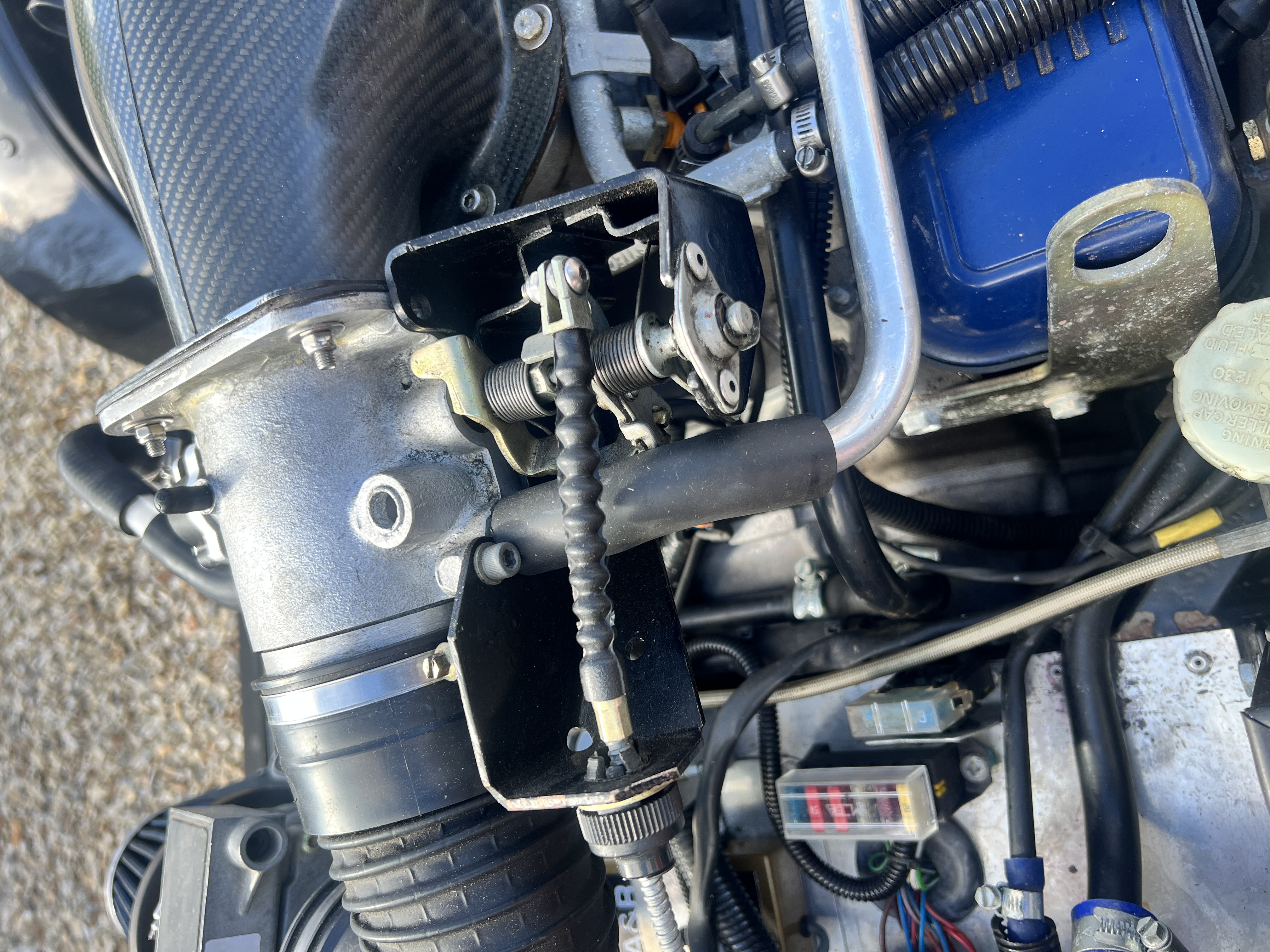

Hello,
My first post here, looking for help with my Westfield Seight. It’s fitted with a Rover, JE rebuilt, 3.9 V8, Lucas ECU, Tornado chip, single plenum/throttle body.
I have an issue with the revs hanging and it appears to be the throttle linkage is not fully closing when the pedal is released. What’s strange is this problem is only there when the engine is running. With the engine off the linkage closes with a decent snap so isn’t snagging or binding.
Can anyone help?
Thanks,
James
Can anyone help?
Thanks,
James

I have a completely different setup (4 barrel TBI) but similar symptoms. It felt as if the engine vacuum was holding the throttle open. I put a second return spring on and it seemed to help.l

Thanks for the help. I replaced the ICV, disassembled and cleaned the throttle spindle/linkage, reset the TPS and fitted an additional return spring. Hanging revs are now sorted and idle is much better, however I also did a smoke test which has shown up loads of vacuum leaks so that’s the next job.

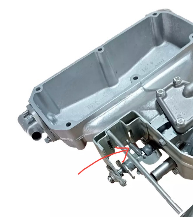

Can I ask which/what spring you fitted additionally? I'm now having the same symptoms with my SEiGHT.

I used this type as I had one spare:
https://www.ebay.co.uk/itm/386058589358 ... media=COPY
This is what it should look like:
