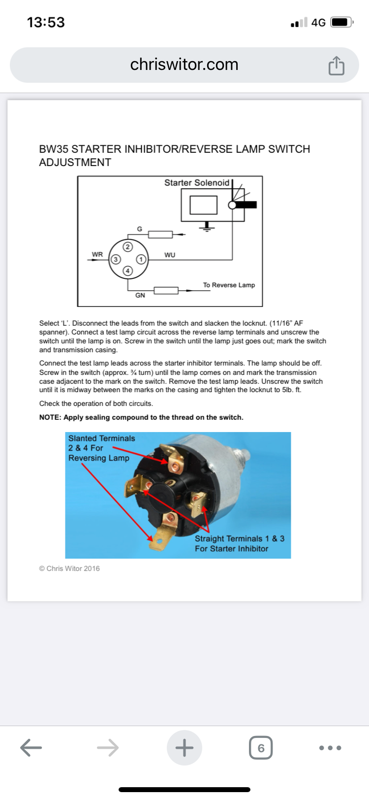

Hi there does anyone have a quick and easy wiring diagram for the 4 prong switch please?
The original loom was butchered and switch not in use, fitting a rebel 9+3 loom and want to wire the switch in to prevent starting in D and also having some reverse lamps.
Found this diagram online

I bypassed the switch on my BW35 - just connect 2 wires. Reason for bypassing - the switch fitting leaked like a sieve so it was used as a plug - filling the internals with epoxy liquid metal. Easier to remember only start in Park or Neutral
