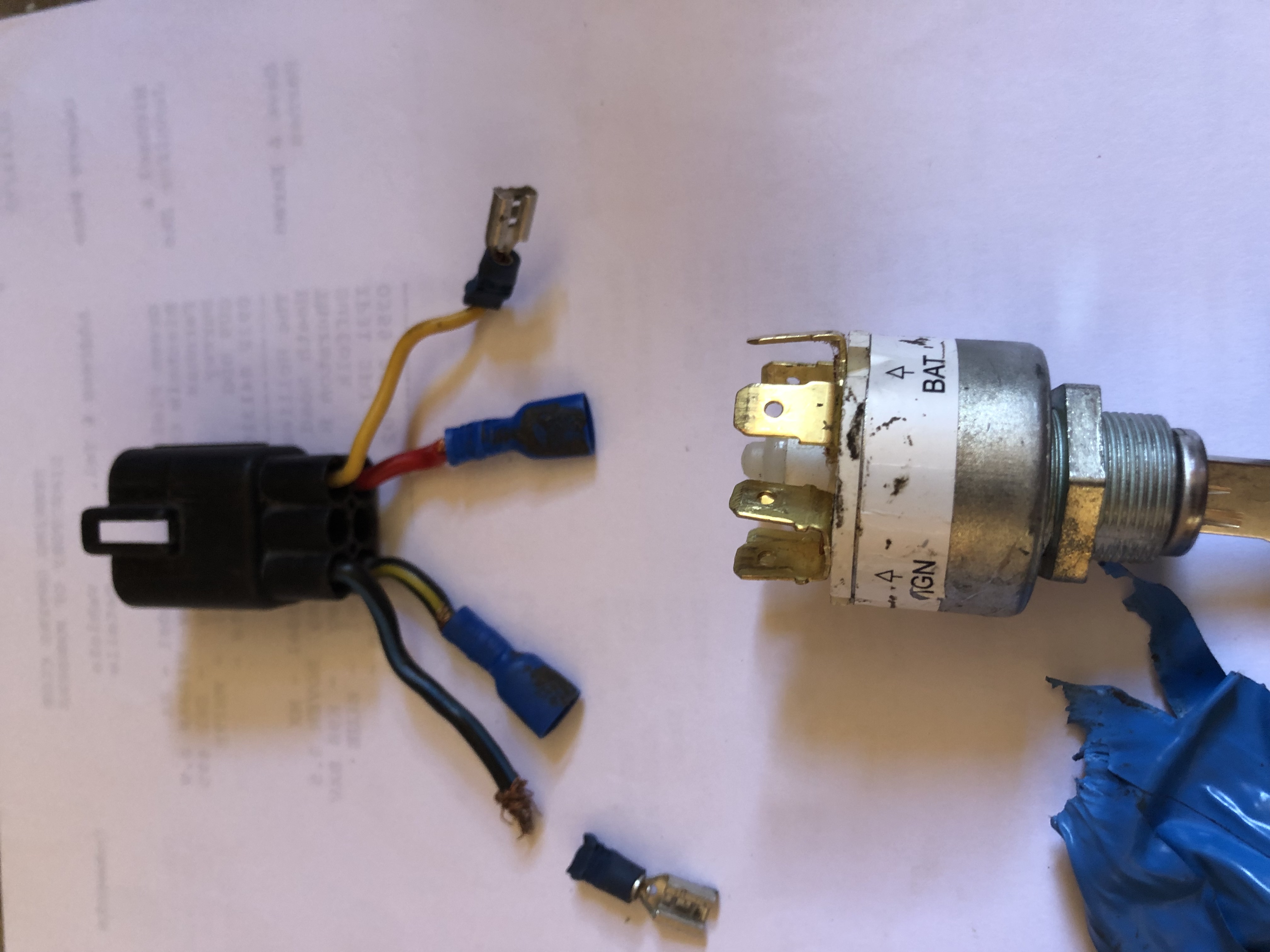

I have a Sebring with a V8 3.5 engine in it.
I'm sure the wiring is from the Rover donor car.
The wires have been pulled from the ignition switch and I am
not entirely sure which ones should go where.
The pic shows the ignition switch and the terminals are arrowed
with: Battery-Ignition- ST and ACC.
The wires colours are: Red-Yellow-Black/White and Black/Blue.
I don't want to guess as I like the car and don't want anything burning out. :oops:
Thank you.
Posts: 5078
Re: V8 3.5 Ignition Switch Wiring.
They are not standard ignition colours!! You are going to have to find out where they go...
One of them will be a permanent feed from the battery which you could find with a test lamp. The other three are probably accessories, ignition, crank engine.
So dab the permanent feed on each one in turn and see what happens.
mart2436
Posts: 2
Joined: Sun Jun 25, 2023 11:19 pm
Post by mart2436 »
Yes I have followed your instructions and it all lights up and cranks over now. Thank you. :D
