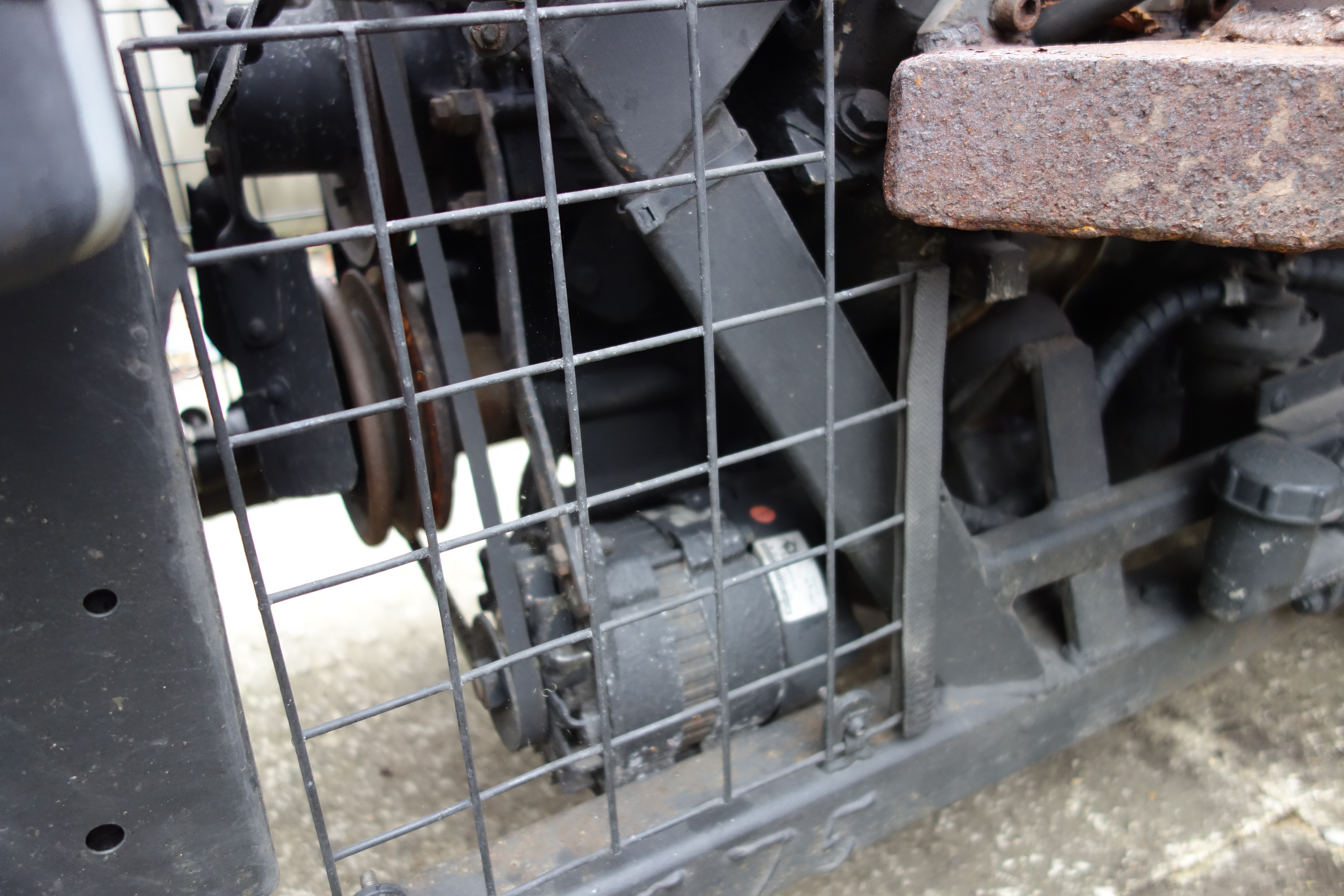

Re: Alternator brackets Rover V8
Post by ratwing »
This is probably too late but here's my fabricated left-hand bracket, unfortunately you can't really see any detail. Not the best belt wrap on the crank pulley but it's worked just fine for the last 22 years.
