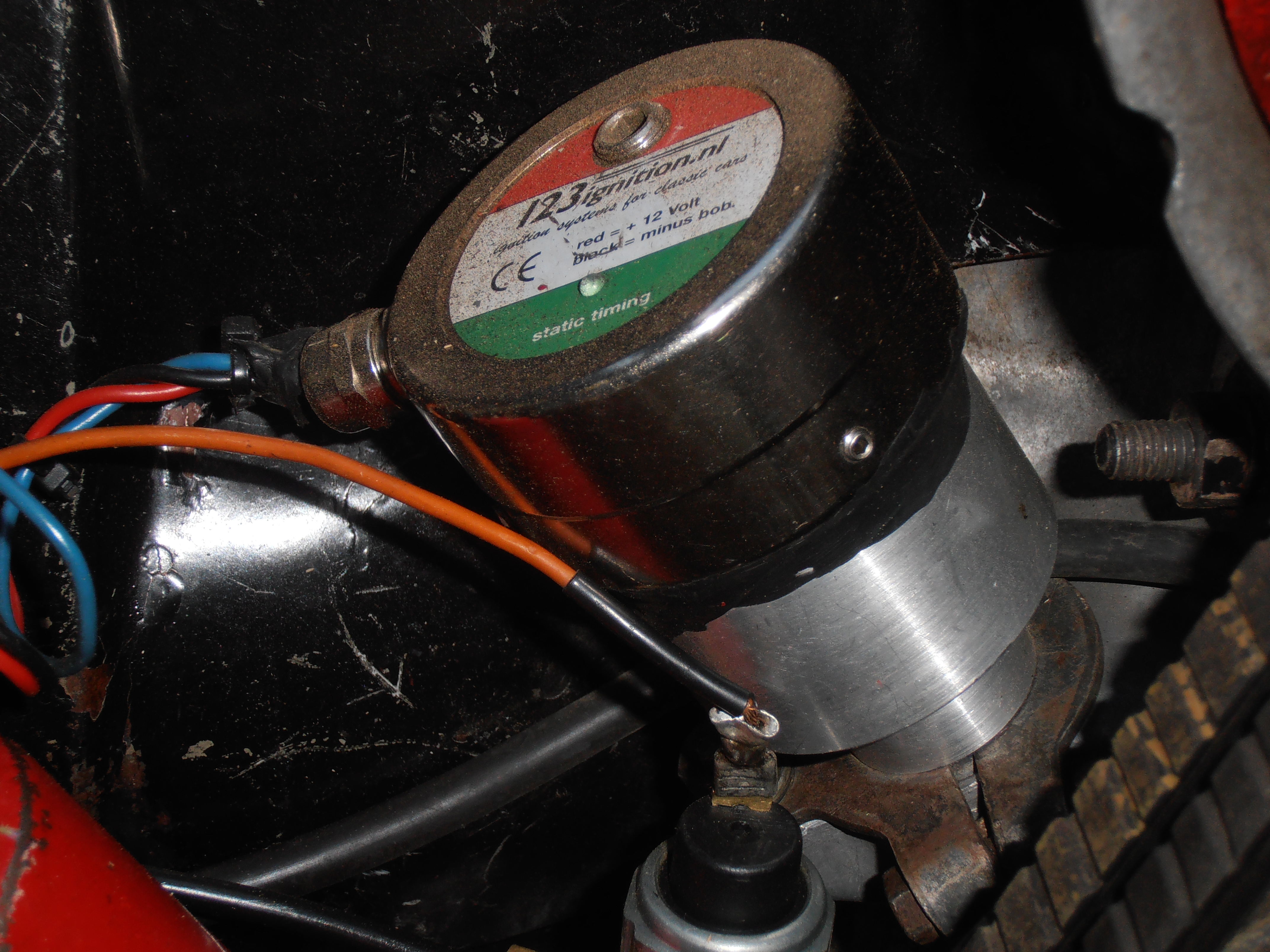

Posts: 541
Location: Australia
Re: Programmable Dizzy
Post by garrycol »
Admittedly not a 123 dizzy for a Rover but my 123 Dizzy does not have a rotor or cap - still has a shaft that rotates to drive the electronics inside - just has wires going from the dizzy to wasted spark coil packs.
But then even with a normal dizzy my car will run with no cap or rotor. :lol:
