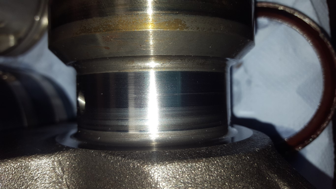

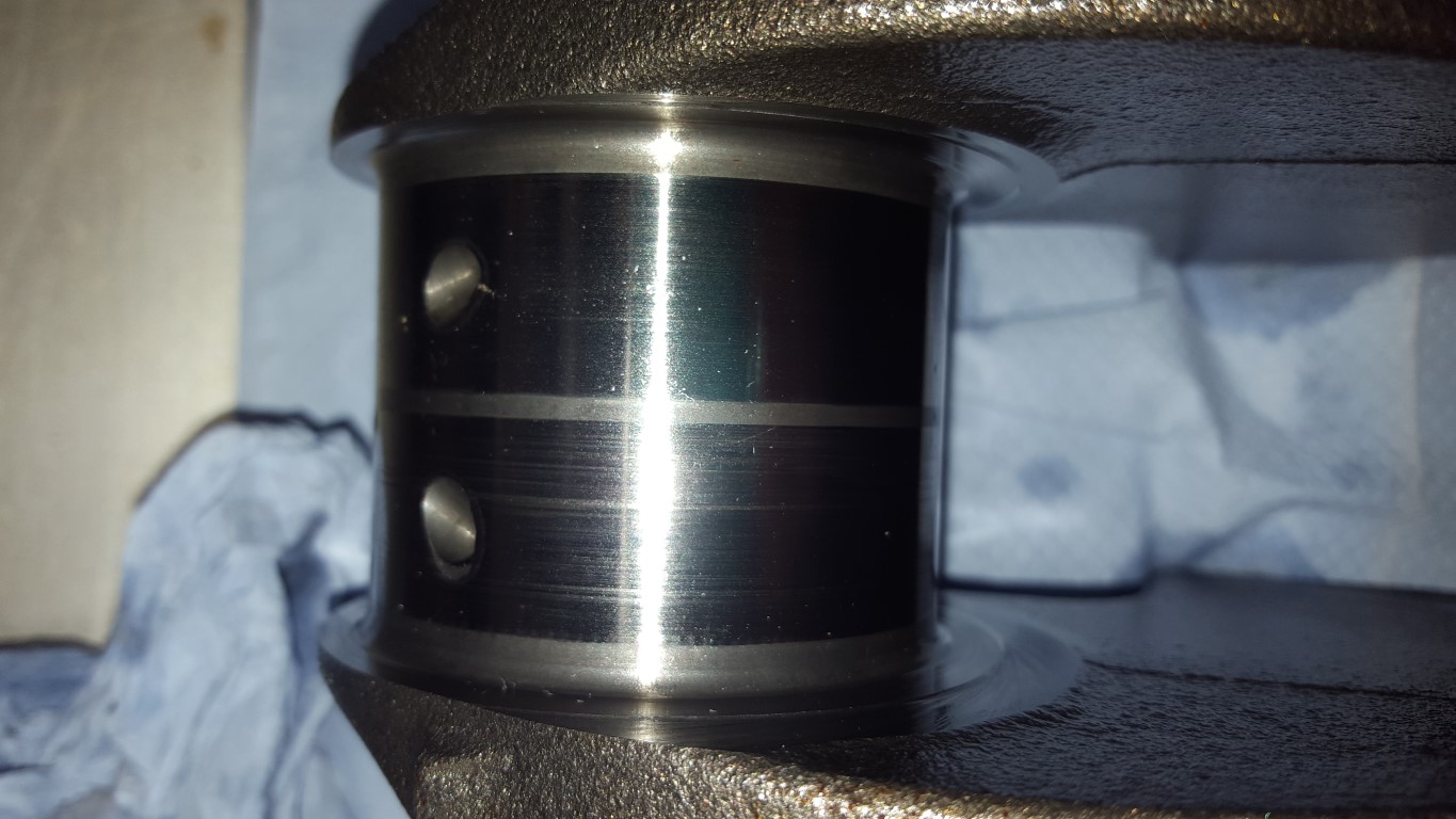

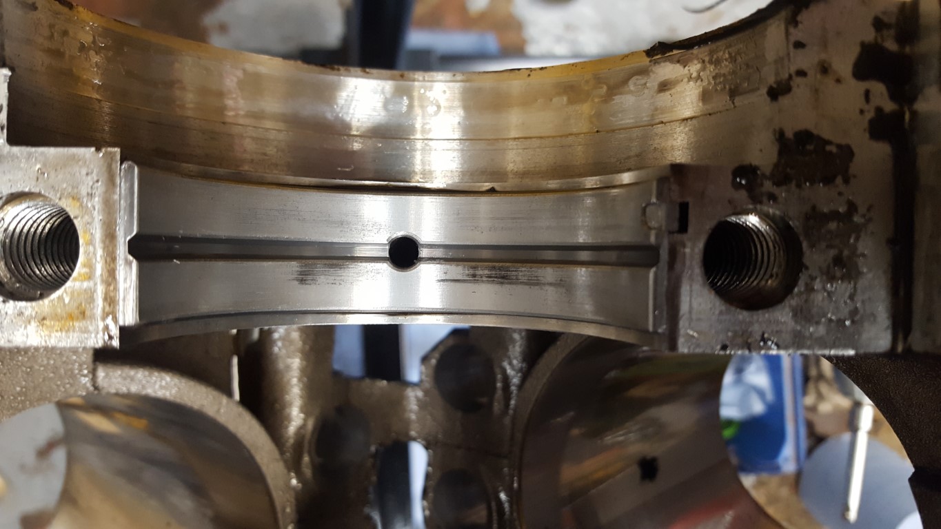

Happen to be looking at mine tonight too! These are the worst. You can see the marking on the shells too.
Might try the bootlace and 400 oxide paper first!
