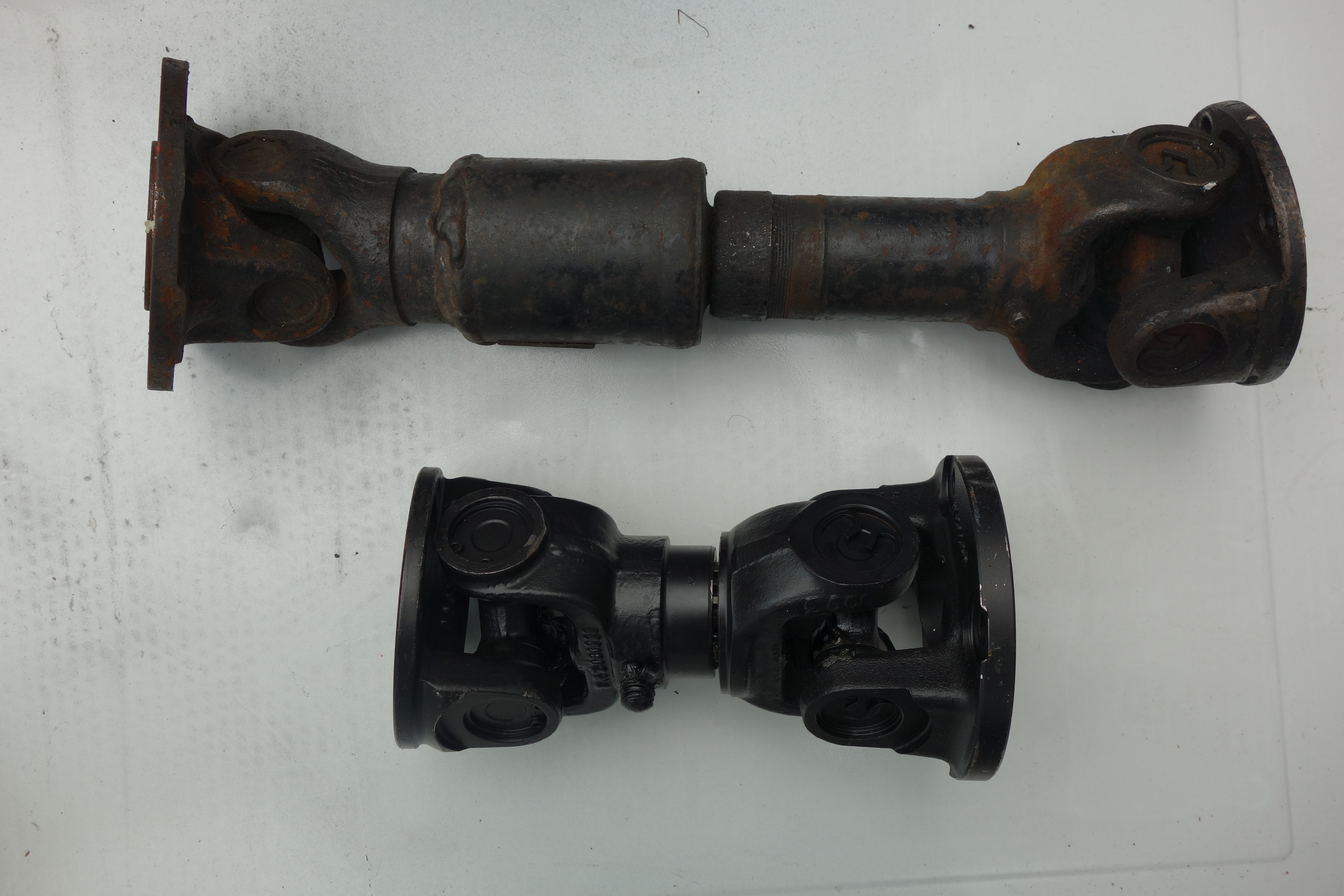

Briefly, I want to replace an LT77 with a ZF4HP22 uprated with HP24 internals but it doesn't leave enough room for a propshaft, not even my short one. My options are an even shorter prop or a combination of flex plate/spacers/torque converter that's short enough that I can get the bellhousing cut'n'shut.
Does anyone know of a company or person that would shorten an aluminium bellhousing, or who might be able to make a really tiny propshaft?
Here's the problem, this is the prop I'm currently using with the LT77, a local company said it's the shortest they could make but it's too long for the modified ZF auto, it needs to be 23mm shorter and able to take the 290lbft of torques from the 4.6 RV8. (ignore the longer prop, the old 4 speed Rover p6 box used that one)

I'd prefer a CV type joint, ideally a tripod style that has some ability to move fore/aft
But that's pretty damn short !

stevieturbo wrote: Mon Sep 27, 2021 6:33 pm I'd prefer a CV type joint, ideally a tripod style that has some ability to move fore/aft
A couple of CV joints sounds ideal, the diff is solidly bolted to the chassis so only need to allow for enough plunge as the engine/gearbox moves on the rubber mounts but which ones?
