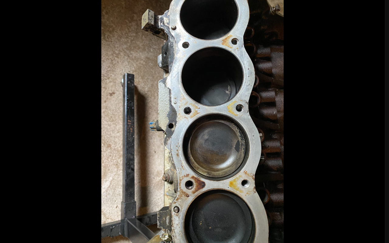

Upon stripping it down I noticed that piston 5 had a relatively clean appearance... Aside from this being the early stage of the piston being 'steam cleaned' from a cracked block, what could all the other possible causes of this be? I've asked on LR4X4, and was told it could be from oil, but would appreciate more views.

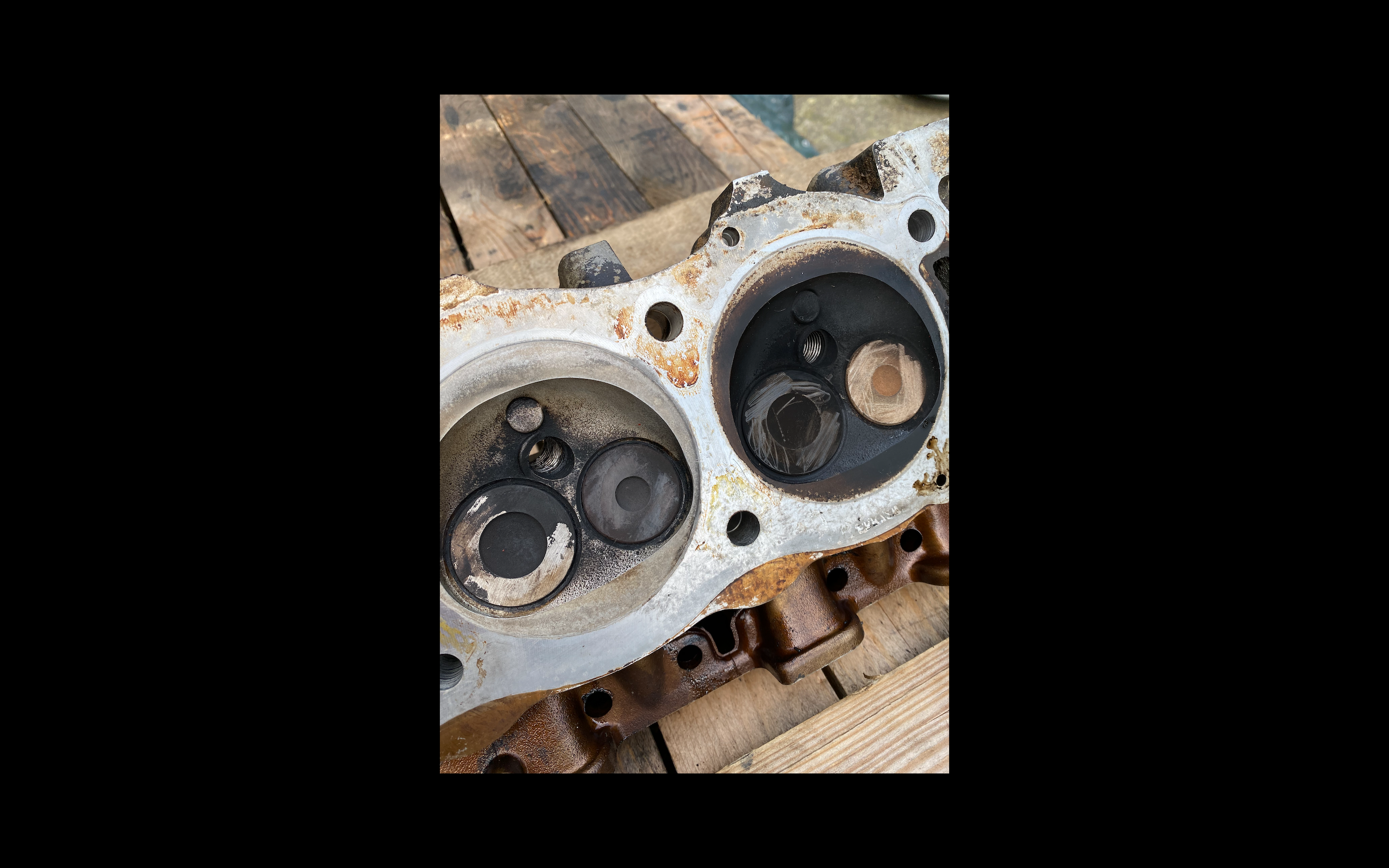

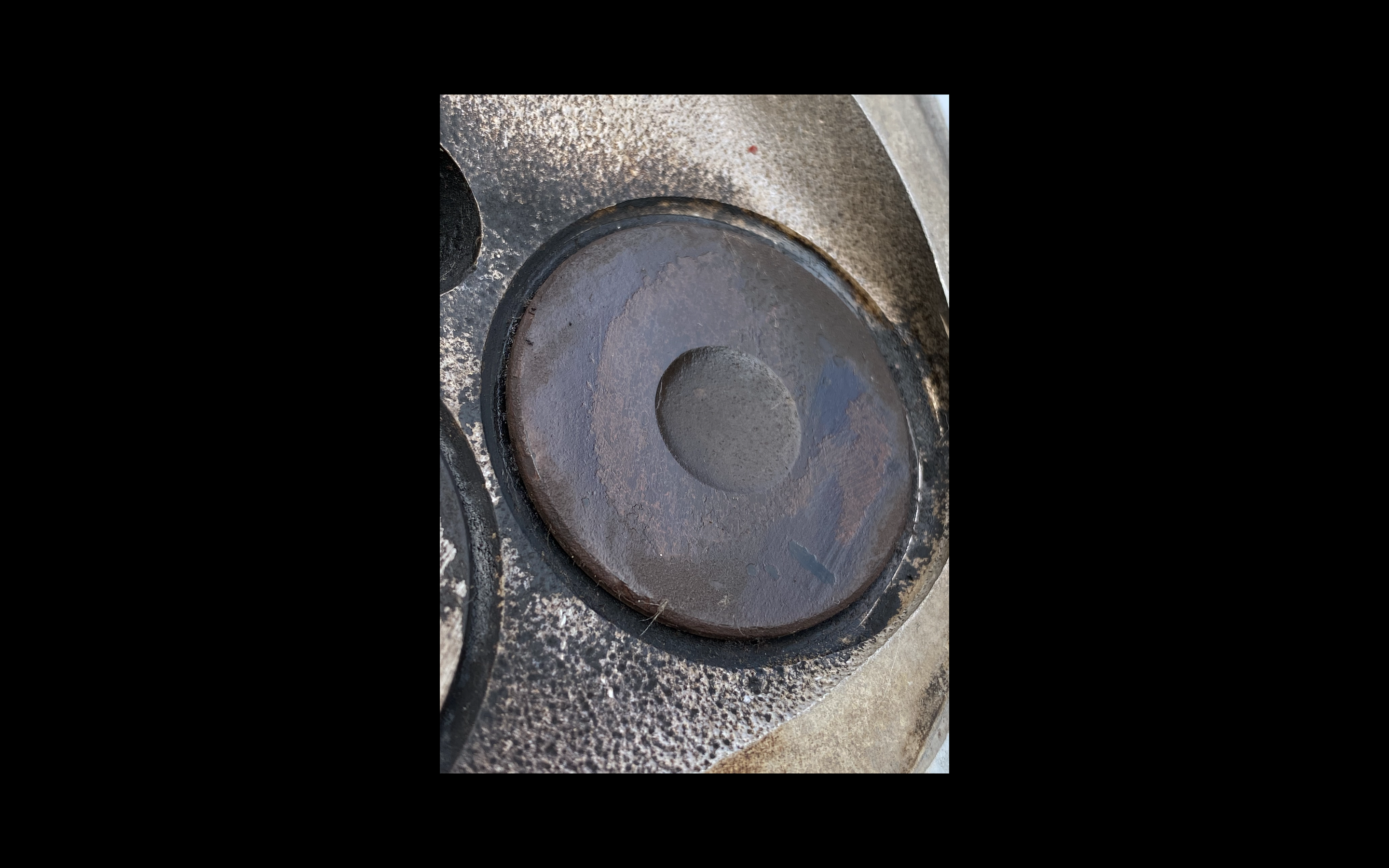

The appearance of the exhaust valve serving cylinder 5 is, as you can see, not the best looking either. All other 15 valve faces look as they should, really. The exhaust port for 5 was wet/oily unlike the others which were the correct 'dry' sort of appearance. Looking at the inlet stem for 5, there was a very small bit of 'rusty' looking blemishing on it but it scraped off easily.
Would the dubious condition of the cylinder 5 valves be linked to and be contributing to the piston's appearance?
Would it be possible for there to be a crack within the head bolt female threads, letting coolant work its way up that way, and across into the combustion chambers via going under the gasket? When I cleaned up piston 7 (using a rag and some diesel), the carbon was very quickly removed, unlike the other 6 pistons which took more effort.

It does look to me like you have water getting into the cylinder.
I have had a cylinder head crack and water escape into plug threads I think (it was a while ago), but it is very very common (apocryphal stats of 50%) for blocks to crack behind the liner.
So I suggest that the odds suggest you do have a cracked block.
Either way, I would get both block and heads pressure tested before putting it all back together!

Normally indicates a slipped liner with the associated issues this can bring - cracks etc.

I doubt it's oil....it is most likely water.
Or being hopeful, lack of spark causing fuel to wash it clean

Almost could have been that Stevie. When removing the leads from the plugs, one of them broke apart at the crimp due to corrosion. After a bit of tracing, unfortunately I'm certain that it was not plug 5.
With the engine in bits it'd be daft not to get it re-linered. It's just that anything somewhat unforeseen which increases the cost of this conversion makes it harder to justify removing the current engine.

I would not randomly get it linered. I would get it properly inspected and tested first.
Both that the block is true and no liners are moved or split etc.

I'd welcome other views on this, but the only issue with the 4.0 / 4.6l cross-bolted block (i.e. one from a P38 or Disco 2) is the cracked block / slipped liner issue. Both are resolved with top hat liners, so a block with top hat liners is basically as good as it gets for the Rover V8.rednaxela wrote: Fri Aug 27, 2021 10:29 pm Surely top hat liners would be the wisest long term bet, but you mean as in not to give this treatment to a block which may be no good?
I suppose I mean that in general terms, you won't find any other issues with that block, so there isn't really any other way that it can be 'no good'.

Back to the piston, for whatever it is worth, from when a crack in the block first allows water into the combustion chamber, how long should it take for the piston to be fully steam cleaned?!

Guess it depends how dirty they were in the first place, and usage.rednaxela wrote: Sat Aug 28, 2021 9:44 pm Back to the piston, for whatever it is worth, from when a crack in the block first allows water into the combustion chamber, how long should it take for the piston to be fully steam cleaned?!
Tracking it over time isn't that easy to do I guess. But water in there definitely cleans things, but I doubt it's in a matter of minutes.
