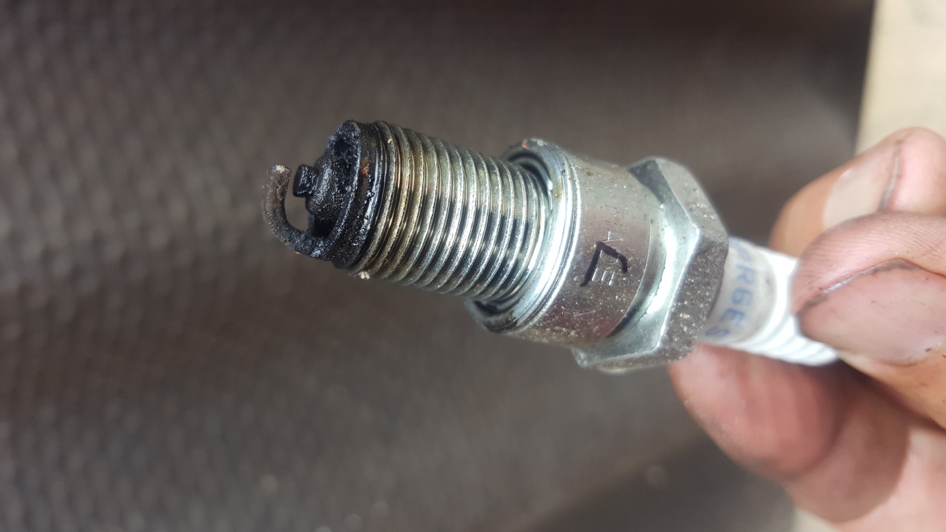

I am also getting an occasional pop from the exhaust on the odd side, but I have yet to put new plugs in or do a compression test.
The plug on 7 was a bit mucky.

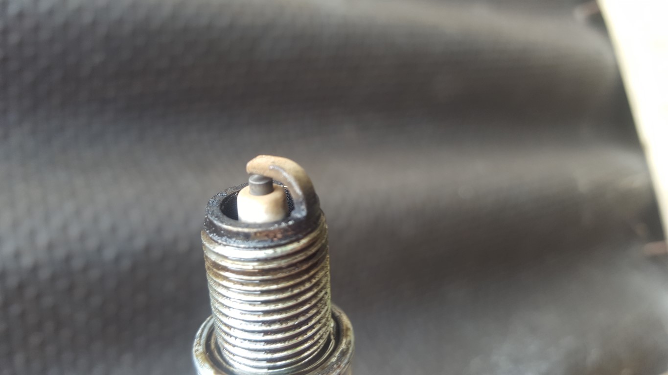

The reset were fairly ok.

Sounds OK to me - yes that plug is a bit wet but the other one looks too lean.
