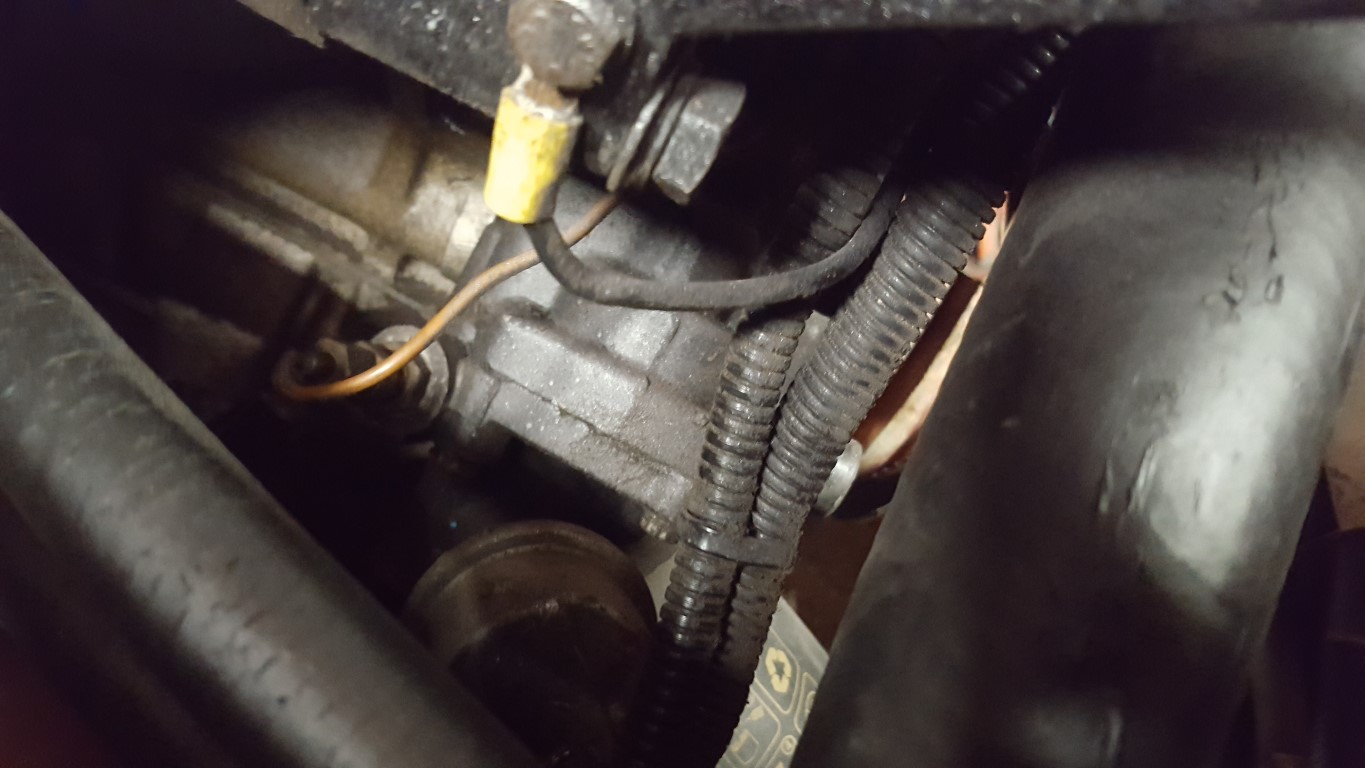

Just noticed my V8 has decided to have no oil pressure... :shock:
No apparent reason. Had it 2 days ago.
So could this be a stuck pressure release valve?
Can I get at that without taking the lump out or taking too much off the motor? I have good access to the front.

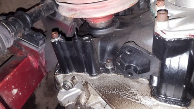

This is what I have:

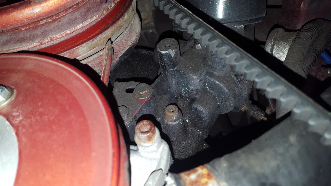

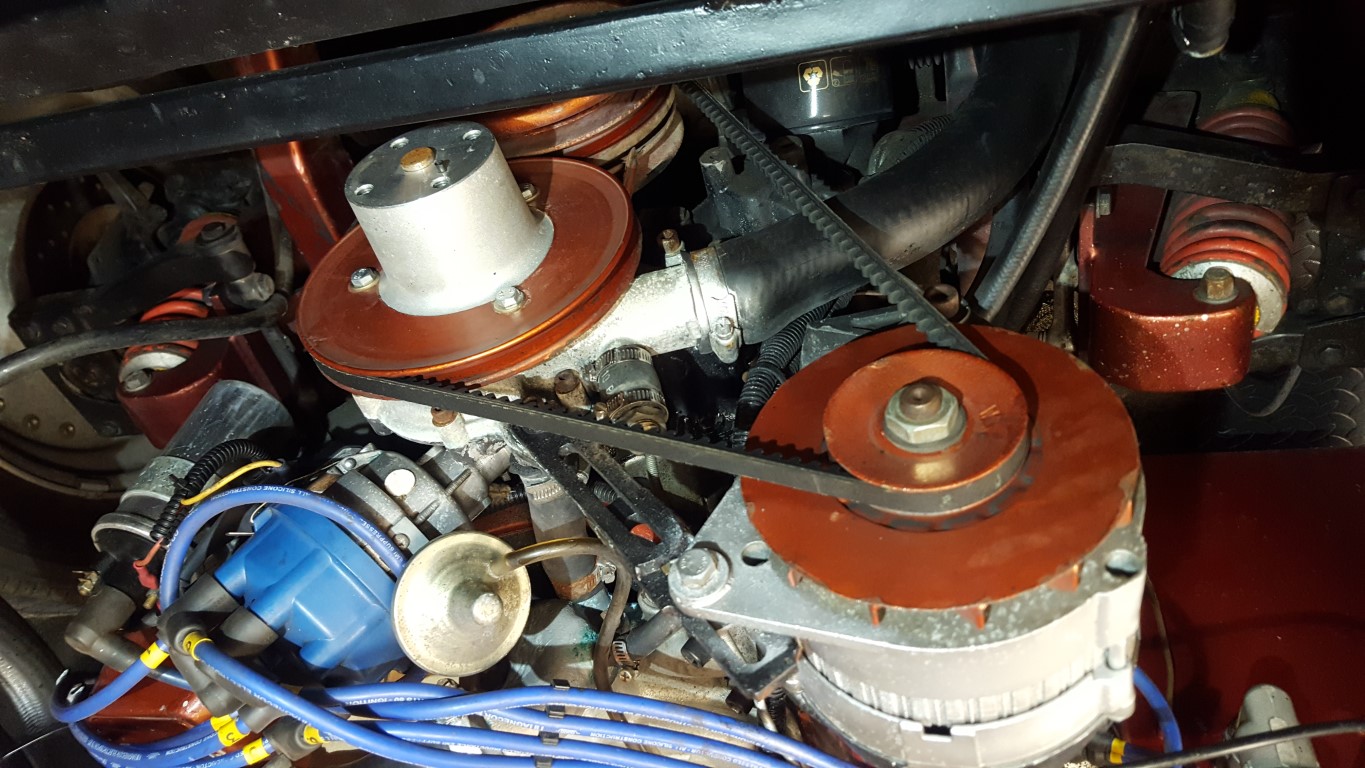

some more pics

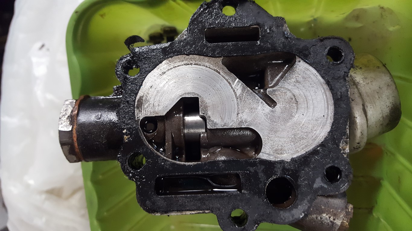

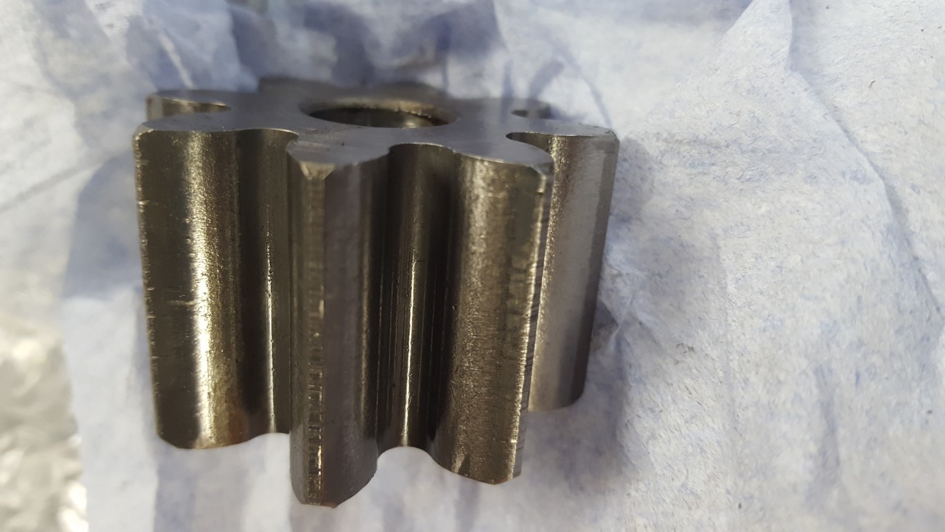

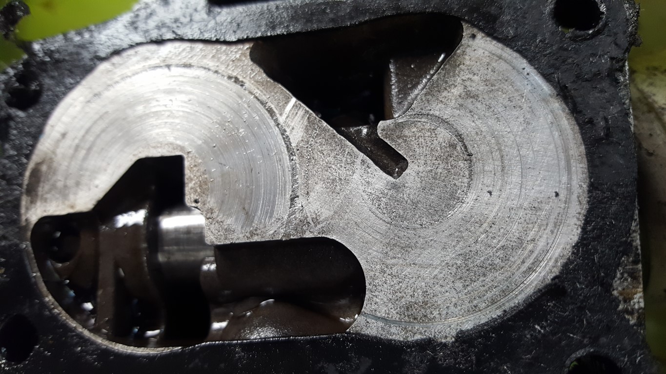

So I dropped the oil, (black and smelly) and took off the oil pump cover.
The surface doesn't look good. :cry:
I don't know if the relief valve piston is in the right place?

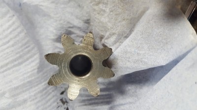

And another pic

rich112 wrote: Sat Jul 10, 2021 6:56 pm So I dropped the oil, (black and smelly) and took off the oil pump cover.
20210710_182901 (Medium).jpg20210710_182908 (Medium).jpg20210710_183000 (Medium).jpg
Undo the big bolt on the left and pull out the spring and plunger, which should be moving freely.
Also verify whatever you are using as a gauge is working correctly. Wear and scoring would be typical and not a reason for "no" oil pressure.
Re: Help! No oil pressure! 4.6 V8
The wearing and scoring marks are normal.
But, do you get oil pressure if you rev it up?

ChrisJC wrote: Sat Jul 10, 2021 9:14 pm The wearing and scoring marks are normal.
No sign of oil pressure. I didn't want to rev the motor past 2k.
The gauge was working fine.
The motor sounds noisy so defo lacking pressure.
I'll check the valve for free movement.
I can easily clean up the cover plate and put in some uprated pump gears and then see how it runs.
