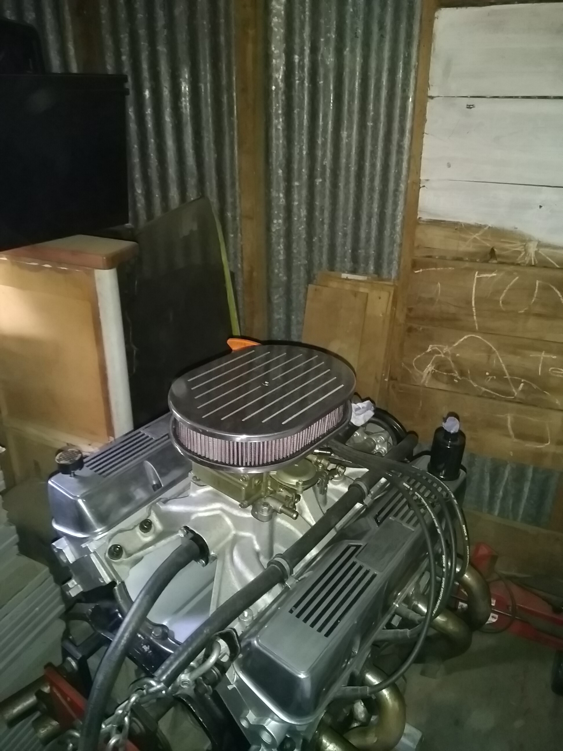

Car is a P6 3.5 with Edelbrock 500 carb, Edelbrock valve covers which allow push in breathers.
It has a crank case vent at the rear of the block.
Currently passenger side valve cover is connected to the carb Vac port via a pcv valve, passenger side is connected to air filter base via the push in filter.
Rear crankcase vent is connected to a small catch tank which has a filter on the top.
Does this setup sound ok?
Just checking a car over before road tuning.

The rear crankcase connection is an air intake, and normally connected to the air filter case, so it gets filtered air at near atmospheric pressure. The rocker cover vents connected to the high vacuum side of the throttles. The idea being to keep the crankcase under a slight vacuum.

On my 3.5, there rear breather is not connected to the inlet system - it just has a filter that is like a fuel filter in it.
Re: Rover V8 Breathing
Thinking back to my first RV8, there was filter in that feed too. But connected to the air filter body, before the air filters.garrycol wrote: Tue Sep 01, 2020 11:36 am On my 3.5, there rear breather is not connected to the inlet system - it just has a filter that is like a fuel filter in it.

What he said.garrycol wrote: Tue Sep 01, 2020 11:36 am On my 3.5, there rear breather is not connected to the inlet system - it just has a filter that is like a fuel filter in it.
An inline fuel filter will suffice.

Thanks for the above guys , helped me out a bit too.
What about the small thing on the rear of the left valve cover, some sort of breather but so small.....can I do away with it and plug the hole .

The engine is modified so who knows.
My take is that there is a pipe on the right hand rocker cover that goes to the inlet manifold or the carb some where - this is the sucker that takes internal engine fumes into the intake - but this system needs and inlet to let air into the internal engine - I think that filter is where air goes into the engine/crankcase and with engine fumes is sucked out the hole in the right hand rocker covers.
On the original twin carb engine, both carbs have suckers that are piped to take fumes from each rocker and air gets in at the back of the engine through a fuel filter type filter - the subject of discussion above.

Sounds like you have an EFI rocker cover on a carb block. That tiny hole is the air intake on EFI engines. They have only one breather, from the other rocker cover, at the front. A flame trap fits into a hole same as the oil filler.Mc Tool wrote: Sat Sep 05, 2020 3:38 am Thanks for the above guys , helped me out a bit too.

Old storey Dave , spent ages sanding and polishing early 3.5 round rocker covers and as soon as I finished I saw some efi square covers.....had to have them . I do have the flame trap on other cover, probly put an efi manifold ect on it as I want to sell it to finance a 3.9 serp motor build...heaps to polish on that too

Same setup as my 3.9 in a Tvr.Mc Tool wrote: Sat Sep 05, 2020 3:38 am Thanks for the above guys , helped me out a bit too.
Left hand rocker as you look at photo is the breather for air in and the other side is piped to plenum for extraction.
Not sure blocking it is the way forward.

Well not all EFIs - 3.5s and 3.9s I think. Other EFIs such as Thor do not have this and have a 3.5 carb arrangement with their rocker covers with a large pipe in each Rocker. The left rocker pipe goes to the throttle body and the right rocker pipe goes to the inlet manifold cross over pipe.DaveEFI wrote: Sat Sep 05, 2020 9:40 am Sounds like you have an EFI rocker cover on a carb block. That tiny hole is the air intake on EFI engines. They have only one breather, from the other rocker cover, at the front. A flame trap fits into a hole same as the oil filler.
