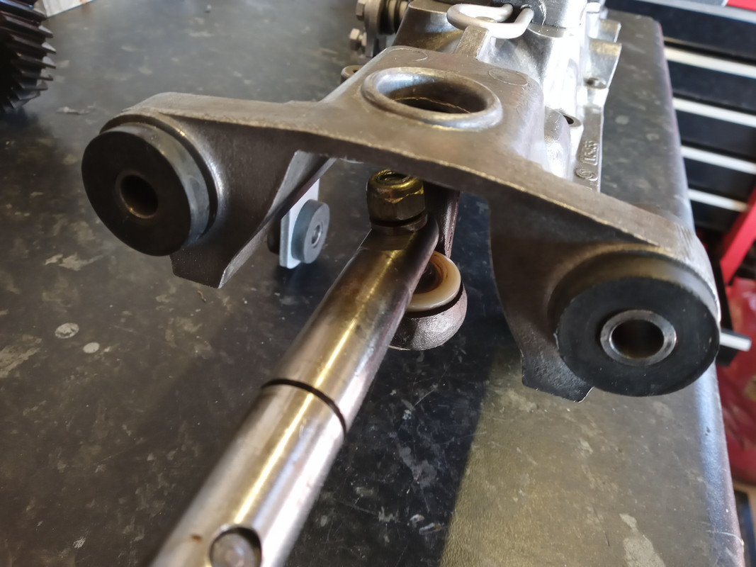

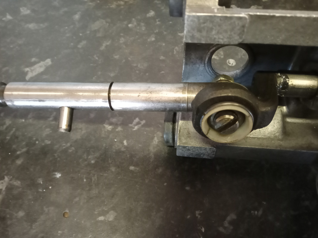

The remote rod is bolted on. There's a pin with a slotted head that passes up through the ball end on the remote rod on the box and goes through the selector rod on the box. It's retained with a nut on the top which is accessed through the round hole cast in the remote housing.
You shouldn't need to but I don't recommend prising the ends of the bias spring sideways off the lever as it risks distorting or snapping the spring. Much better to remove the rear saddle clamp if you can get to it.
Here's some pictures of the attachment
