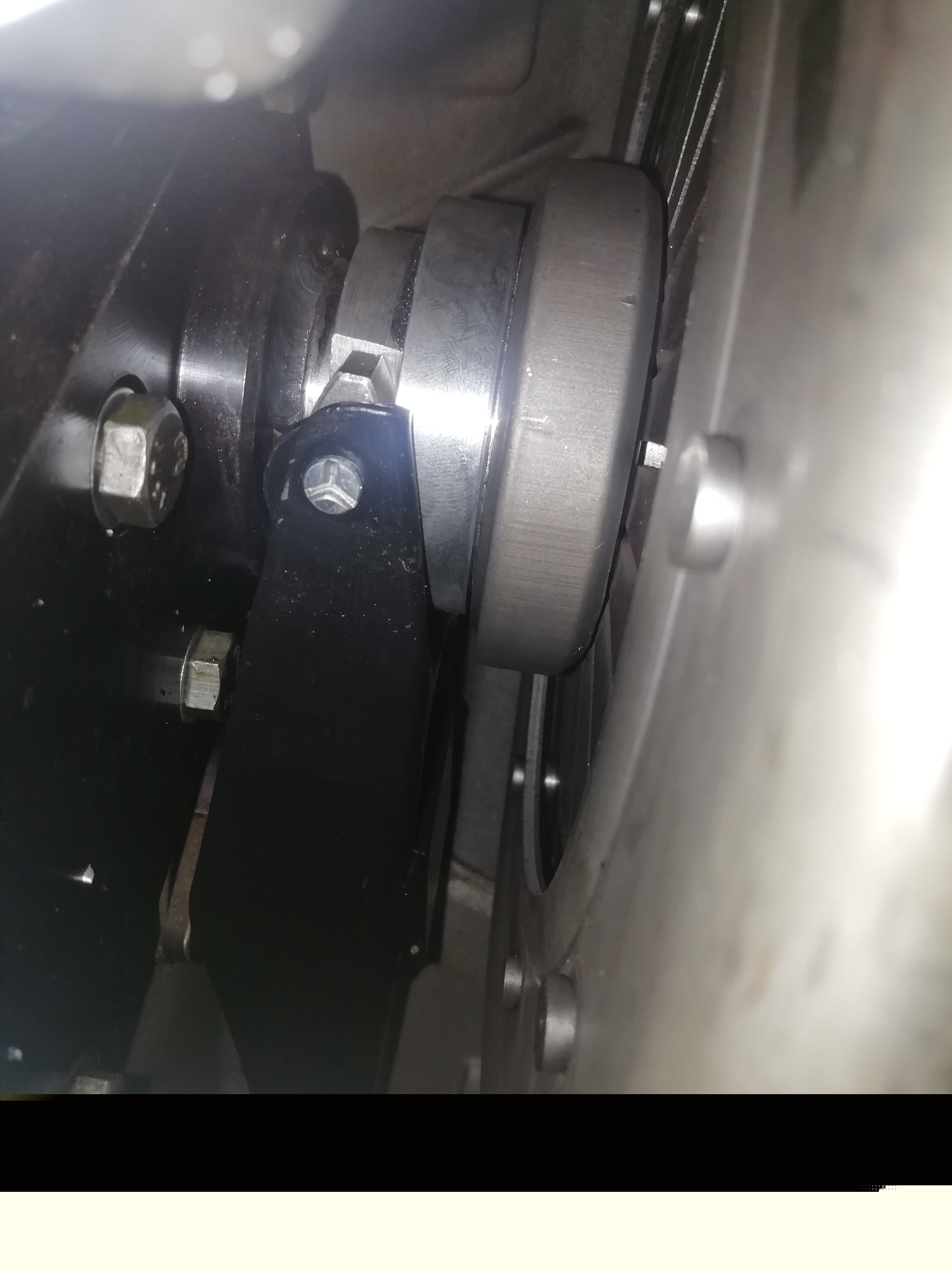

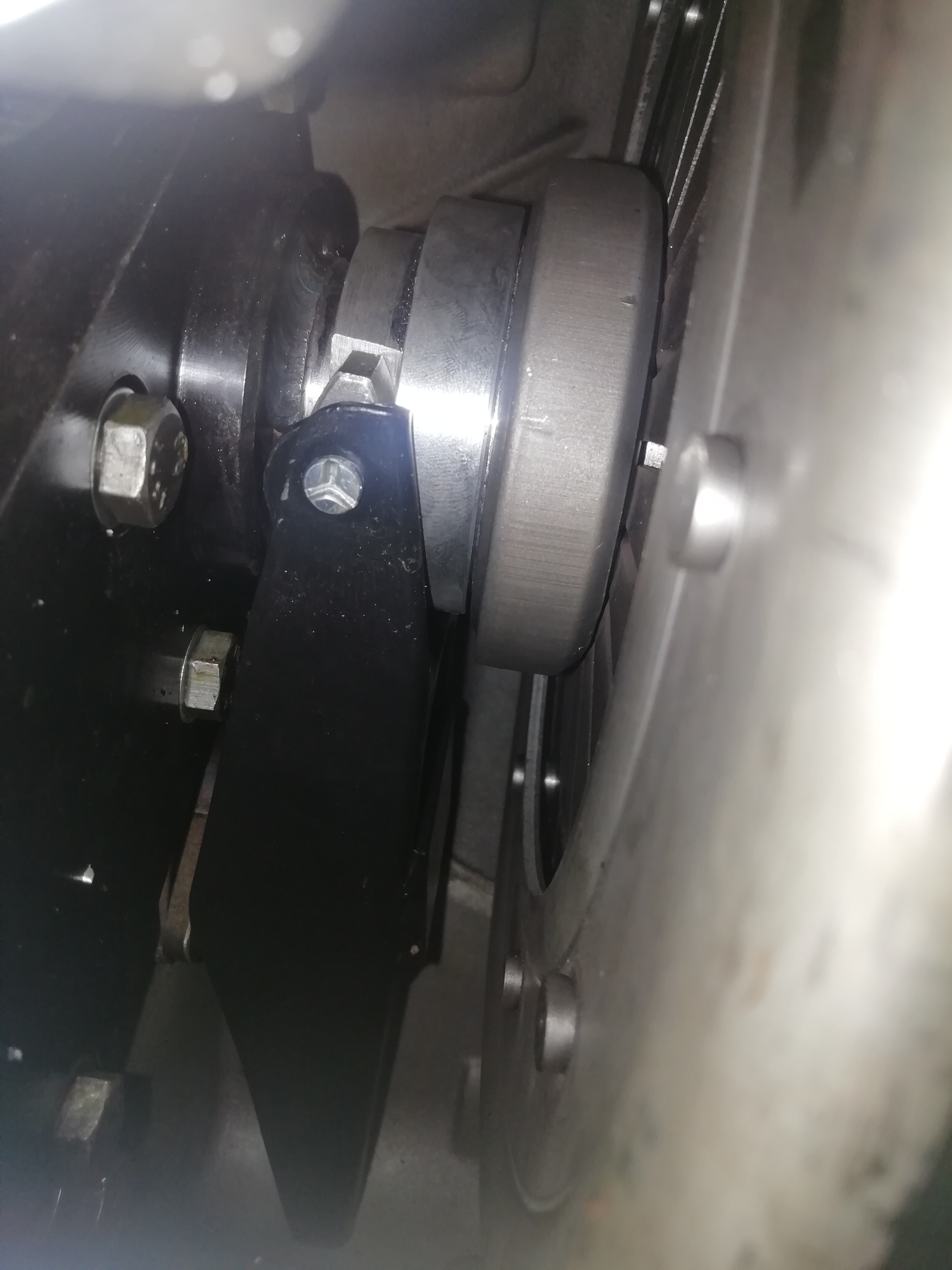

I did indeed drill a hole in the bellhousing. Problem obvious!
The release bearing is being pushed by the front face of the gearbox, so it can't release any more!
I guess my combination of a Stumpy 4-cyl bellhousing + adaptor is just a fraction too short.
I will remove the gearbox and do a bit of 'fettling'...

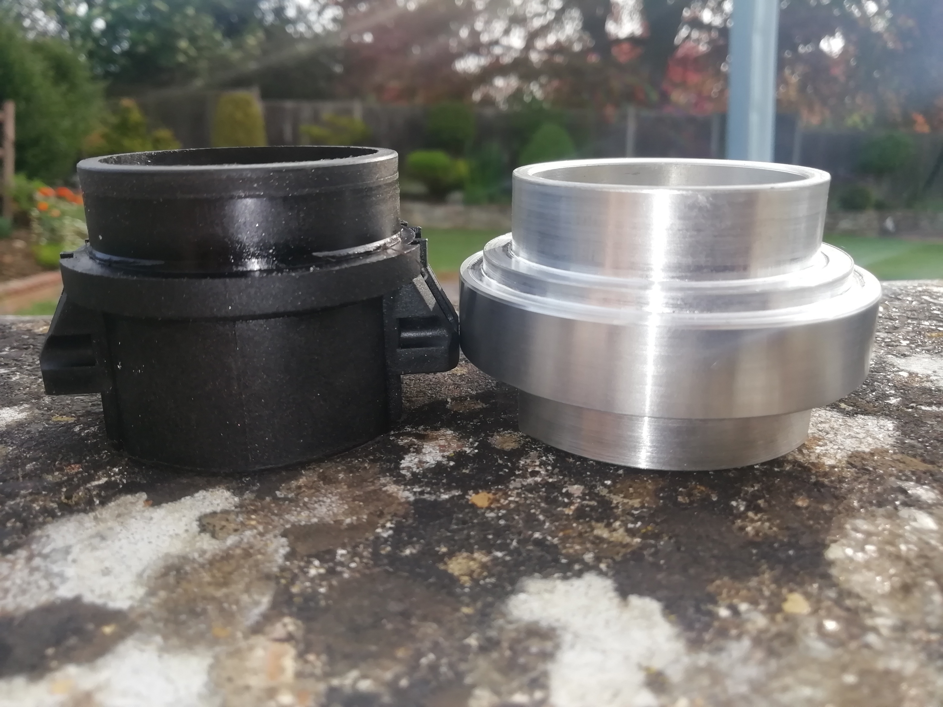

This is the one I machined up to replace the plastic one.
Since then, I discovered that the release bearing supplied with the Stumpy Bellhousing is correct.
