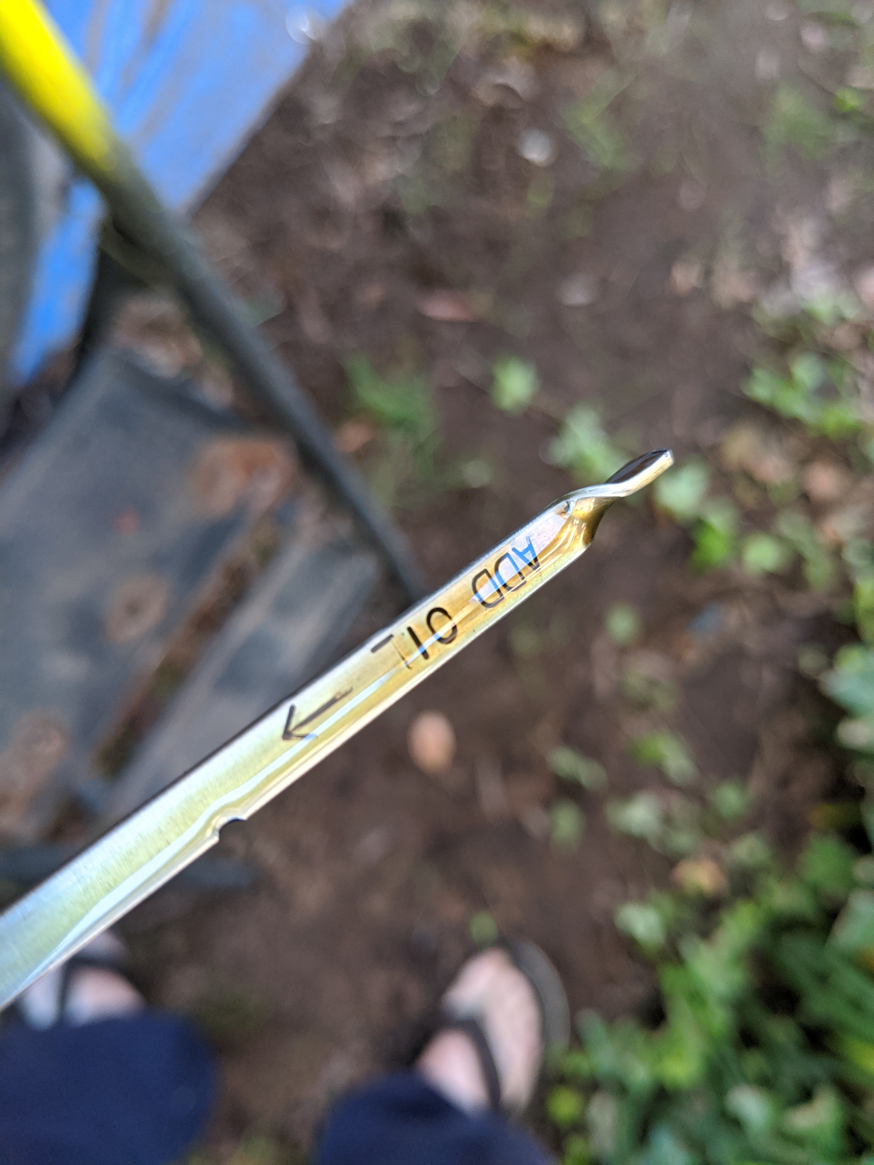

Oil is nice and clear, coolant does not have any bubbles or oil.

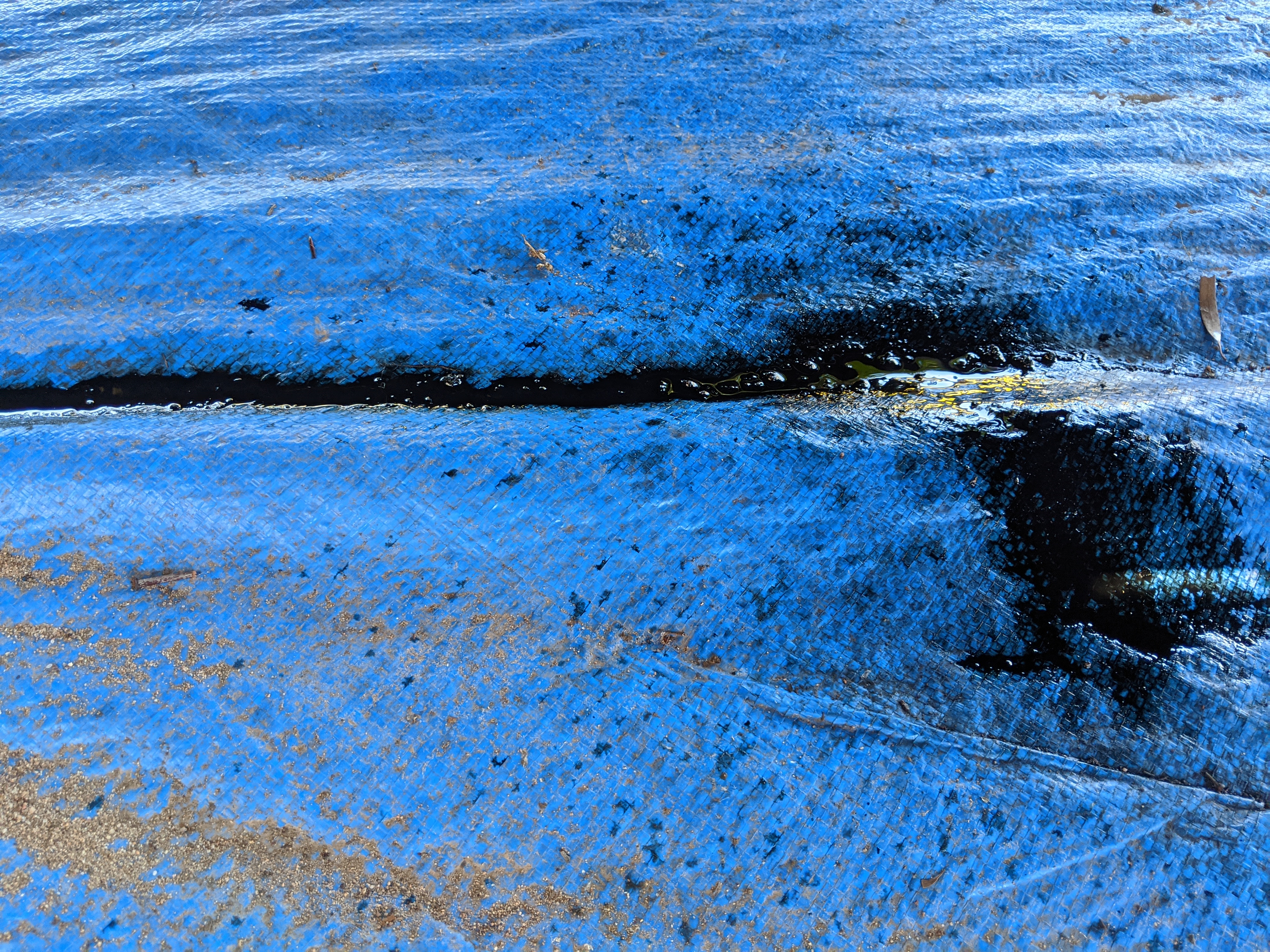

Heavy thick black oil is coming out from exhaust pipe joints on both banks of the engine.
My thoughts are that with the engine getting hot – there is at a minimum a ring issue – clearly oil is being burned. When I have had similar symptoms in other engines in the past, broken/melted rings have been the cause.
